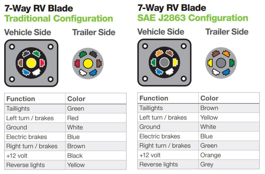

I need to rewire my live stock trailer, a pretty simple task. I was looking at the pre-molded, 7 wire pigtails on E-trailer, Southwestwheel, Amazon etc. What's up with the wire color change for turn signals, brakes, etc?
For my entire life, yellow/green was turn signals, brown for aux, blue for brakes....... and all these per-molded tails have the wire colors switched around. Are these just cheap China products where standards don't exists?
Here!
I've seen that Sno. All I wanted was the pre-molded 7 blade plug cord, but all I can find is what I deem as un-standard wiring colors from what I grew up with. What's labeled as "traditional" in the above pic is how I was always taught to wire.
