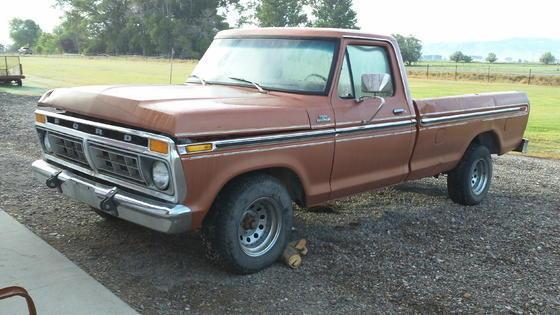

Morning all,
we have a project truck.
It appears to be stock. The engine needs to breathe! I'm not sure what I can take off and what needs to remain. No smog testing here. This is the "Fun" truck anyway.
Please post ideas here and I'll get up some pics to fuel the fire!

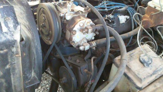

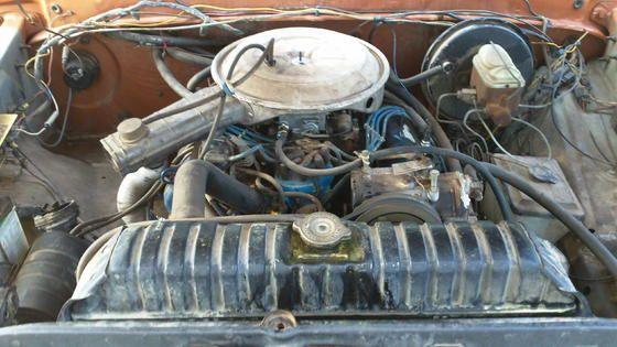

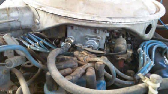

BOY! that brings back memories. Is there a thermactor (AIR) pump on the other side of the engine? I don't think there's much in emissions on that puppy anyways. One thing that scares me just in the pix- the fuel line running over the distributor and wires... . :eek:
I will need to fix that fuel line; wasn't even noticing the distributor since my diesel doesn't have one :)
I looked for a pump on the other side, is it belt driven? I didn't see anything belt driven.
