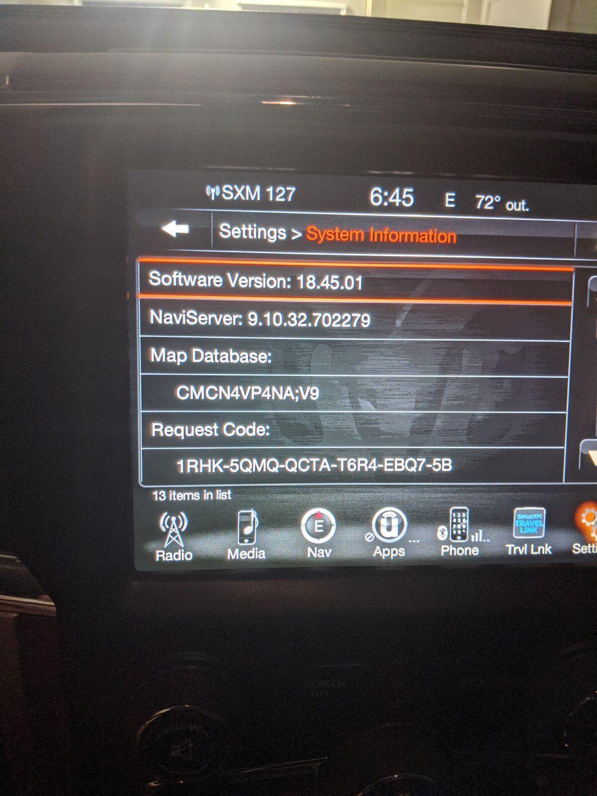

I'd bet your update didn't happen.....The OTA update failed on my truck twice so I did it manually. Look under "system information" and see if it has the new software version #18-45-01

The OTA update apparently failed. I have version 17.11.17. How do I force it manually?

I started a download of the update and left it running at the house while we went out for errands and dinner. When we came out of the restaurant, the time (which I had set manually) was wrong. I went into the setup and clicked on sync to GPS and the time became correct. I guess it healed itself. When we got back to the house and I shut the truck off I got the update pending message again. I told it to update now so we'll see what happens.
Not it didn't heal itself, it needed the OTA.

I updated manually to 17-43 back in Sept. It keep failing to do 18.45 OTA, so I just manually did it this evening. BTW way, I have done the last two with the push button in "run" without the motor running as they state you should do. Snoking
