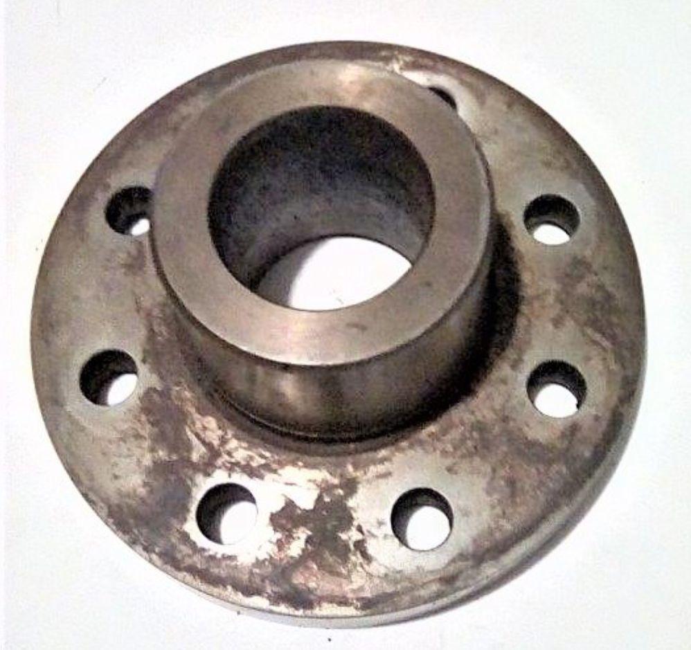

Guys, I have never seen this before. There is a spacer?collar on the end of the crankshaft bigger than where the rear main seal goes and I dont know how to get it off? Cant find this on cummins fast serve I dont know what to do. ITs all apart in my driveway. IT is not a dodge. It is a 1991 oshkosh mt18fd tool truck. It may be an 5.9 industrial engine? Help?

That engine came from Cummins with a flex plate on the crank. Are you saying there's something else on it? Can you post a pic?
Sorry, man. Sometimes my QuickServe doesn’t update to the new ESN I enter. Unknowingly, I was still looking at one of our ‘08 buses when I saw the flex plate.

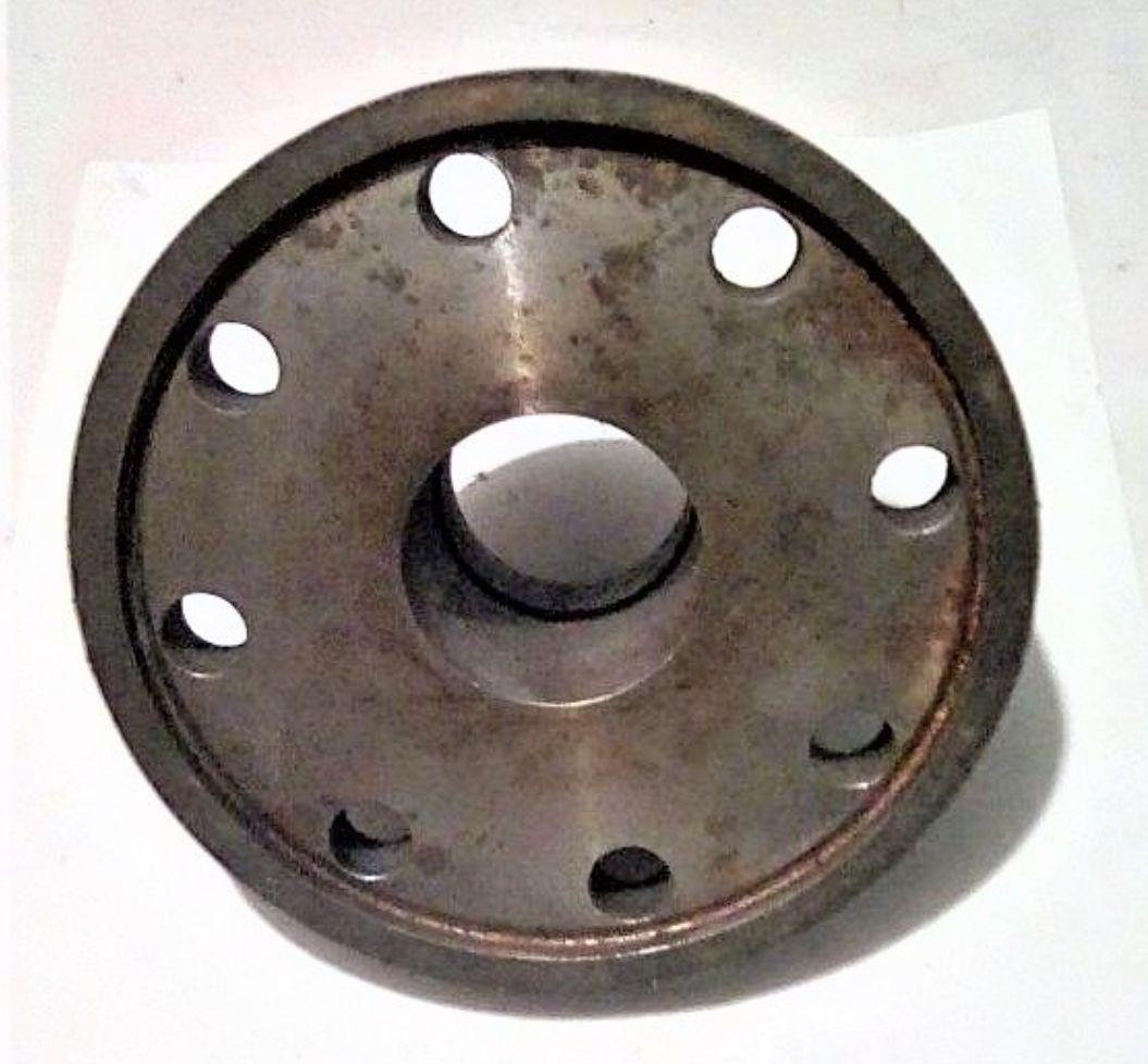

So, this is what you have, huh? From the looks of these pics I’d say it would be very easy for that thing to rust to the crank if not properly prepared with some anti-seize when installed.
View attachment 117028 View attachment 117029
yes sir. I got it off, went to harbor freigt bought an eight inch gear puller. Pretty much came right off. I was prepared with heat and long 1.2 drive gear wrench ratchet with comfort grip handle. My cordless impact driver took it right off. I cleaned it up with, and 3 in oned it and changed rear mail seal. I need the new part number for a front seal allisone at545 all I came up with is 8641826 ?

Glad you got it off. Make sure to put some anti-seize on it.
