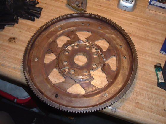

92 flywheel / flexplate please help
Edge EZ NIB
#@$%!wanted 89-93 flywheel/flexplate for 92 automatic
here are pic's of what i need... ... thanks:{
A flexplate for a 1994 and newer will work and is stronger. The newer ones are shot peened for strength, though they are dimensionally very close in thickness, the process of shot peening greatly enhances their strength. These should be available at any auto parts outlet.
