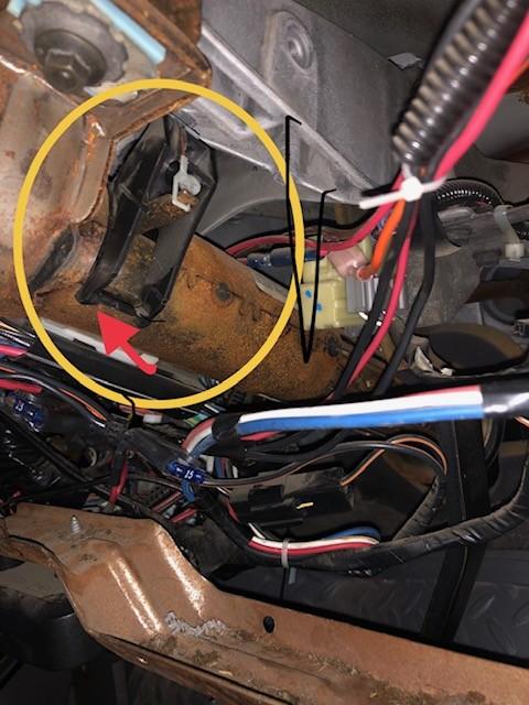

Rather than removing the bezel around dash behind the steering wheel first, I removed the knee panel below the steering column to reveal the tab where the opposite end of selector cable attaches to find a plastic guide bracket that has been torqued and piece of it broken. Not sure just yet if I can JB Weld the broken plastic guide and reuse it.

You can try jb weld it might hold. Not sure what happens to your broken (?) black part when you move the gear selector? Wondering more what happens if you hold it in place and move gear selector. Does the gear indicator move correctly? You should be able to track the piece down in a local u-pull-it yard. Go to yard first so you learn how to not break it taking it out. Good luck.
