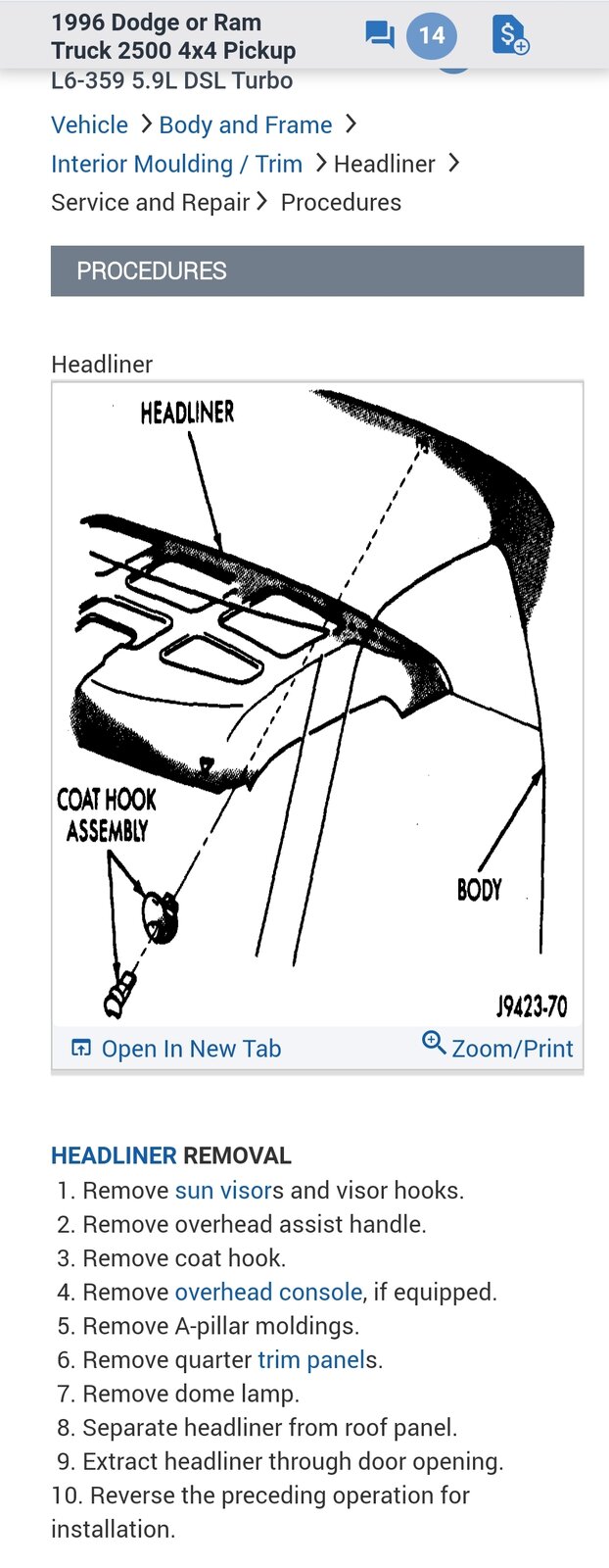

Here is what I have on the actual headliner removal.
That pretty much sums it up. It’s a regular cab, right? Once you get it out, pull the old material off and use a rag to rub the foam off. I just redid mine in the Accord. Our upholstery guy turned me on to this stuff. Don’t be stingy with it. Spray the material and the headliner. Make sure to wrap over the edges about an inch to an inch and a half.

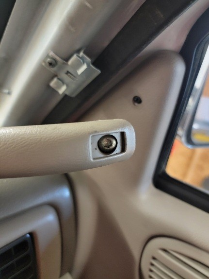

I think they glued in the drivers side A pillar plastic, but I did not really need to pop that off.
The passenger side grab handle is a T25
The rest are all Phillips.
There were 2 push in deals across the back I used the normal panel tools to remove them.

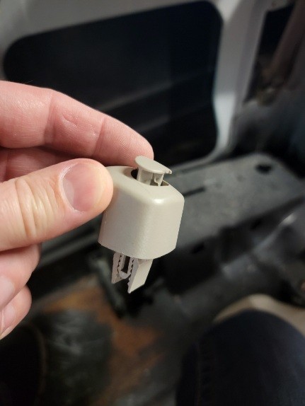

The driver coat hook would not come out, the passenger came right out of course I broke it, maybe there is a trick to that.

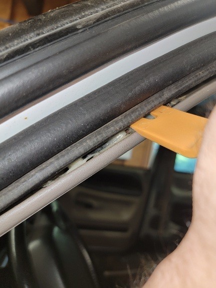

Here is the passenger side which I took out first, you just gently pry back the small gap and it should release the part. Maybe try to use a panel tool or push in the headliner a bit to expose the part possibly, hard to say what went wrong with the drivers side.

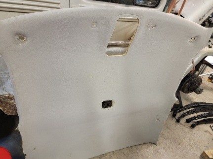

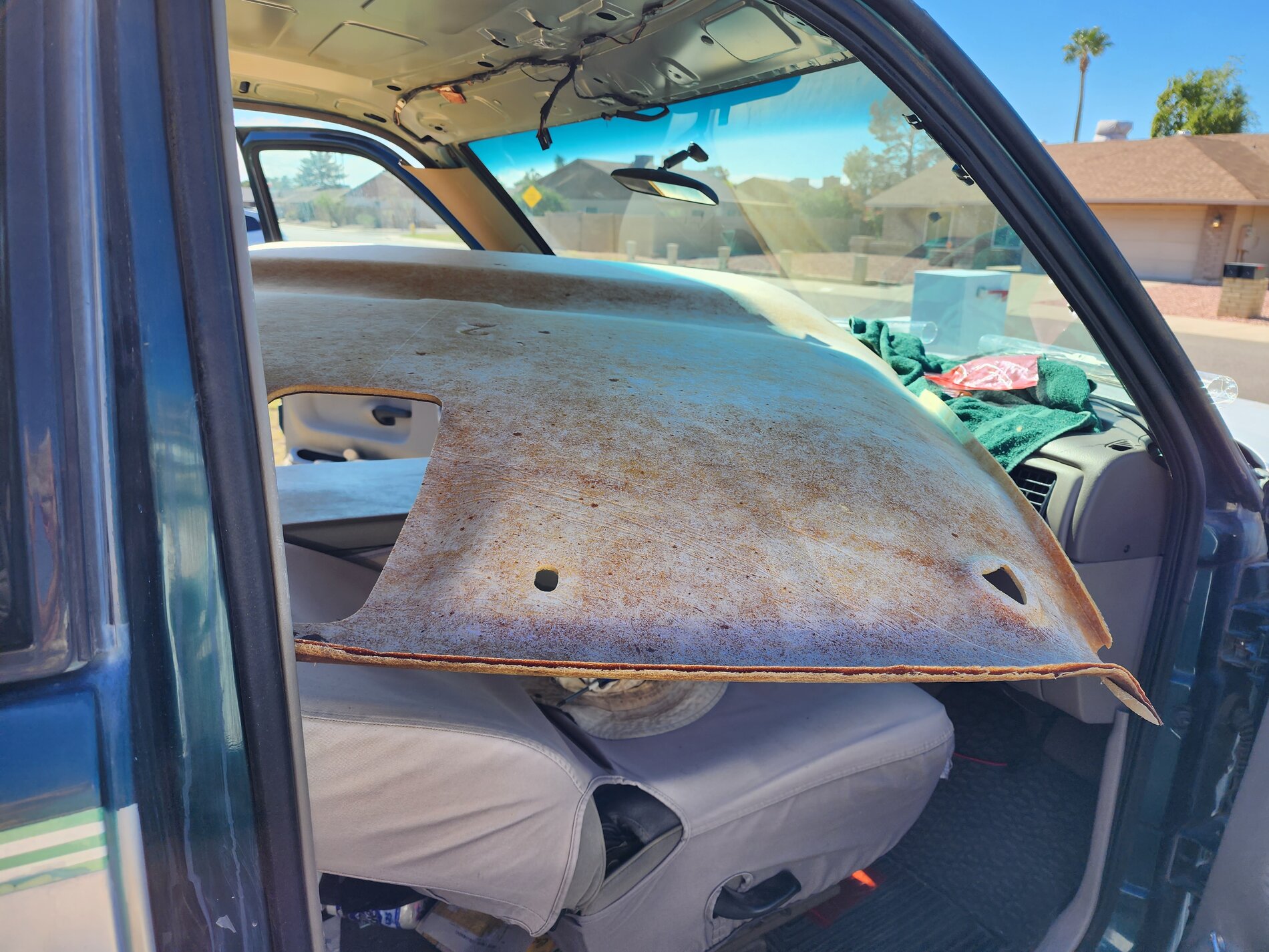

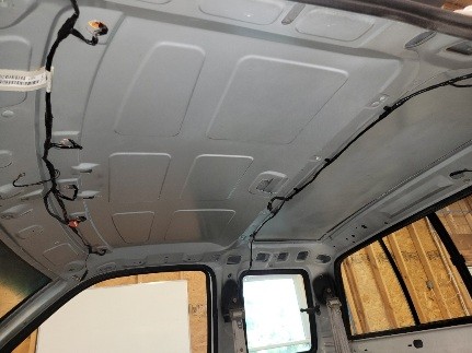

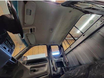

The headliner then came down fairly easily after taking the dome light, console, and visors off.
Getting it physically out was not bad, not having a 3rd Door kind makes it tough. I hope I can figure out the right angle on the install.
I turned it so the front was facing the drivers door. Then released the steering wheel tilt all the way up, and it came out with the passenger side below the wheel, and the drivers side in the upper right corner of the door opening.

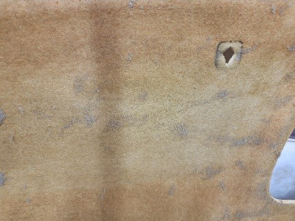

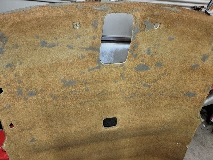

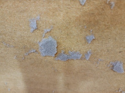

As BigPappa mentioned once you remove the headliner from the base you want to remove the left over. I would guess 97% of it came off no issue.
My backer was de-laminated a bit so make sure your not separating the backer part just the light stuff from the hard part.
Overall a stainless steel wire brush seemed to work pretty well to remove the left over.

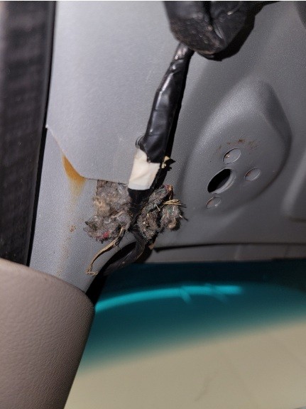

Of course these damn mice are horrible they made their way into the cab above the headliner.

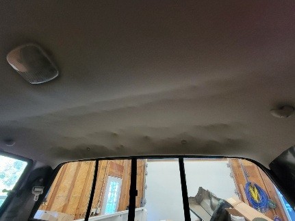

This headliner was rough since I bought it.

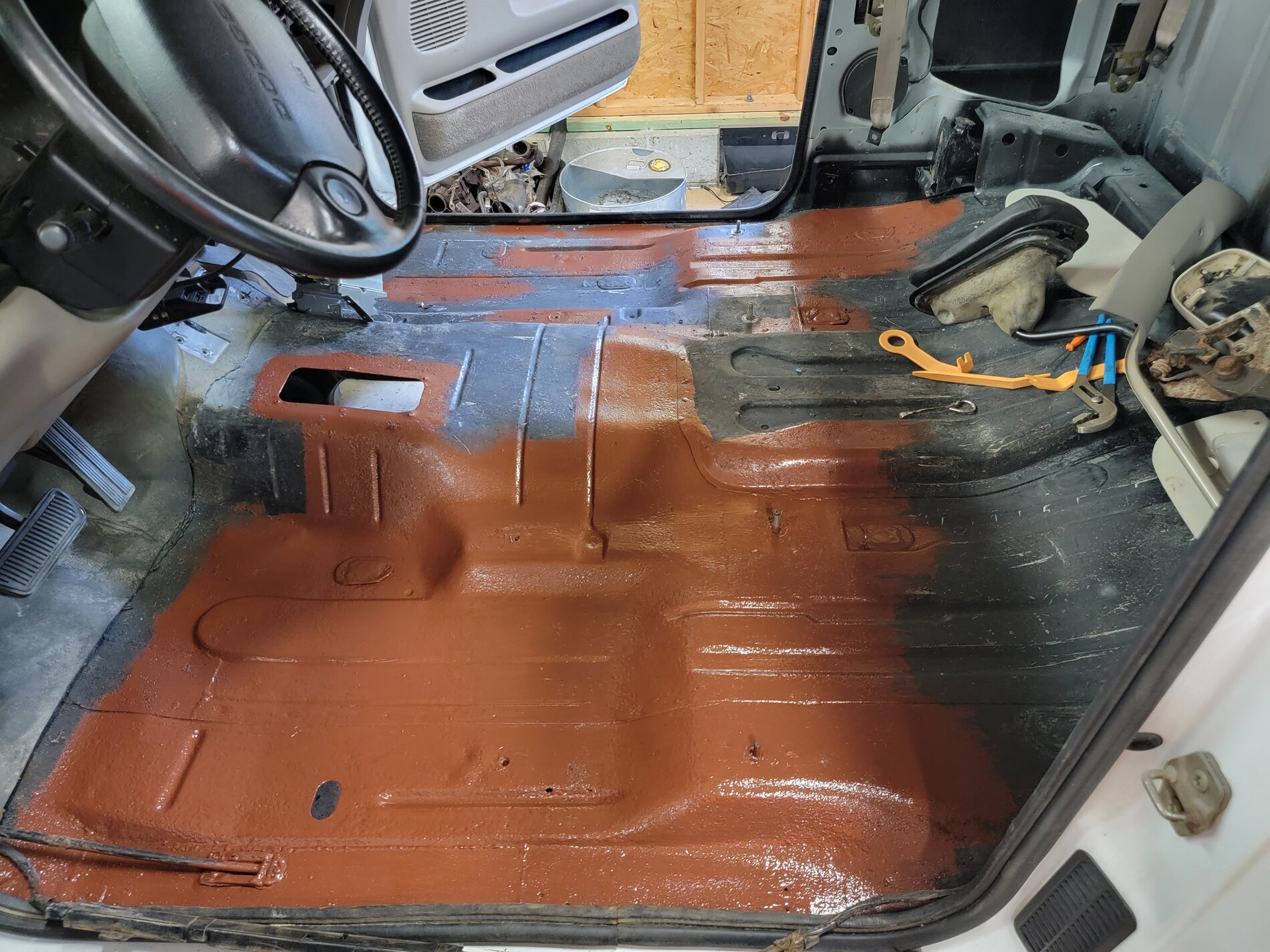

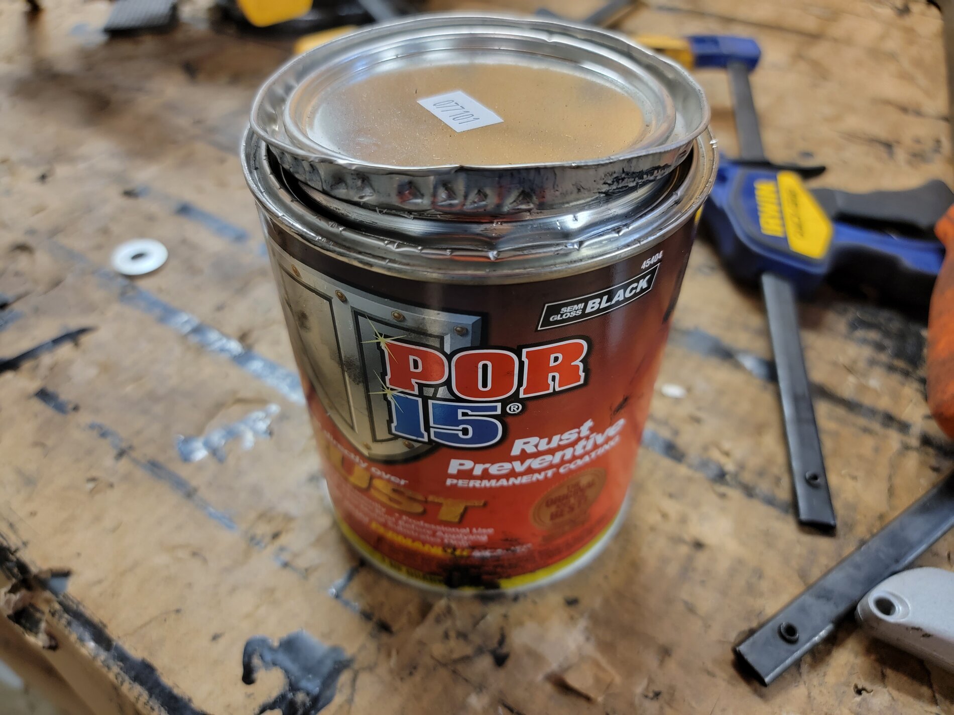

I'll just say POR15 is a horrible product IMO, don't try to change my mind, it's just not for me. I just used this can 2 weeks ago and now it's sized shut, and I always tape around the edges, it's super important with the stuff. Either way I scrapped it and figure if I was able to get the damn lid off good luck getting it back on.

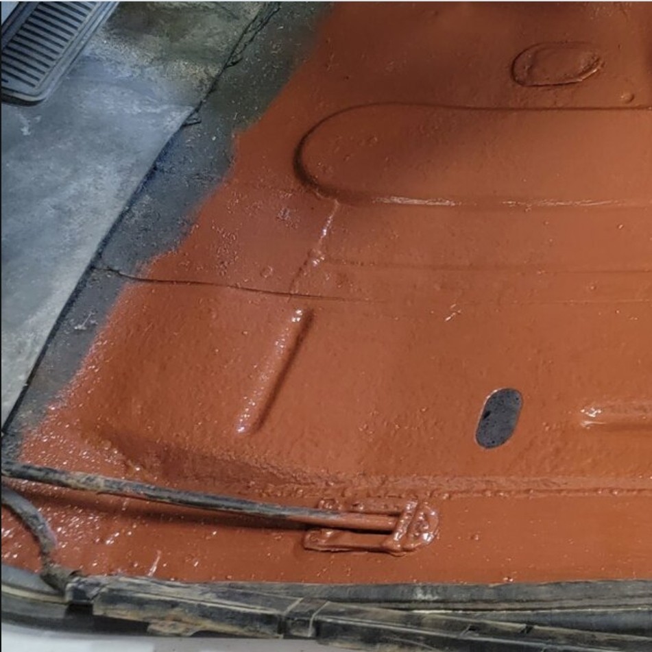

So back to my go to, Rustolem.

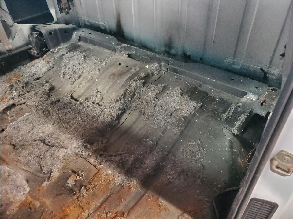

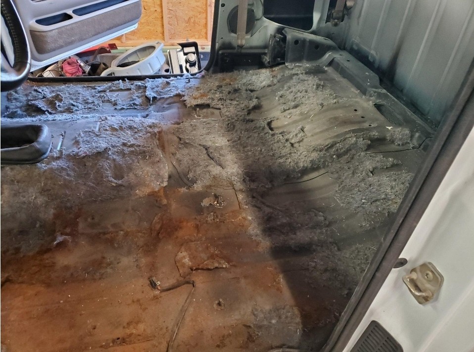

The PO really did a number on this Rig, they glued down the old crusty carpet that probably was rust ridden to begin with. Enough complaining... just dealing with it.
The floors are super solid they were all worked on during the PO frame off rebuild of this truck in Oct 2012, so it's been 10yr give it that. But it's not seen a winter or even rain since May of 2015 when I got it. So in just 3 winters this damage was done.
Most of this was already posted but it's in a old thread. Guess I need to work faster, after a year of no activity I think the threads get locked.
Here is a photo they provided when they rebuilt the truck.

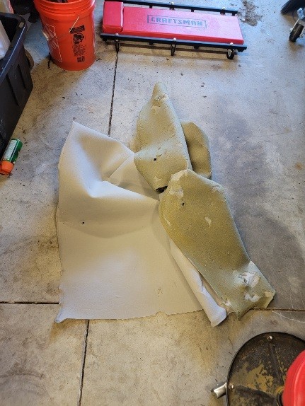

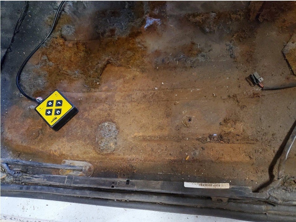

Here is after I pulled all the glued down nasty carpet out.

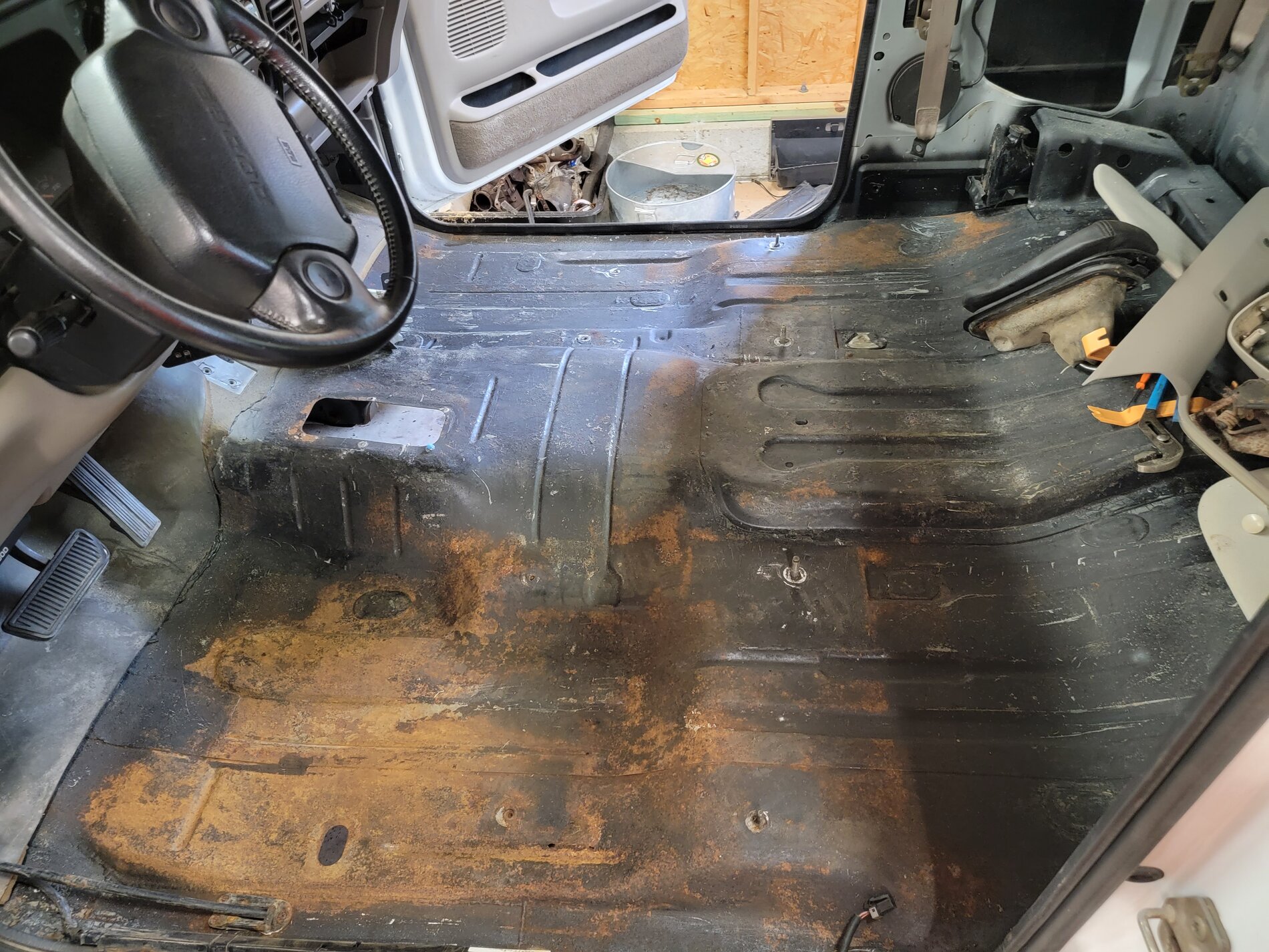

From today before primer, over time it was scrapped and cleaned up.
Rusty metal primer.
Hope to get some Satin Black on top of this next week.

You want to remove ALL the old backer from the headliner support. The new headliner material will come with new foam. I used 3M, which worked amazing.

I removed the headliner from my 1996 extended cab yesterday. I had become weary of having the fabric "snow" on me every time that I drove it anywhere. My wife had a delightful time tearing off the remaining fabric, such as it was, in long and fragile strips. The foam is also in bad shape, but it's coming off with some gentle work with a wire brush chucked into a cordless drill. I am doing that outside, away from the wife's koi pond, because the old foam comes off in tiny particles.
The front part of the fiberglass base is mostly intact, except in front of the hole for the ceiling console. That is delaminating. What have people used to stick the fiberglass back together? I am guessing contact cement.

I finished wire brushing all the foam off this evening. Then I used a random orbit sander with 120 grit to get the remaining nubs off. I got about a half liter by volume of brown foam particles. If my wife hadn't seen me doing the work, I would have put it all in a plastic bag and offered it to her as potting soil.:rolleyes:
The work left some pea-diameter pits in places that I'll probably fill with epoxy or JB Weld. The delaminated parts will get stuck back together using contact cement. I have had success over the years with 3M 77 spray. Then I think I will give both sides of the fiberglass core a coat of spar varnish or some sort of clear coat. That's to sort of stiffen or reinforce the whole piece.
Removal was pretty simple, once I figured out the trick. Mine is also a 2 door extended cab, so it looks like the headliner shouldn't come out. But it does. I needed to rotate it 90 degrees, in the direction that would case the least damage to the bad part. So I first tried to remove it this way, by putting down both seat backs, and lowering the tilt wheel. (The picture shows the delamination edge pretty well. It is actually worse than it looks.)
I quickly realized that wasn't going to work well, without trying to compress the brittle headliner into a U shape. So I walked around and RAISED the tilt wheel to the full up position, and moved the passenger seat all the way back to maximize space in the foot well. Then I slid the headliner under the steering wheel and under the dashboard on the right side, and it slid straight out the passenger door. Naturally, I didn't get a picture.:( I'll try harder.
Yeah that's the only way I figured it out under the steering wheel. I did not pull the seats to remove the headliner. It was already coming out.
