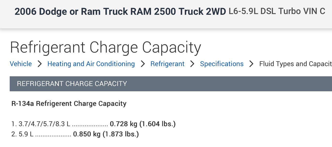

Would like to know how much freon does a 2006 Dodge Ram 2500, Quad cab, 5.9l take. Have spoke to 2 different dealerships and they have told me 1.85lbs. The sticker on the truck says 1lb. So what is it?
AllData says 1.873 pounds. Are you sure the sticker is pounds or kilos?
