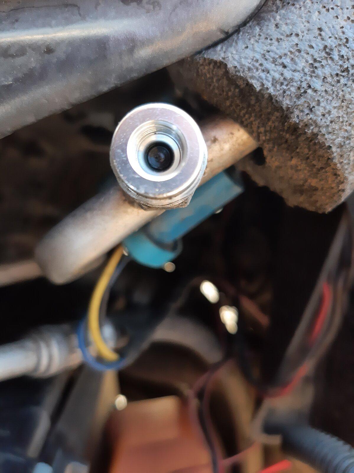

I missed that on my first read. If your high pressure side valve looks like mine in the above photo, there is an inherent design flaw. The rubber seal likes to dislodge when disconnecting the high pressure quick-connect. I installed a new one on my truck because the old one failed in the same manner as yours. The new one did the same thing when I disconnected the quick-connect the first time. I was not happy. I had to recover the refrigerant and when the system pressure became equal to atmospheric pressure I was able to push the seal back into place. I did not reconnect the high pressure hose for recharging. I now only use the high side connection when absolutely necessary because I am afraid it will happen again.
You don't need the the high pressure hose connected to the system to recharge with new refrigerant. You may want to consider that option if you have concerns regarding the high pressure connection.
- John
I did not notice the seal being dislodged, I will look tomorrow. This seal is in the Schraeder valve itself? I poked around on it to try to get it to reseal when it first happened, but no matter what I did it continued to leak. I figured it was contaminated and being held open by something. I bought 2 new OEM Schraeder valves, so they are going in regardless.

That piece of rubber was rolling around in my Schrader valve also, got a pick and pulled it out.
I ordered parts from Dodge and they gave me the wrong ones. $45 for two valves that looked like they belonged in a bike tire but mine had a replaceable cartridge. The Cartridge was unavailable from Dodge as was the entire AC line. I found the cartridge at Napa for $5.
