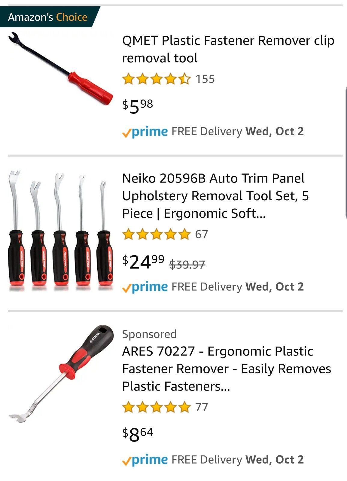

Same on the under hood, mine is gone but looks better without it present. You can pick up the plastic grommet tools pretty cheap.
