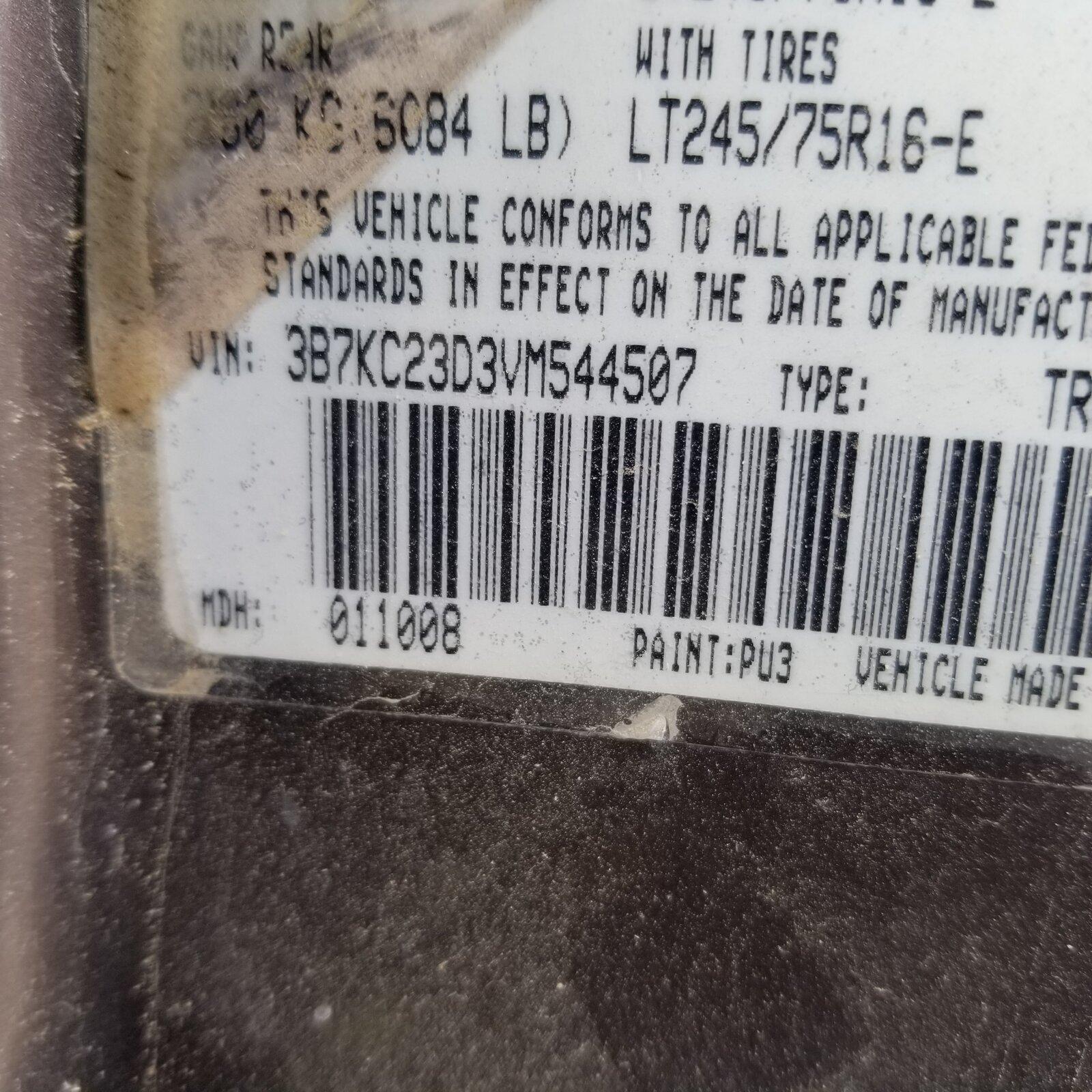

So I was given 2 trucks yesterday that are both 2G 2500. One was born with a 12v and the other a half ton short bed.
The child will be a 12v because its free.

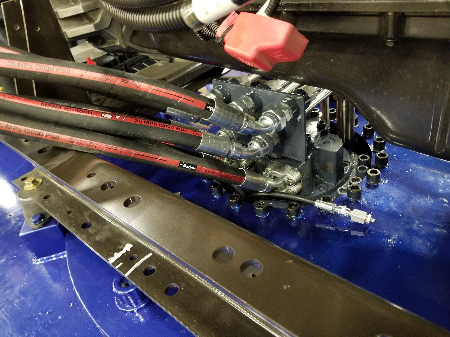

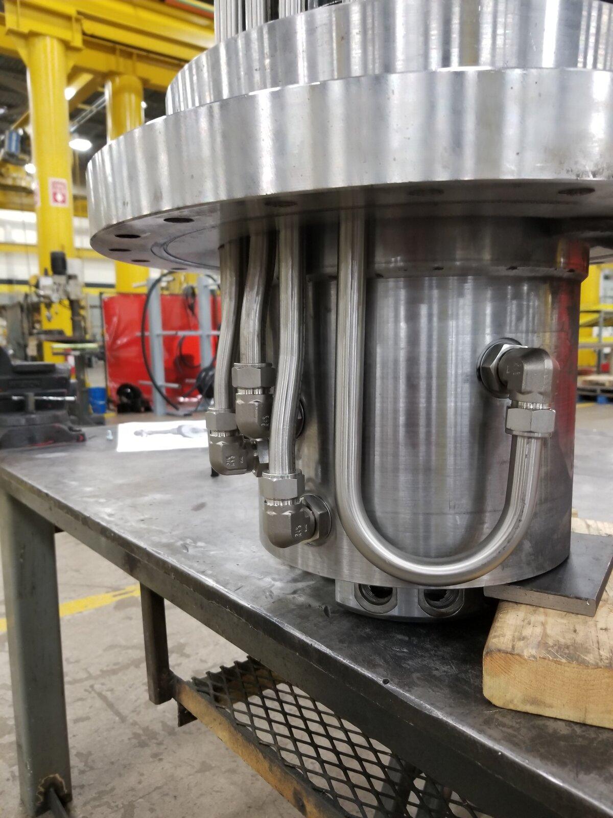

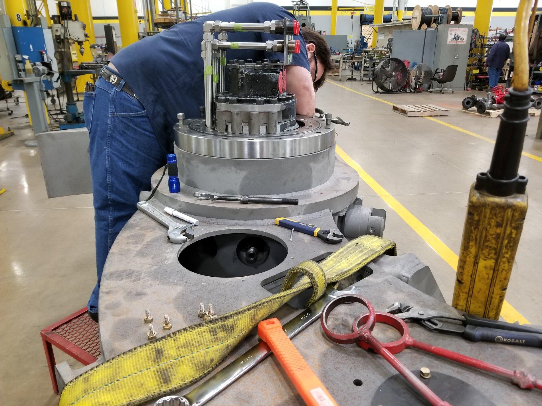

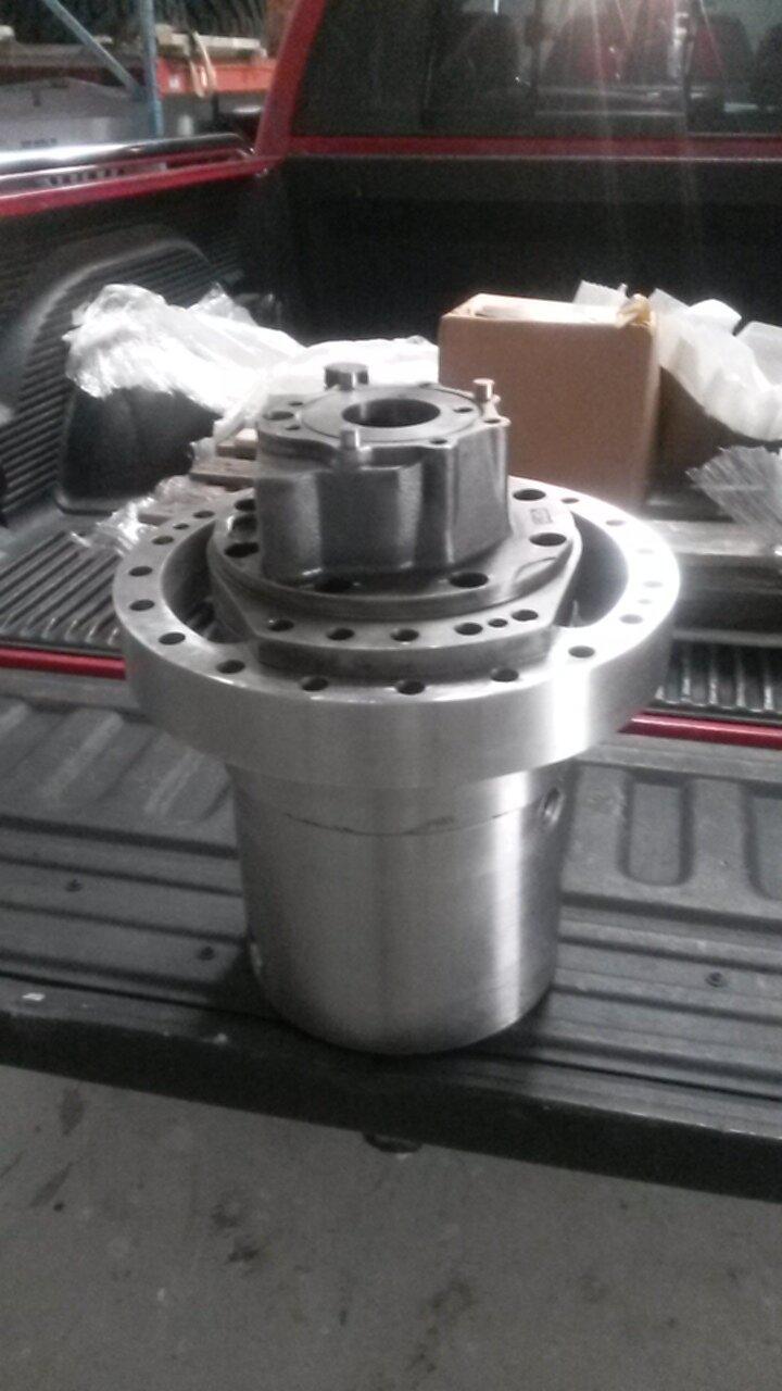

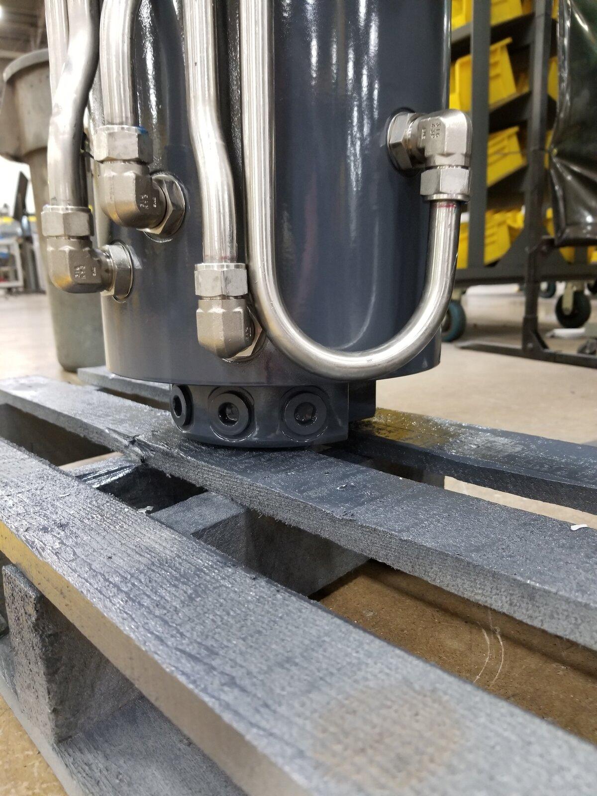

As far as torque capability, not a problem. One of my main entermeshed companies deals with radial piston hydraulic motors that go over 2 million ft/lbs direct drive.

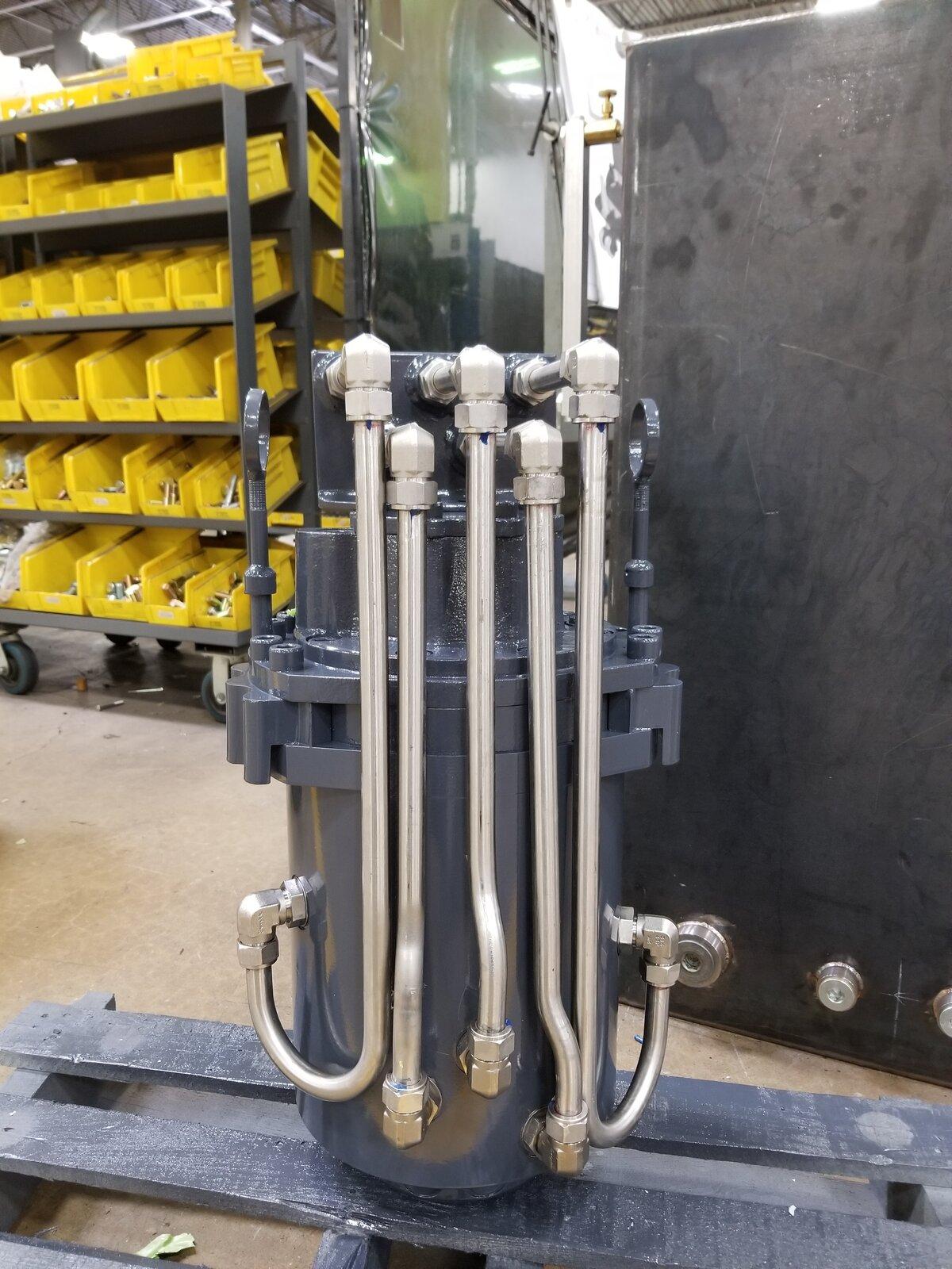

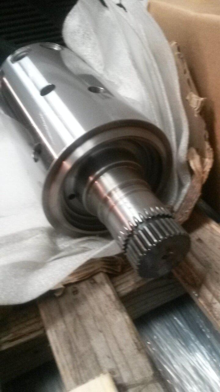

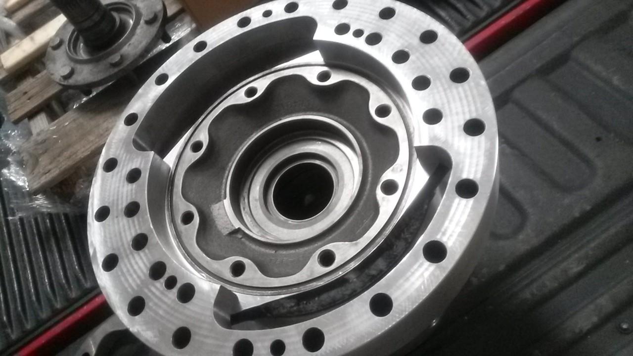

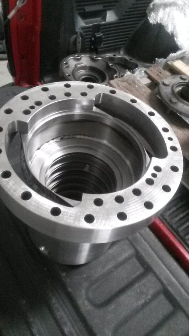

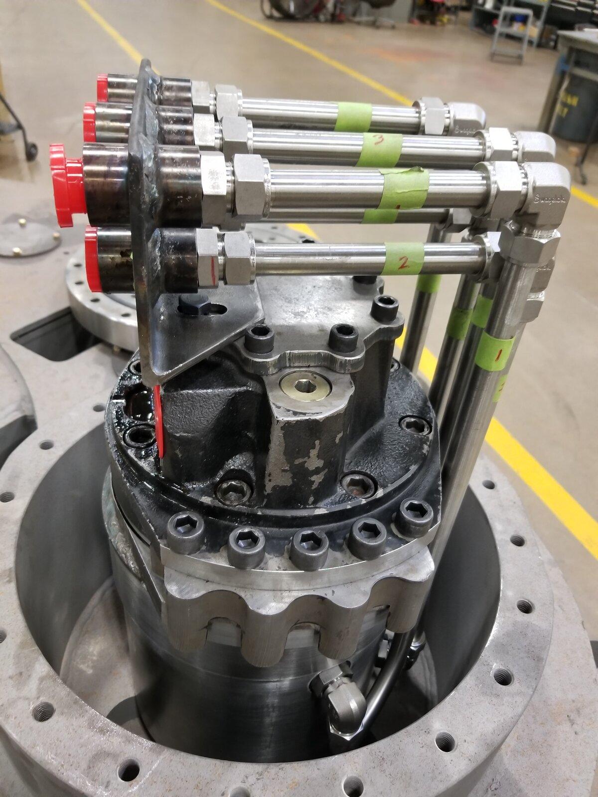

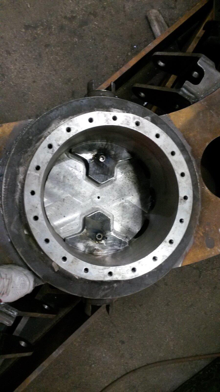

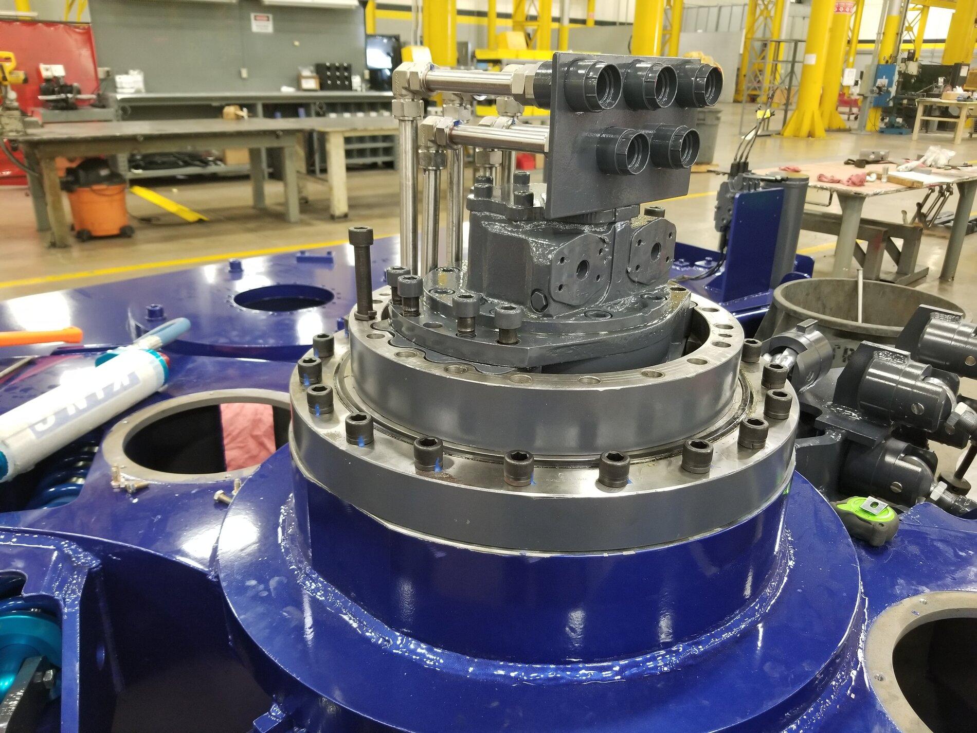

In these pics is the main drive from my grinder. I did all the design work on this myself. It was originally a wheel motor of 5000 ft/lbs. I kept only the cam ring and up which isn't much of the original then I designed the new nose and output to be a 5 port swivel with each port delivering 40 gal/min @ 4000psi working pressure and transfer the torque through the swivel. In the process we couldn't attach the motor or its output to anything because its inside a slewing bearing that would destroy the motor and swivel if it was more than 0.002" out of center.
The solution was to float the motor torque mounts and the output so it depends solely on its own weight to stay engaged and drive the entire 5000lb rotating group.
This assembly alone is just over $40k my cost to produce.
You can believe me when I say we can build a transfer case to suit the request and have safety margin.

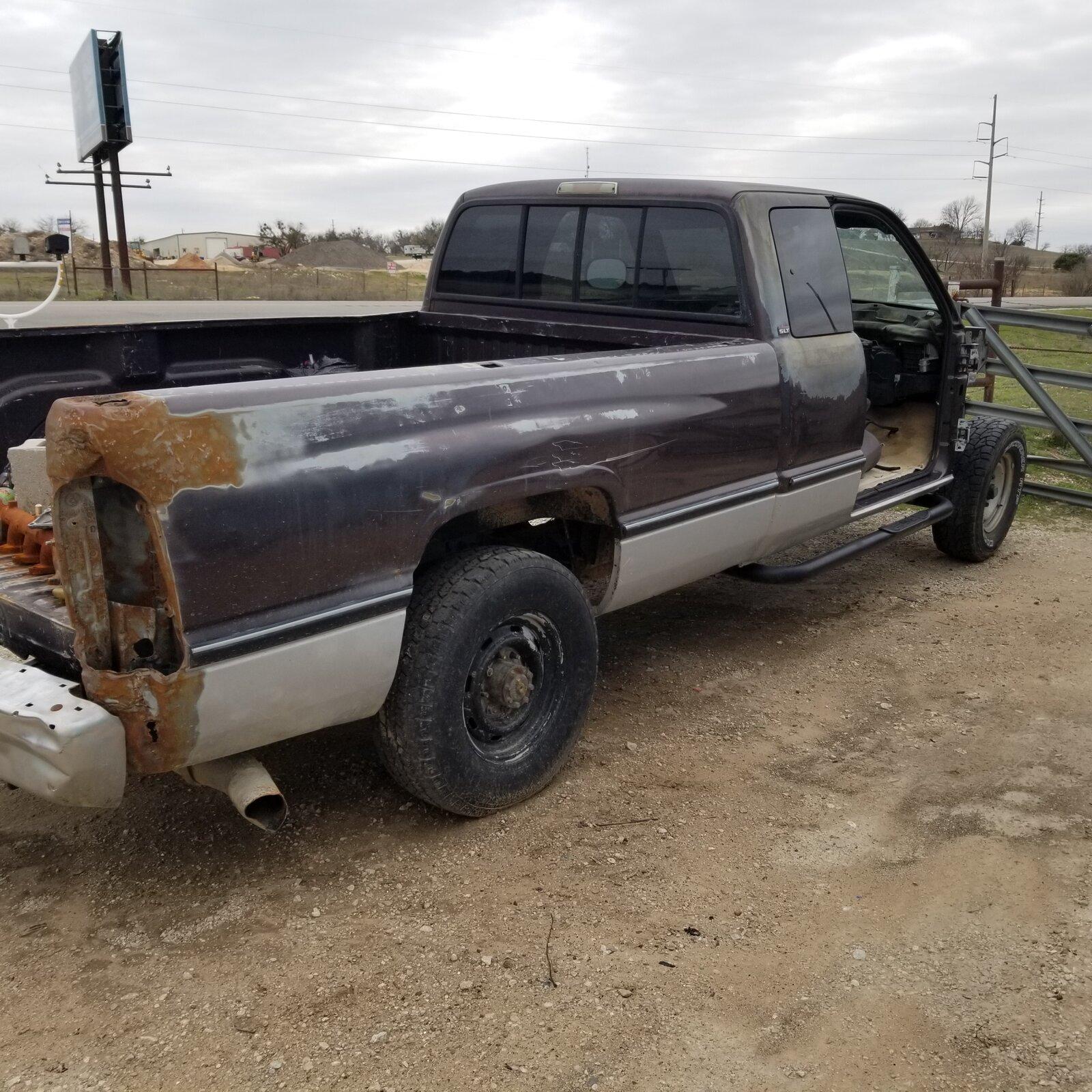

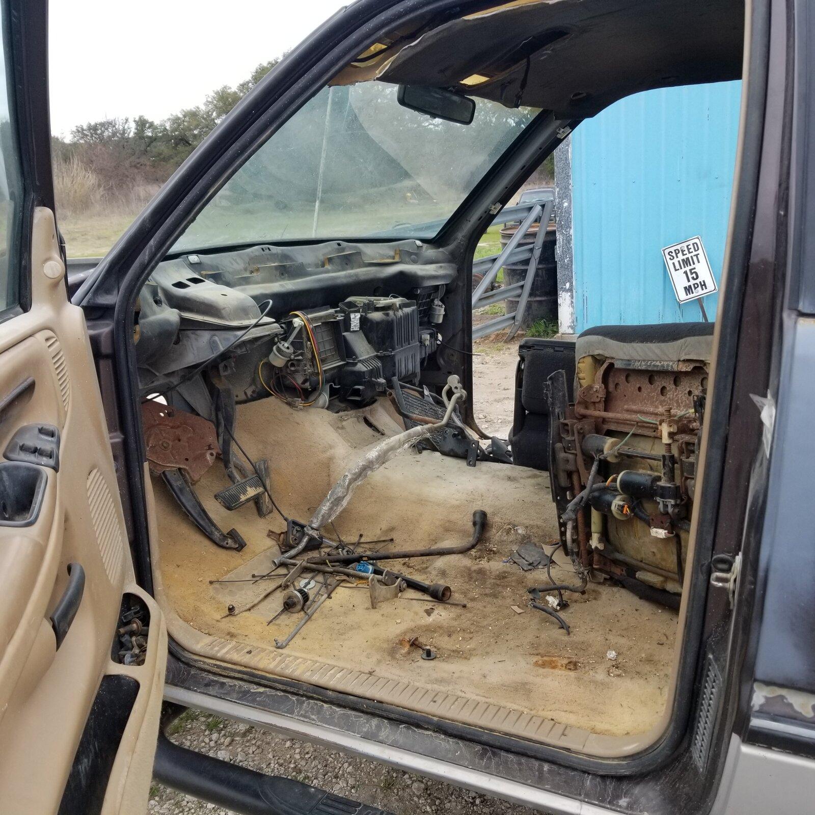

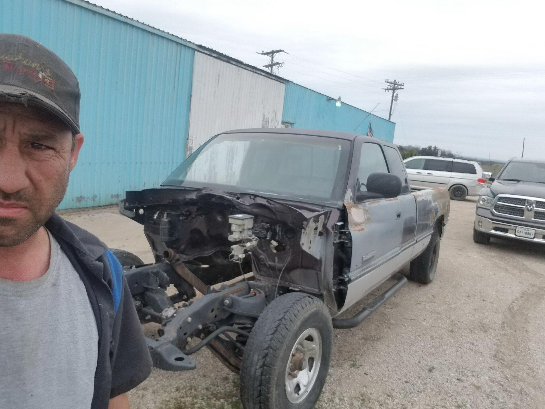

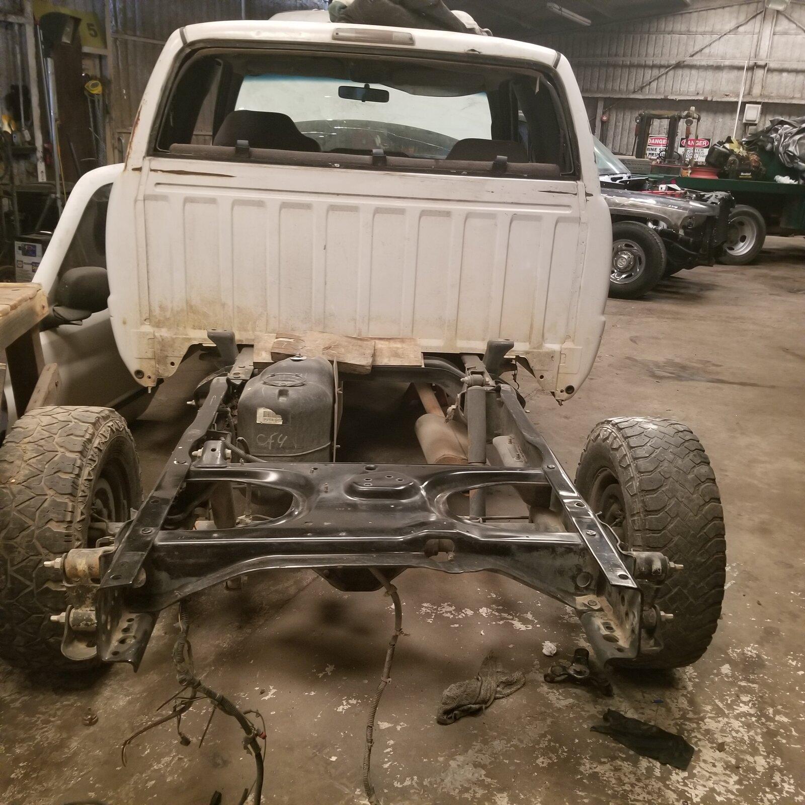

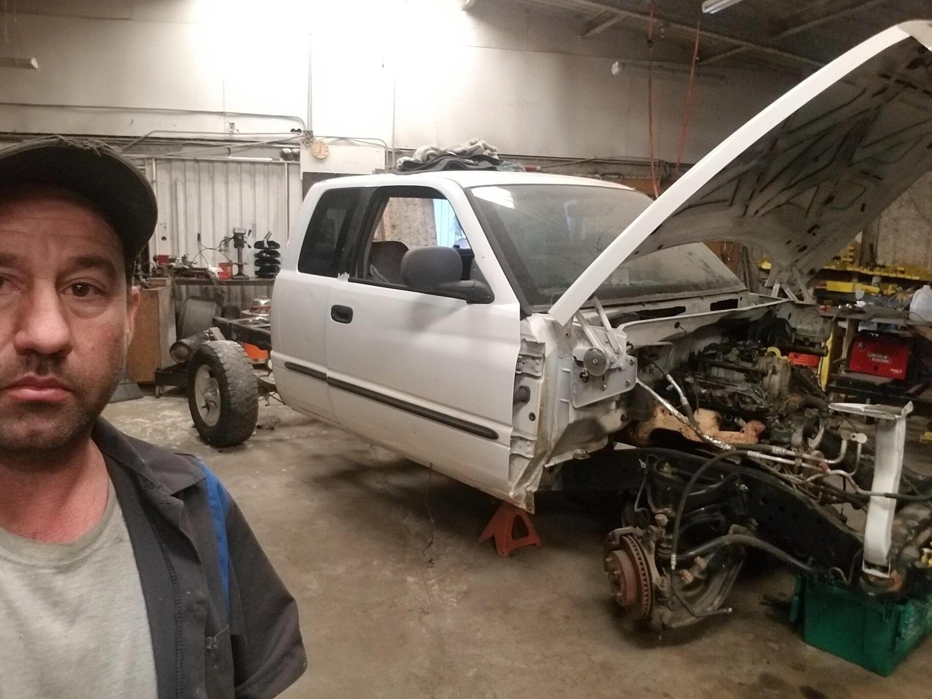

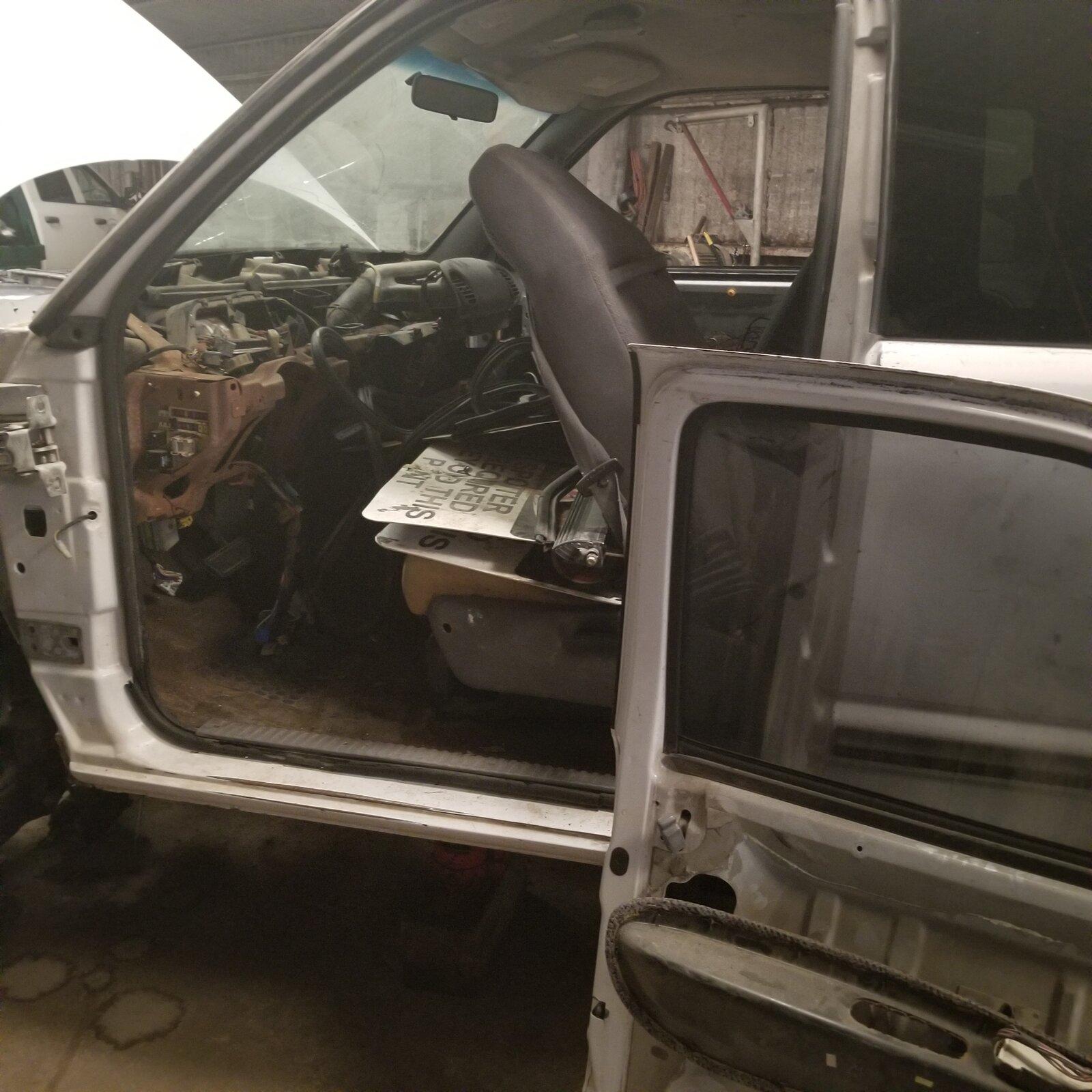

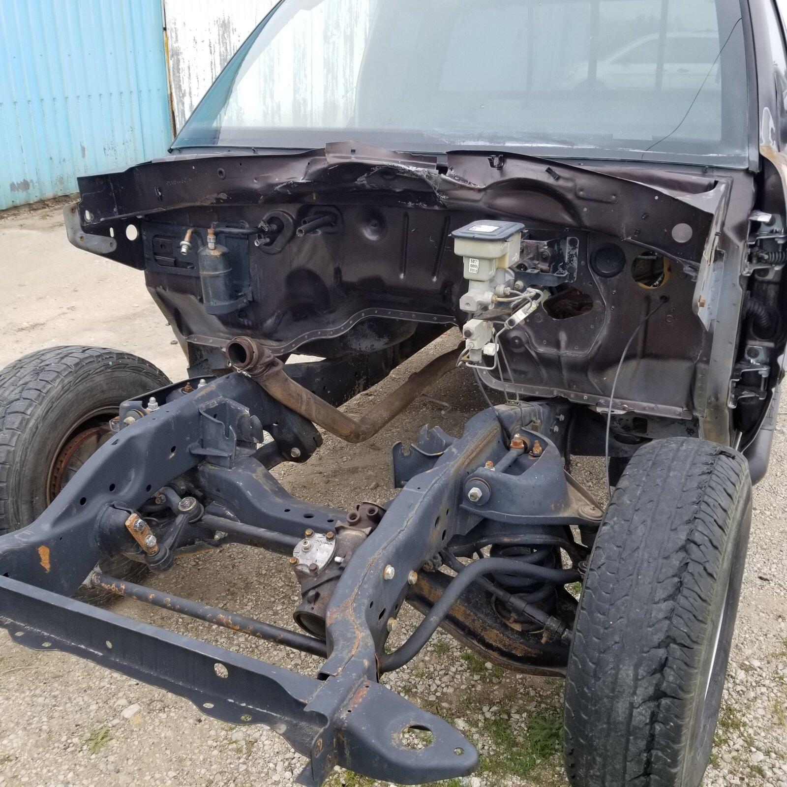

I can't sleep. I'm too excited about this mid engine thing. So here are the vehicles. Which ever one ends up being the one will end up with zero interior and 2 race seats so never mind the interior current condition. We have ample body parts on hand so never mind lacking pieces. It WILL end up a short bed and reversed frame rails in the rear for at least 18 inches of rubber inside a single wheel bed body line.
It will end up lowered to the point 30 inch tall tires are as close as we can get it to rubbing the body at full compression of the suspension and still turn the steering wheel lock to lock....I can't stand rubbing tires that require attention to driving just to avoid contact.
This one will get a solid front axle. If C notching the front is what it takes that's what it gets. We have learned how to do the rear frame flip to drop the frame from the cab forward using almost all factory hardware.
It will be a 12v p7100. This one will probably make about the normal, (and don't get mad) 175ish horsepower on the ground that those made factory. I don't need 500+horsepower to do base line weight and balance handling performance testing. That will happen soon enough.
???????????YOUR THOUGHTS?????????
No beauty queens but damn fine test beds.
Damn I just realized they were both born automatics. I'll find an NV4500 with transfer just to get started with. Derek has a weird thing about wide open throttle standing still and side stepping the clutch. He donated both trucks to stop me from chopping his race toy so I guess I owe him at least a drive line explosion once in the process before it starts getting expensive.

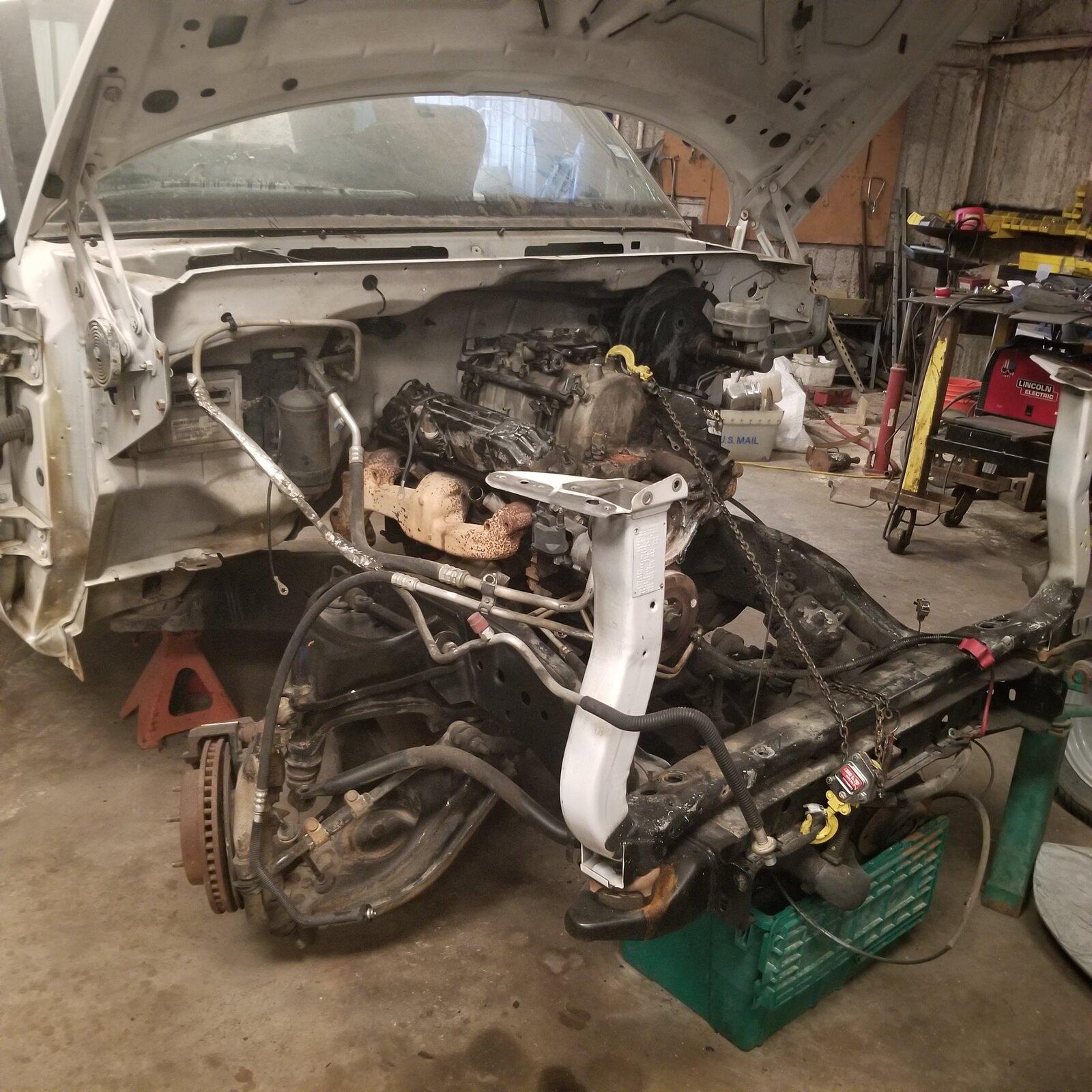

Have you seen the thread about moving the engine back? That frame was a 2 wheel drive half ton. I cut the entire front suspension and cross member clean off the frame to bare rails and starting completely from scratch on that one. I realize that's out of the question for most people but something you might want to follow.
Have you seen the thread about moving the engine back? I realize that's out of the question for most people but something you might want to follow.
