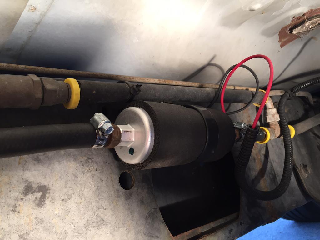

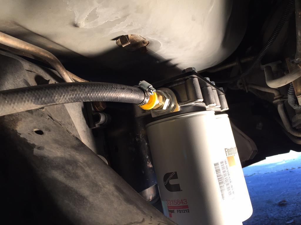

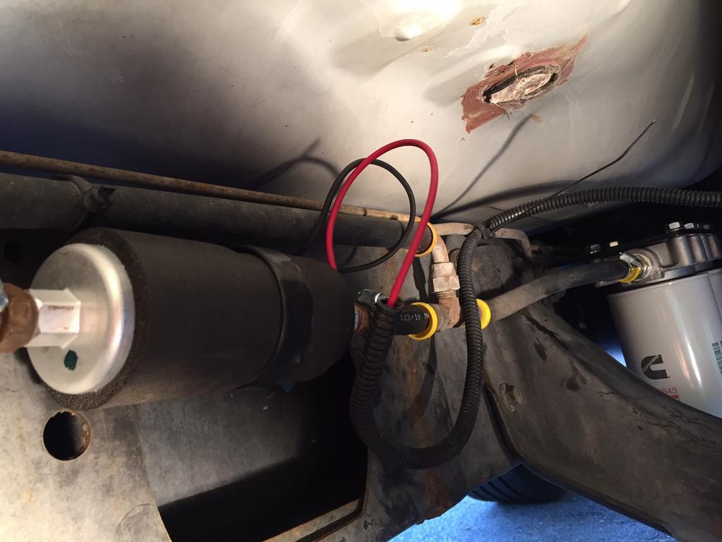

I upgraded the stock Carter pump 10 years ago with a Glacier Diesel Walbro GS92 and a Fleetguard strainer. The filter is stock.

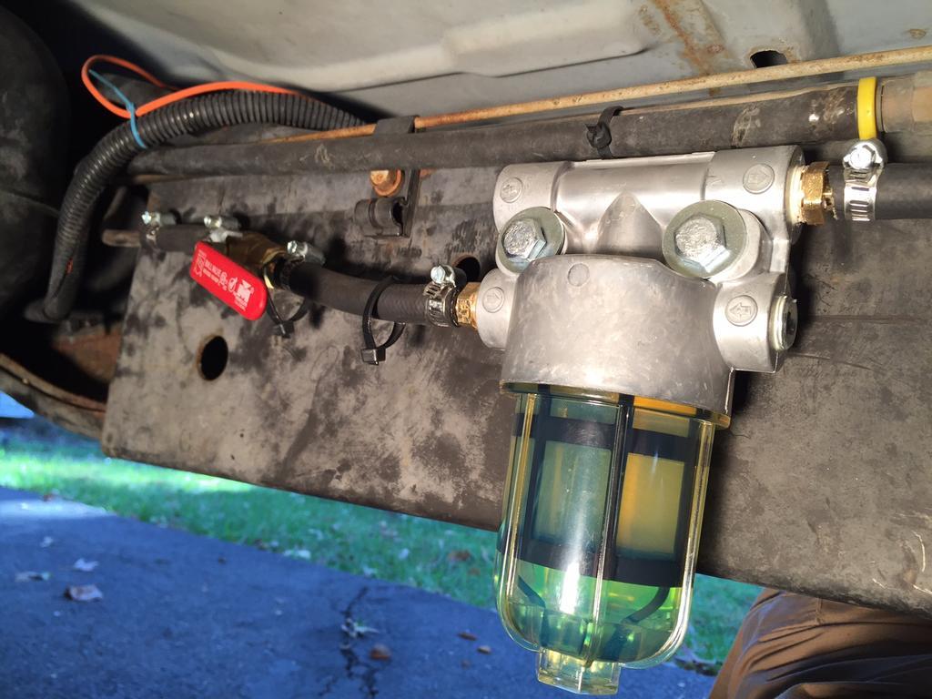

The original Fleetguard strainer was bugging me, as you can't see what's inside and they're a pain to change out. I replaced it with a Racor PS120 pre-filter/strainer with a 200-260 micron filter screen. Much better than the little Fleetguard can. Just unscrew the bowl and wash the screen.

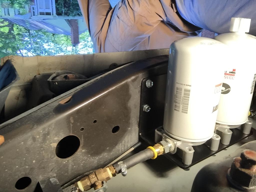

The Walbro pump has been giving me perfect service for 140k, but it was making strange noises, so I replaced it with an identical version. I liked the Glacier Diesel twin-head system with the 10mic/WS and 2mic Fleetguard filters. Much better peace of mind.
I left the stock filter in, but it'll never need to be changed out.
I added 3/8 ball valves both before and after for isolation. I can lock out the whole system for changing filters.
The Glacier Diesel twin-head filter is $200. It comes with the filters and push lock connectors.
The Racor PS120-02 is $60. It comes with two seal plugs and you provide the 3/8 hose barb fitting.
