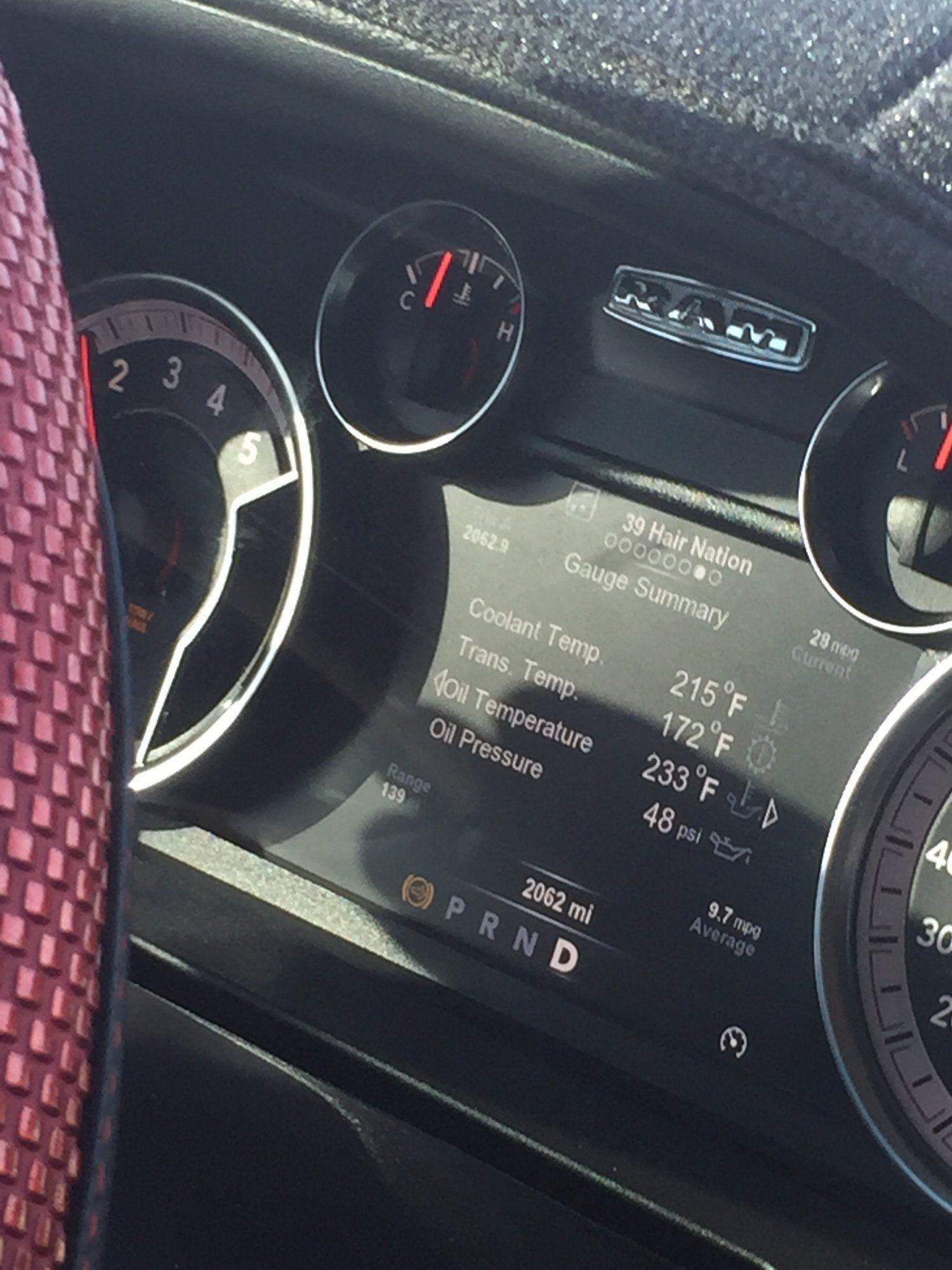

This is a pic of my transmission temp towing our 13K lb enclosed trailer. Ambient temp was 94°F.
This was a 137 mile trip average speed was 60/65mph.
I will stay with my RL-75W-110!
I will service the Rearend unit every 30K miles.
(I will barely accumulate 6K a yr since I have a company wk truck).
I don’t tow 24/7. 15Klb will be my max.
Going to use this @ the 10K mile mark to suck out the FF gear oil in the rearend & refill with the RL 75W-110.
Also use this with my 68RFE @ refill with Schaeffers All-Trans.
