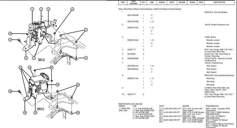

While doing some research, The 1999 dealer parts manual has the following listed :
BGJ=R.W.A.L.-Rear Wheel Anti-Lock Brakes
BGK= A.W.A.L.-All Wheel Anti-Lock Brakes
HCU= Hydralic Control Unit

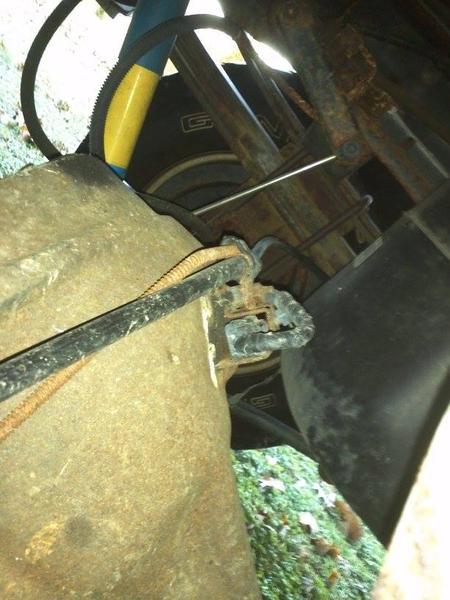

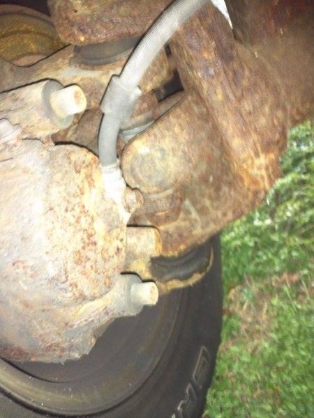

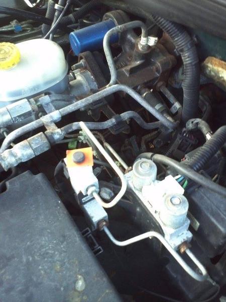

So went under the truck for a couple mins to look around. I see a sensor of some type on top of the rear diff. Didnt go all the way under as the ground is soaked. I do not see any wires or anything going to the front hubs. Just a rubber hose for the brakes. Looking under the hood there is only a small module that looks to be a ABS module? So looks like I only have rear ABS.

You would probably have to take the wheel off to actually see the front sensor but you should be able to see the wires going to it in the fender well. From the looks of the module you have rear abs only.
Looking in the factory parts catalog, I found the ABS module section and looks like the one I have is for BGJ (Rear ABS). Looks like 4 wheel ABS was an option for 1999 trucks also.
