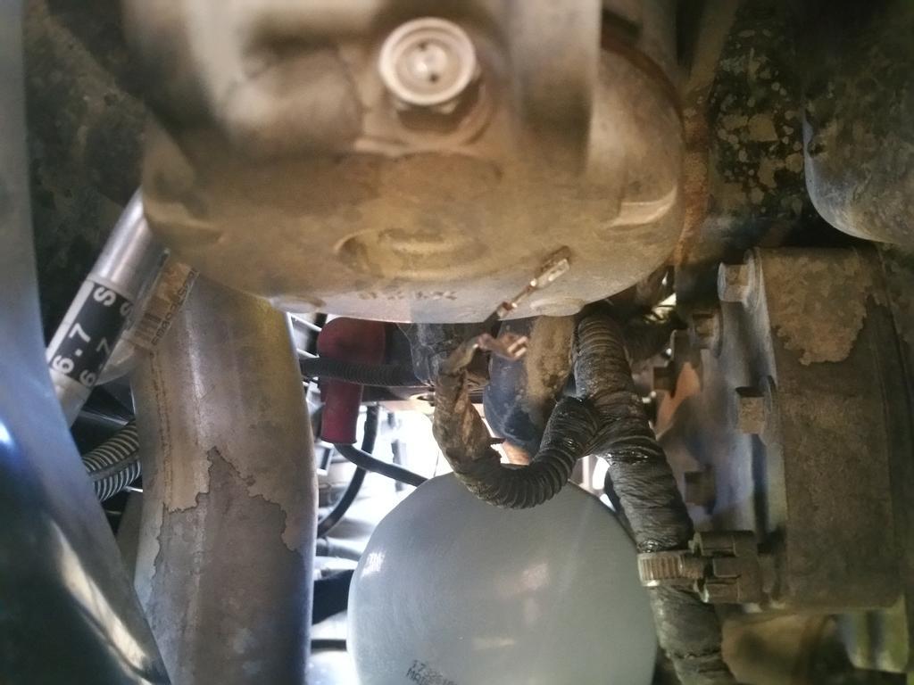

Here's what happened. Went to the dealer for an oil change. Left but noted the AC knobs all in different positions, thought nothing more about it. 2 days later when the temps here in SOCAL went I find the A/C isn't working. I slid under the truck to see how hard the compressor was to replace if I had to do that and saw 2 wires hanging below/next to the oil filter. I felt around and found that they were the wires which go into the connector to the A/C clutch. RAM admitted damaging the wires and connector and repaired them. During the repair they "discovered" the clutch had a short in it and now didn't work. They refuse to repair the compressor/clutch because it "exceeds their good will repair policy".

I'm trying to picture what they did, must have gotten the A/C clutch wires bound up in the filter wrench or caught them with the handle??
If they pulled the harness hard enough to rip the wires out of the connector then it is also reasonable to figure they might have pulled one out of the coil magnet behind the clutch where it cant be seen..are they saying "Short" or is it "Open Circuit"??

62k miles. Thats exactly what I think the tech did. The wires on the engine side were completely yanked out and the connector itself damaged with the red locking tab gone. They said short circuit. Heres what t saw...

I would tell the dealership that the AC worked fine when I brought the truck here. If they didn't find the broken wires until after they started the vehicle, who knows where the wire brunt through and shorted.
Go up the chain of command to the general manager of the store.Be respectful and show him the pics of the initial damage.Failing clutches are not rare on the 3rd gens however I have not dealt with any on the 4th gens.The parts dept can pull up the avg numbers for the weekly demand
