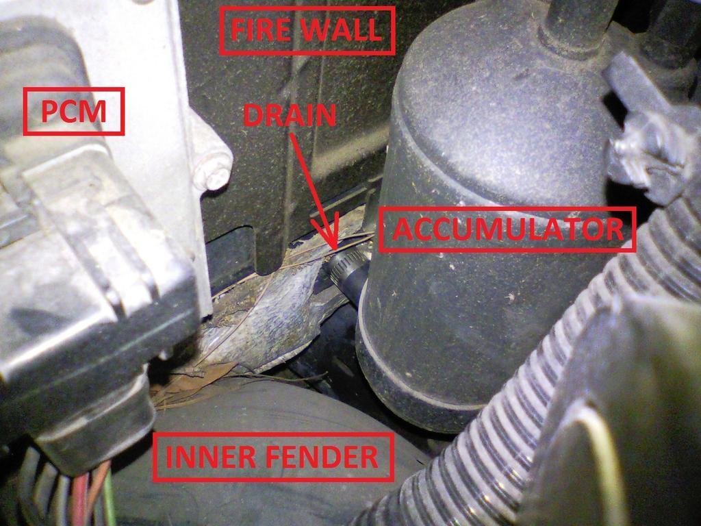

2nd Gen Non-Engine/Transmission AC condensate Drain

I used an old spark plug elbow on mine. The nipple outer diameter is 9/16 on mine, yours is probably the same.
The foam seal allows water to run back down the tube and leaks into the cab. I clamped a piece of 5/8" heater hose on mine. The clamp is probably not needed, just assurance it won't call off.
