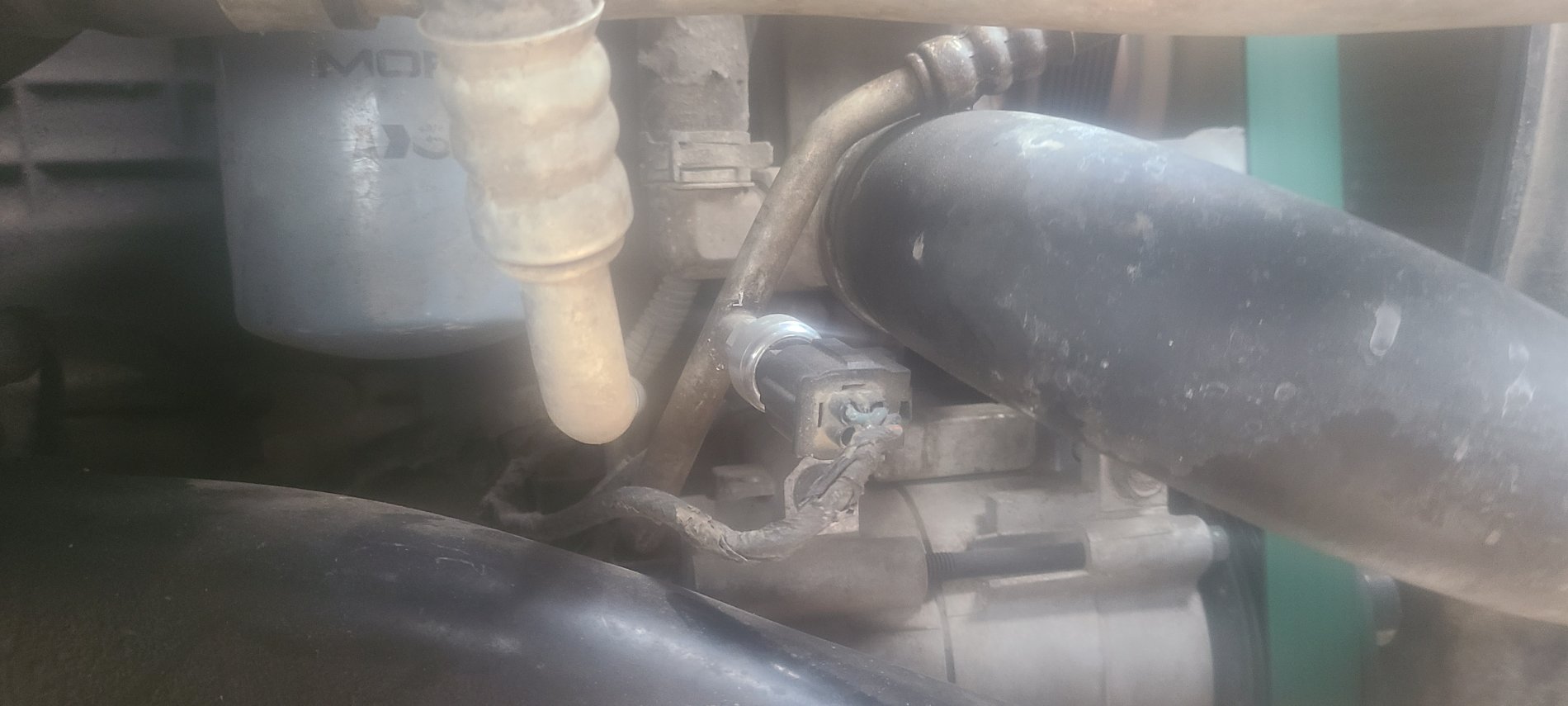

Okay simple deal or so I thought. I own a 2006 Dodge 2500 crewcab 5.9L cummins . Anyways after vacuuming my system to prepare it for a charge I noticed I was actually looking vacuum. Okay after some sniffing around with my little gas detector after I put in about a 1/4 of a can of 134a I found, the leak it's at the crimp just before the bung hole for the high pressure switch. Okay step 3 find a replacement hose. Mopar preferably. Trouble is In every picture I've seen on the various vendors website, it shows me what looks more like a HI side service port, and not threaded bung for where the pressure switch would go. IM at my witts end trying to find the correct hoses bothe high and low, so thT being said if anyone out there can point me in the right direction , a p/n any help is appreciated.

Have you removed the high pressure switch to see what it is screwed into? I know on some vehicles the pressure switches are screwed onto fittings with schrader valves in them, allowing the switch to be replaced with mimimal loss of refrigerant.

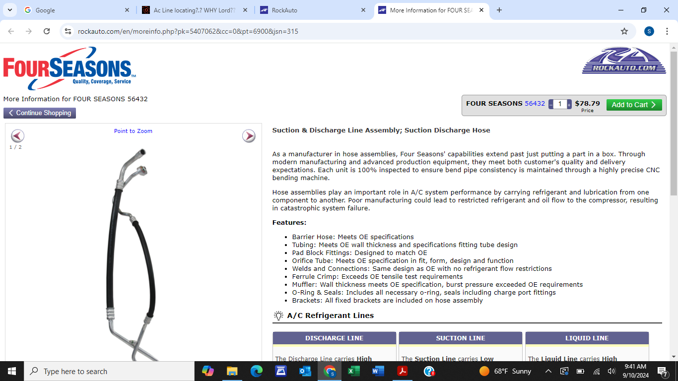

Well 31 looks like it it has the pressure switch in the correct place but ,riddle me this, , its a suction and a discharge hose which all connects to a common manifold so if i buy 31. Which im hoping covers me for both the high and low side hose requirements?? Corect me if im wrong on that
Once again a million thank you!!!

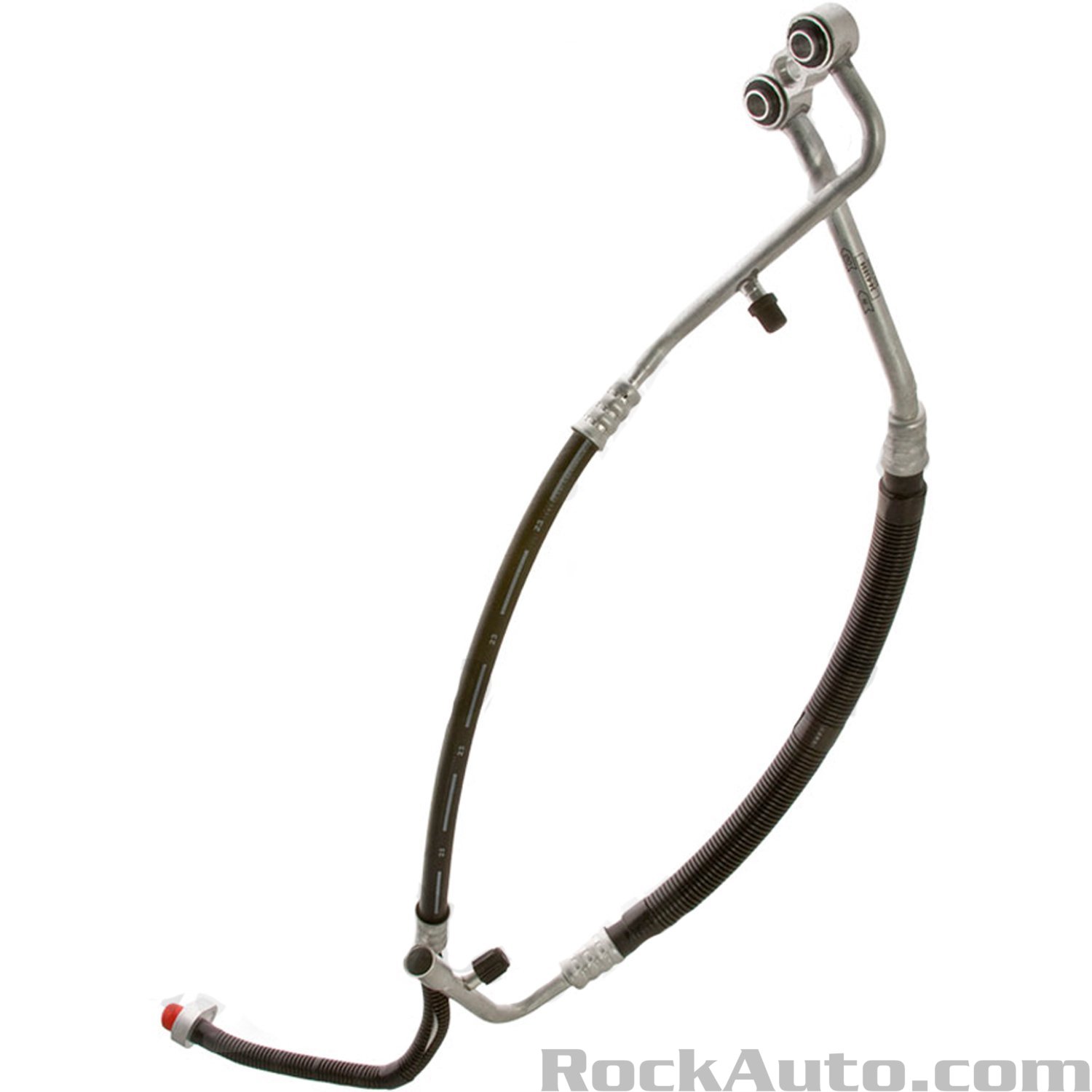

doesn't that common manifold on a Dodge include the so called metering device? AKA the "orfice tube" or whatever Dodge calls it? The Rock is showing something like this , which looks like it has pressure portView attachment 141906
Grumpy, we are getting close. My only problem I see with that hose you pictured, is that service port with the black. cap and yes that is the tube where the orfice tube is built in and that line I belive goes to the evaporateor core . LET me throw another wrench in the works. My trucks low side is on the dryer/accumulator, so what's. The deal with that service port on that lo side?‽?
Probably differences between build years of trucks, I've seen vehicles before with three ports. I can only guess but maybe Ram moved the port from then dryer to the hose and now there is only the hose with the port available as it doesn't matter to have more ports then non.

From everything I can check - the hose kit that was given to you above is the correct line for your vehicle.
By the way the orifice is in a different line, you can find it browsing in the rockauto.com link above.
Hey I ys, just wanted to say thank u to everyone that helped me out over the past 3 days it turns out if stupid me would have just removed the plastic "thread" on cap t.i would have discoverer 8ts actually a threaded fitting for????? Yup u guessed it the H pressure transducer.
SHAKIN MY HEAD !!!!! ANYWAYS just wanted to tell yall thanks
