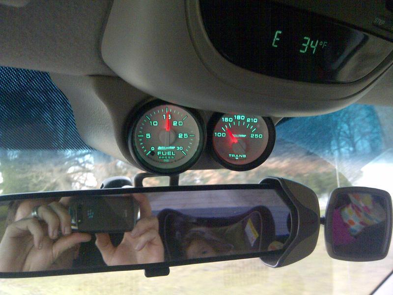

Where are you mounting the gage?
I used a windshield mount and tapped into the wire that feeds the overhead display. Works fairly well, doesn't go quite as dim as the dash lights, but definitely tones them down a lot.

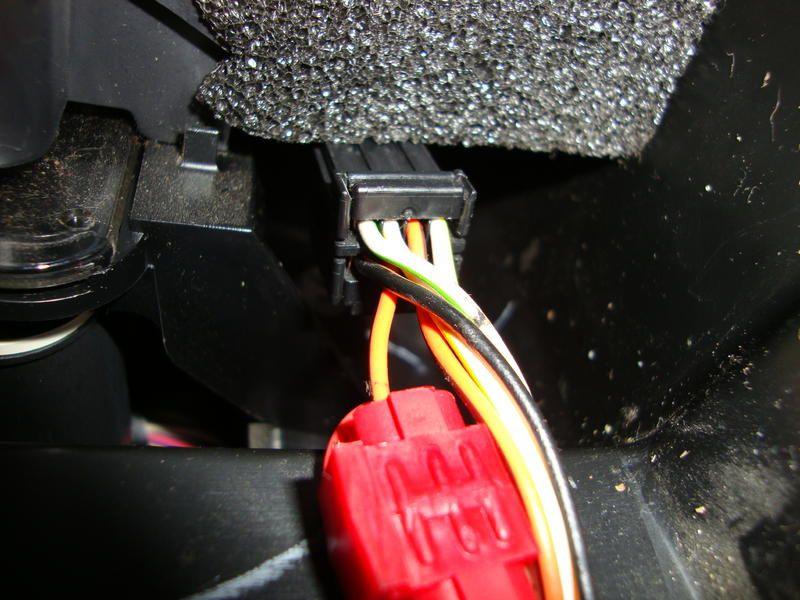

You can also tie directly into the dimmer switch. Geno's garage has a decent write up on accessing it. I did this with some gauges I used a column mount on before I moved them to the windshield and it worked.
http://www.genosgarage.com/installation_instructions/GGInstall-DG-GaugeInstallTips03-09.pdf
Picture of that hook up, make sure you get the right pin for your application.
Good luck.

If I remember correctly, I used the OR/BR wire coming off pin 2 of the headlamp switch (panel lamp dimmer signal). You have to check with a meter to make sure you have the correct wire as there is also an OR/BR coming off pin 4.
