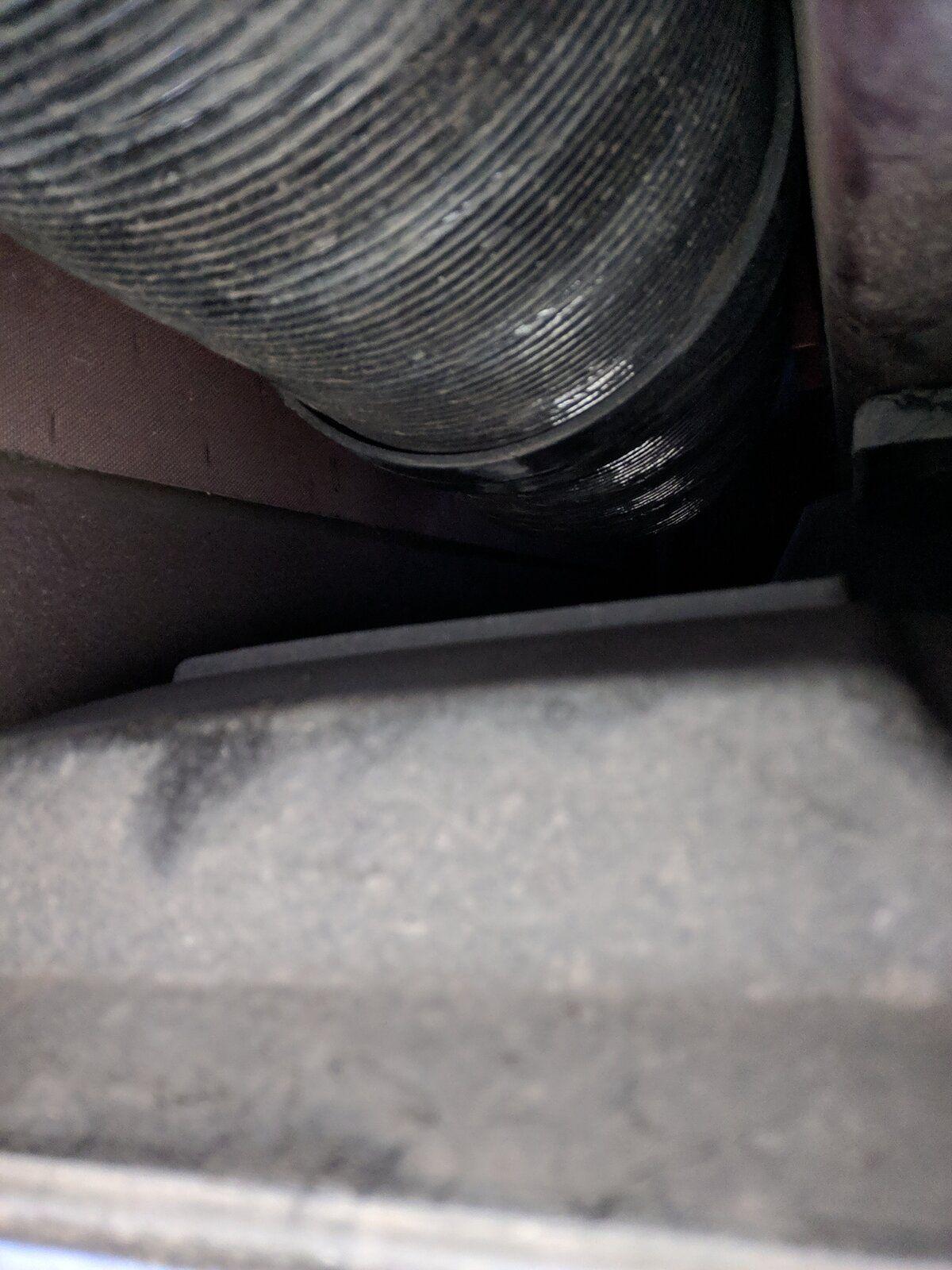

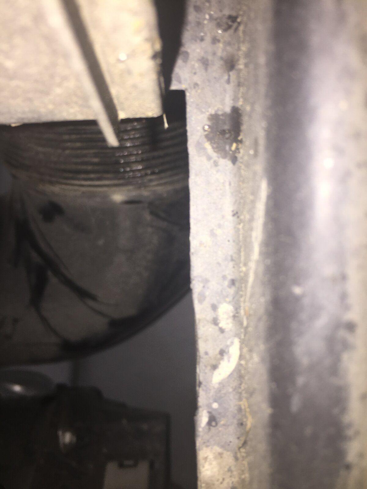

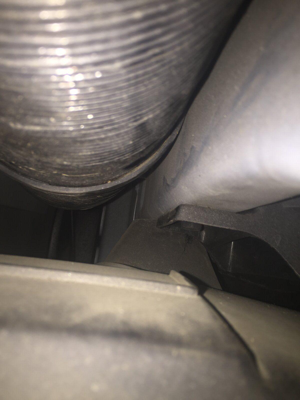

OK what do my pics show" Potential issue?
First pic looking thru door, second looking up and third looking back.

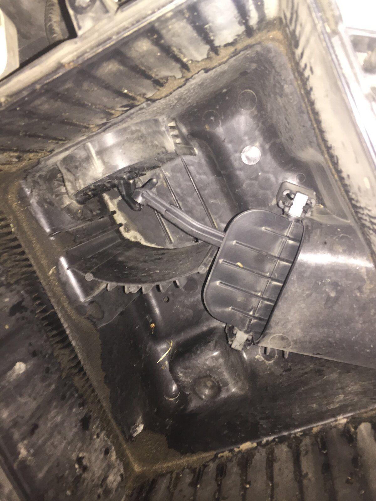

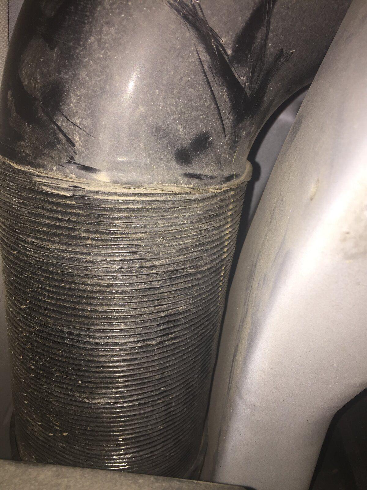

I will go take pictures of mine. So here is the what I think we have. It as a flexable semi rigid PLASTIC hose, NOT the paper/fabric type hose that get sucked flat. SnoKing
Amazing picture. Thanks.
How did you get such a great picture?
Is that from the trap door or with the liner removed?
I'm 99% sure that my `14 has the "dryer vent" paper/ fabric extension hose.
If I can cut the extension crap from the trap door, well I'll get the granddaughter to do it, THAT is getting done ASAP..
Thanks again SnoKing!
