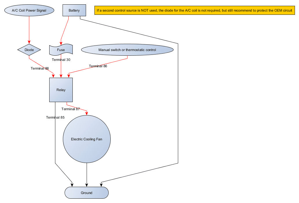

I am looking to add an electric fan in front of my A/C condenser to help with cooling. I have seen where some have done this and said it helped. I want to try it.
With that being said, I have a fan (BeCool 16" pusher). I need help with the wiring. I am not and do not claim to be an electrician, let alone an automotive electrician. I have searched threads on here and sadly, they are over my elementary electric comprehension brain.
My thoughts for how I would like it to work are 1 of 2 ways. First way: Trip a relay to power the fan when the A/C compressor kicks on. This seems optimum as it is only running when I need it to run. Second way, Trip a relay from a fuse that gets power when the ignition is in the run position.
If you have done this and can help with instructions (part number and how-to) on wiring this up, I would greatly appreciate it. Thanks in advance.

Yes, quick and dirty wire it off a relay from the compressor coil. Condenser temp probe would reduce the "windmilling" restriction because the AC doesn't use the fan a lot over 45 MPH unless the blower is on high and it's over 100 out. You will need a probe that works around 150 degrees F - most are calibrated for radiators and don't kick in low enough to do the AC any good.

But if you are going to install the fan here is a basic wiring diagram for how to set it up safely for the vehicle's existing wiring.
