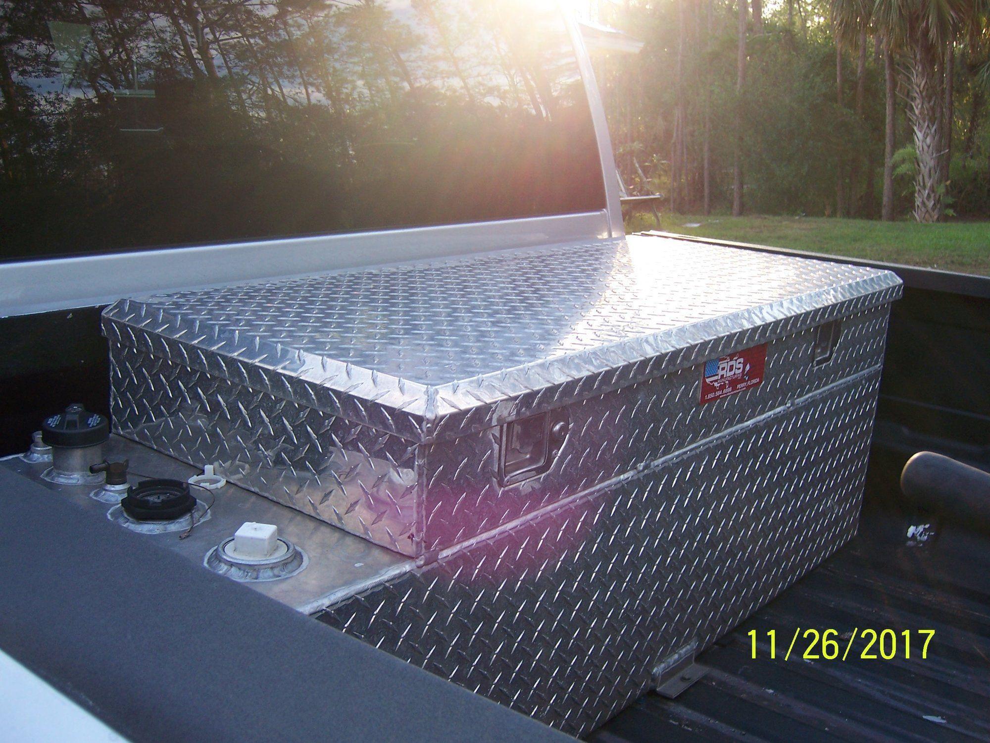

I have the 8 foot bed with this 60 gallon toolbox/tank combo in it and there is plenty of clearance between hitch and tank.

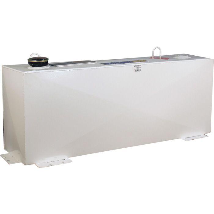

As per the above comments, while good suggestions, those tanks won't fit between the fenders and the front of bed. A 4' wide tank will fit between the fenders, but some leave inadequate room between the tank and hitch. A 6' wide tank will need to be tapered on the lower section to clear the short bed inner fender wells..... There are also some rather affordable steel 30gl tanks that are only about 10" wide, 60" long, and sit up about even with the bed. Easy and affordable way to double your fuel capacity.

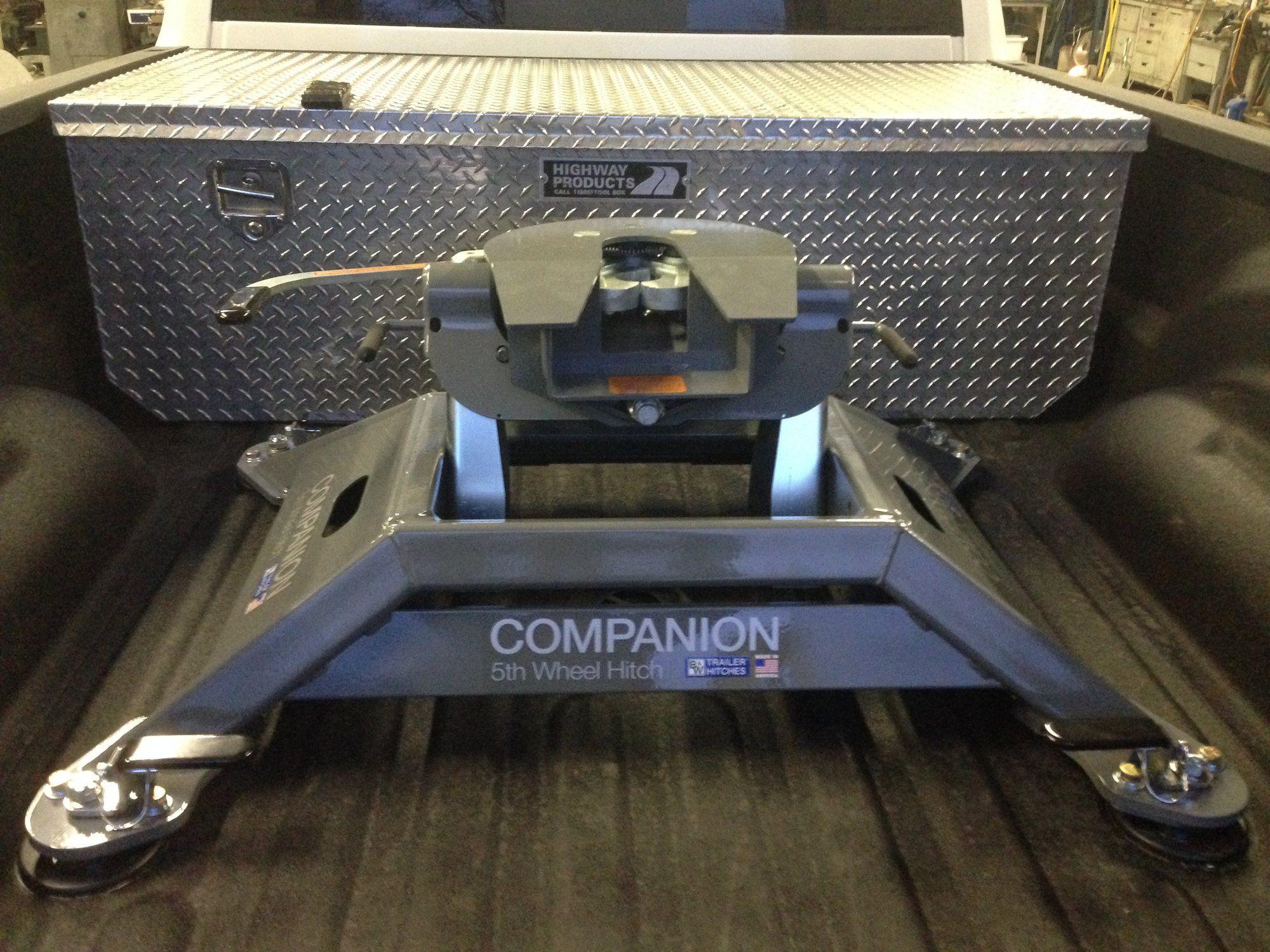

For the money spent and loss of storage space I will stick to my 30" front to back bed height HighwayProducts tool box and my modified 5 gallon can.

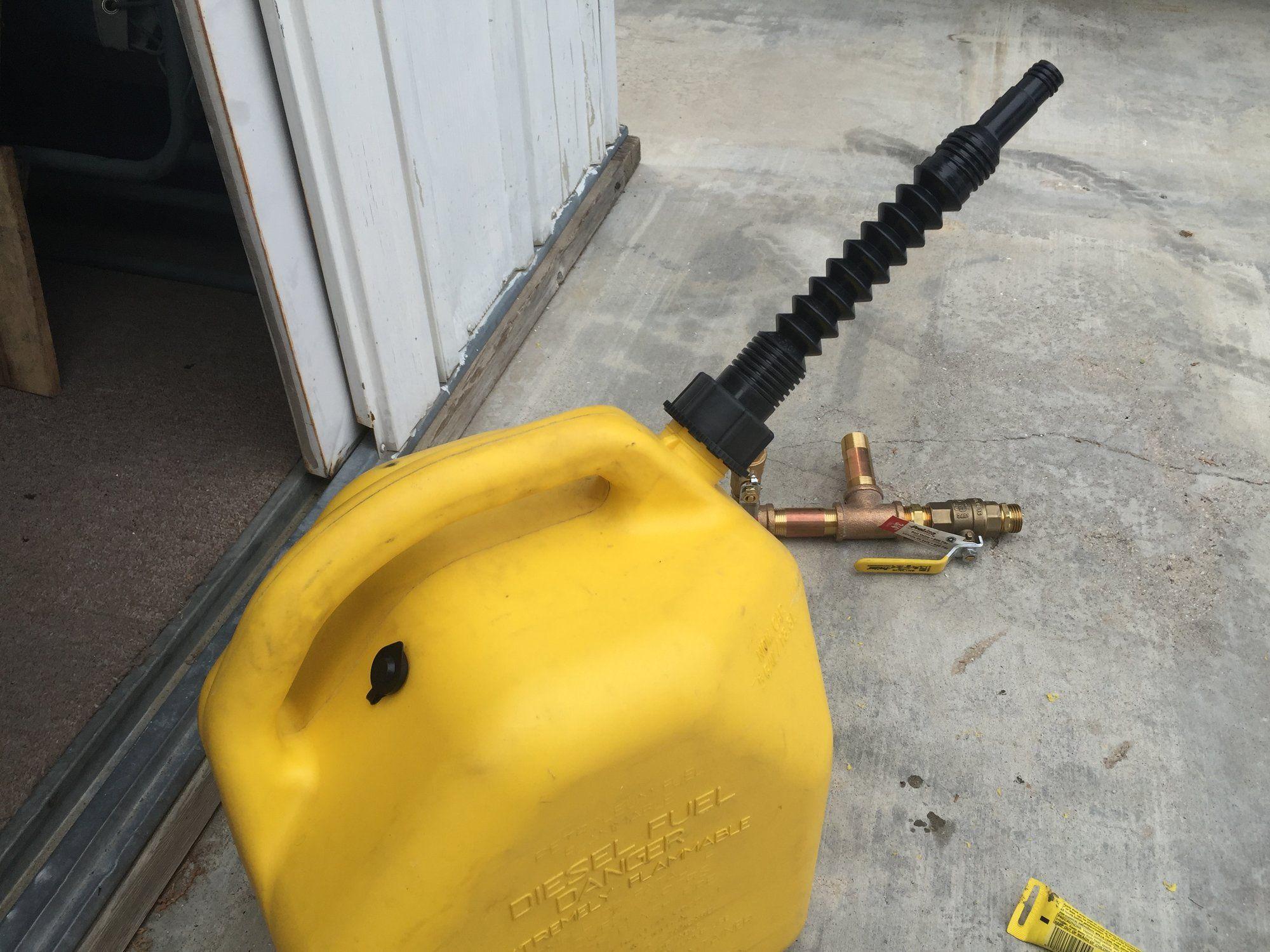

For your "modified" 5 gallon fuel can - what did you do to modify it other than the aftermarket old fashion vent on it?
What sort of funnel do you use to fill your truck? I've been thinking of making one out of PVC that will hopefully stay put and fill faster than anything I can buy. I did that for filling the camper water tank and it works great - just no sure if Diesel will quickly affect the PVC. The I also have the problem of where do I store the funnel after I have diesel on it.

Look at the picture, the nozzle is old school along with the vent. Both pcs are from AMAZON. I keep nozzle in plastic bag.
