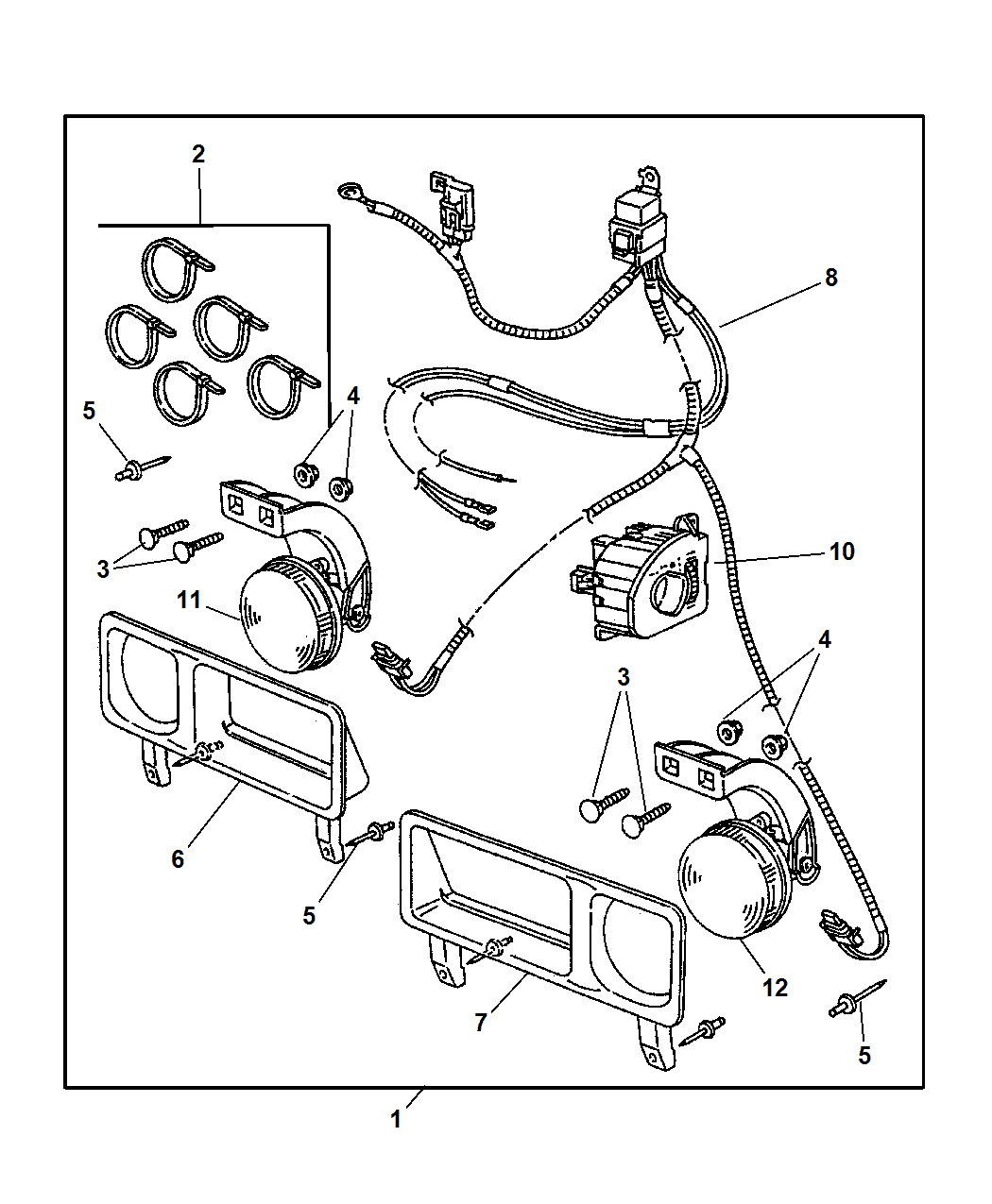

There is a kit for the full fog light install from Dodge, part number 82205656 but it is discontinued and I have not found it in stock at any mopar dealer I have checked.
I believe the switch was the light switch. If you pulled it out it turned on the fog lights. Have you tried a junk yard for the switch ?
You have any specific info on this upgrade?
Only that Dodge used to sell a kit with the wiring harness, factory interior light switch with push pull button. The factory eschuton that goes in the bumper
is included also. If you google Dodge part number 82205656 and look thru the links, you can find the factory parts drawing on what is in the kit.
Genos sells the switch with the fog light option as well as the lamp assemblies.

however perhaps a place like Dorman or LMC truck has a replacement harness. You could always wire them up independent of the oem switch and just have a toggle/rocker switch for it separately if a harness cant be found. I may very well be wrong on this (and the parts diagram certainly shows different as well ) but I thought the plug for lights went all the way to underneath the radiator and all you might need for a harness is to get from the plug to the lights

Do you have any idea why the lamps will not fit the stock fascia panels? The OEM Switch is available on ebay new and the OEM fog lamps themselves are available at Dodge parts, but very pricey at $90 each.
I have read in other posts that there is a connector under the radiator to hook up the dual fog light pigtail. That connector is present on my truck. This information does not jive with the head lamp wiring diagram in the attachment below. I have seen similar wiring harnesses on Ebay, but not sure how compatible they may be.
