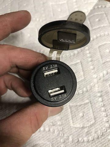

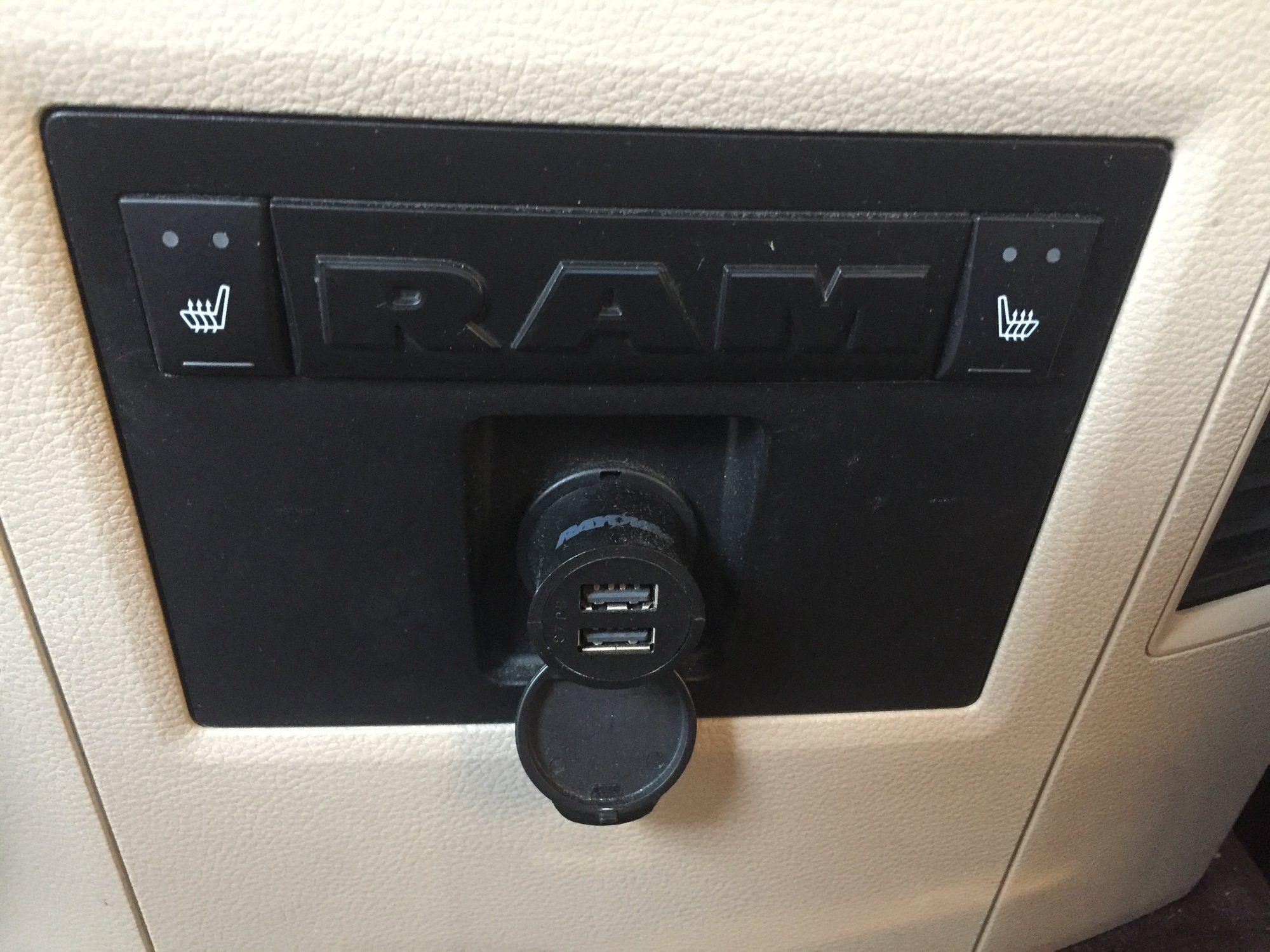

I grew tired of my kids reaching over the console to plug in so I decided to add a rear USB port to the back seat. Not only would it lower my BP, it will surely extend the lives of my kids and their friends. I have the Painless fuse block already mounted in the engine compartment. This is what will supply power to the port; completely avoiding the Ram electronics.

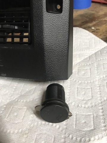

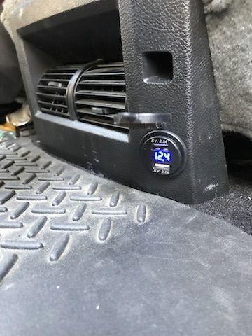

I plan to mount the port in the (worthless) rear seat A/C duct cover that supposedly cools off the rear seat passengers. If your listening Chrysler, you're doing it wrong.

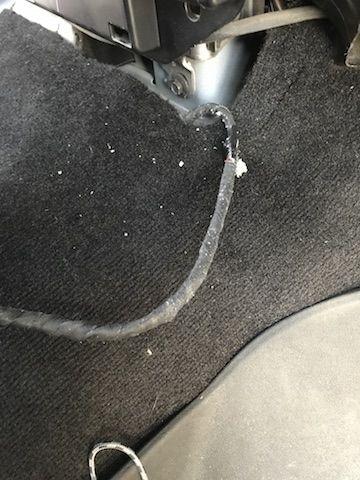

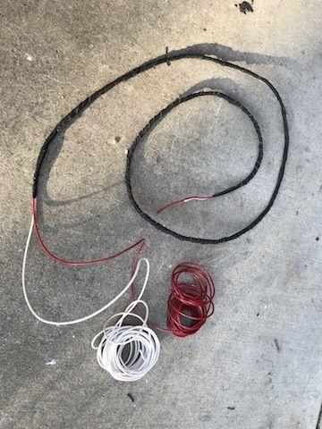

So I started by making my wiring harness to supply the voltage to the port. Back in the day, I use to run 12 gauge to any accessory, which in most circumstances was overkill, so this time I stepped down a notch and ran 14 gauge wire. After all, my goal is to accomplish is keeping an iphone or iPad charged so that I don't leave my children at some lonely truck stop.

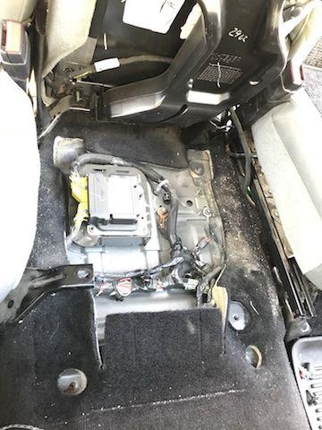

My plan is to route the wiring underneath the carpet from the dash to the rear seat underneath the center console. Once I was able to figure out how to remove said console, I noticed that my homemade harness would be rubbing against metal, plastics and other stuff so I wrapped my harness in heavy friction tape. Sometimes I use the corrugated wire loom but in this case, the wire loom wouldn't fit. ( tomorrow I'll add more details about removing the center console)

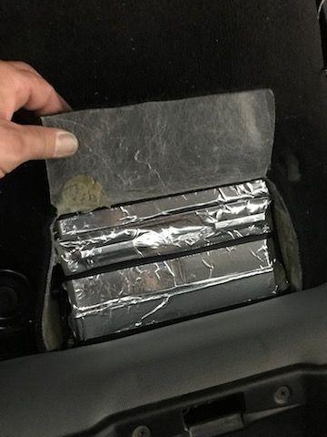

As I mentioned in post #1, the rear seat HVAC sucks. From some recent reading, I learned that if I slightly choke off the front HVAC ducting, it will force more air to the rear. Apparently, the single fan used to force air into the system isn't quite up to par for rear passenger comfort. Perhaps a secondary fan of some sort for the rear cab would mitigate this problem.
Upon removal of the center console, exposing the duct system, I saw a very flimsy and loose ducting system to the rear seat. I was hoping to find an "Ah Ha" cure all to make it flow better but no joy. In the end, I used some residential HVAC metal tape to seal the duct connections. I doubt it will improve anything but it made me fell better by making an effort.

I got everything buttoned up but I forgot to take pics of the nuts that need to be removed to pull the 60/40/60 center console. It not the worst thing I've removed, however it was more work than I anticipated.
I bet there are other places to mount a charging port in the back seat. This was the only spot I saw the was both easy to access and had a flat surface. I don't like the constant illumination of the port I bought so I'm gonna replace it with one that doesn't stay lit.
