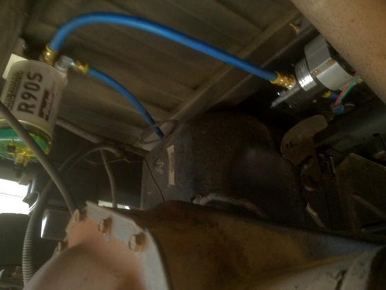

i have something to say about all this. First of all 2013 Ram Has 2 Filters. Second the fuel is full of emulsified water,that 90%of filters DO NOT filter. We have been doing a additional pump and separate filter in conjunction with factory filter for 5yrs ,with no I REPEAT NO Repeat Injector Failures. I done a ton of research on this matter. We put the best pump IMO with the best filter. We use FASS 90gph with the Racor 690 unit with a 2micron filter on the suction side. we did 86 of these units last year alone. The problem is fuel volume, the #'s the racor engineer gave me was as follows.
. 18 GPH x HP to Sustain = Total GPH needed
Example . 18GPH x 300HP= 54 GPH
Now we have tested the Dodge factory lift pump @32-36 GPH before the Filter
Chevy is @ 24-26 GPH
Now what this means is when you are trying to SUSTAIN 3/4 To MAX HP Your injectors are not getting enough fuel.
I realize that cummins numbers are lower but we have tested and found better economy towing and less power loss on hills with our GPH ratings.
Another important aspect is 2MICRON SUCTION SIDE filtration. The tolerances inside injector is less than 4micron so why would you put a 7 or 10 micron filter on it. The emulsified water is why you see pictures of chevy injectors full of rust on the Dodge the feed tubes partially plug.
There is a TSB 14-002-10 From chrysler that is doing the same thing with pump and filter of sub par standards. It is titled Heavy Duty Filtration.
Also on another note Chevy in 2011 went to Racor filters factory because of their Aqua Bloc media that stops 99. 4% of emulsified water.
So to think that the manufacturer is looking out for you is silly ,they make more money on parts than sales of new vehicles. IMO It is your iob to educate yourself to help protect your investment. Injectors on the 6. 7 started @ 2000. 00 Ea and now are at 1200. 00 each so wake up and smell the coffee.

first the airdog, fass and raptor are very high failure, hyped un needed junk like the K&N and afe. the filter set up in my post, the filters are from big cat and cummins big engines. the engines are sold by the millions and that is why the filter cost is so low. the first filter is a true water seporator with a 10 micron filter, the second is a cat ir0749 2 micron cross refrence filter. the dirt holding capacity of each is many times the factory one. the stock filter does not even need to be in the housing but i like for it to be there as a last line of defence. as i stated i have two or three trucks that has never had the stock filter changed. next there is not even a tenth of a psi drop noticed across the filters. on cr trucks from03 to the dual element filter series you need the filtering. this was a chrysler screw up. kkelley the filter media has holes in it varying in many different sizes, the larger holes has less restriction to flow than the smaller ones. thus the larger holes fill up with dirt faster forcing the fuel to flow through smaller and smaller holes. filter manufactors have ratings on new and end of life filtering, it is not uncommon to see end of life filtering 2x better than new. if you buy a new peterbuilt, in the service manual it clearly states to not over service the air cleaner for this reason. you are throwing a 2x better filter away than you are putting on. all of the cat equipment i own has a gauge to show when to change the fuel filter. and every class 8 truck i have has a vacuum gauge on the dash to show when to service the air cleaner. add a gauge and when the psi drops from about 8 psi to about 2 psi unger load, it is time to change. this not only gives way better filtering it saves a huge amount of money. in small quantities the 33406 is $13. 61 and the 33674 is $12. 19
