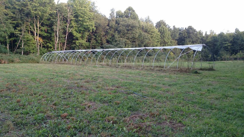

We are selling one of our greenhouses. After turning down a couple of offers on the condition that we (I) transport it, I have finally succumbed and agreed to take it down and deliver for an additional $200 on top of the selling price of the greenhouse. The one thing I am concerned with is the transportation of the actual hoops. They are nearly 9 ft tall (102" to be exact) by 15 ft wide. Too wide to lay flat on my trailer not to mention there are too many hoops and they would never survive the 90 mile mostly freeway trip that way. So I'm thinking about building a "cradle" so to speak out of lumber and transporting them vertically.... upside down. Similar to how I've seen trusses hauled. Lay them side by side (vertically) in a cradle which I will fix to my wood deck and then secure them to the cradle by sandwiching them with another board which will be screwed directly to the frame of the cradle. Hope that makes sense? I can add ratchet straps for security if necessary but I am pretty certain I will not be able to rely on them soley for this job. I'm a little ways out from the delivery date so I'm not in a hurry yet and just looking for any other ideas or thoughts I might be missing at this point. I'm pretty sure there are. :-laf
For reference here is a picture of the greenhouse and the hoops in question.

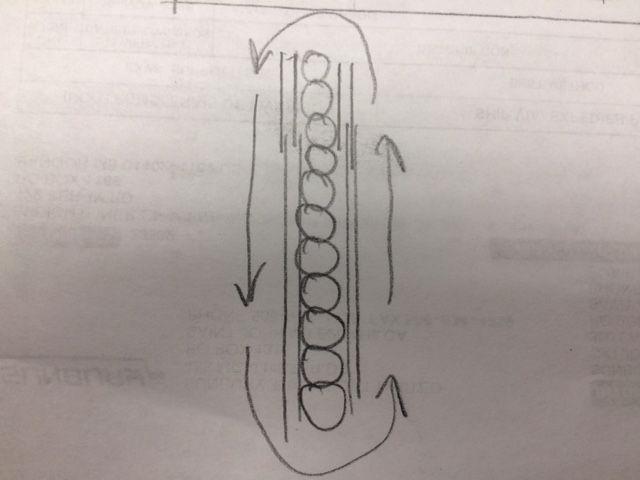

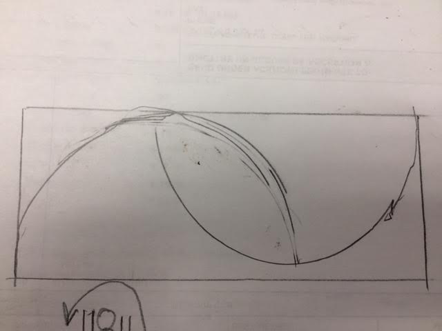

All good ideas above. I was a professional (?) flat bedder for years, hauled a lot of strange stuff.
This is what I would do.....
Boards first, create a 24' floor by laying them end to end on the deck making one thin layer. Strap the boards down. Then lay the hoops as shown. You might be a hair over 102" and you will have 2' of overhang. Good load for first thing on a Sunday morning.
Use stakes as needed to lash to. Create several containment devices as shown below using 2" X 4" s and either banding or small ratchet straps. Make a quickie form that you can move to hold the pipes in place until you get the device tight. Repeat three or four times per bundle. Doing it this way will give you one stack that is 13 tubes high and the other will be 12 tubes high. Strap the now contained hoops to stakes as needed.
Just my thoughts without seeing it....and no, I'm not a artist. My coffee cup handle kept getting in the way while ATTEMPTING to draw the hoops......:-laf

Beautiful Mike, much appreciated. I think that's how I'll load it when the time comes. It will be a few weekends from now but I'll let you know how it goes.

those drawings are what i was trying to describe. see pictures are SOO worth it.
now with the second pic. take and make say 6 of those 2x4 on end cradles, each end of the hoop, and one in the middle. the bottom could be a simple piece of plywood.
to strap it down, if you don't have enough tie down spots, wrap the strap around a 2x4 or such, and screw it to the deck of the trailer.
"Those drawings are what i was trying to describe. see pictures are SOO worth it.
to strap it down, if you don't have enough tie down spots, wrap the strap around a 2x4 or such, and screw it to the deck of the trailer."
