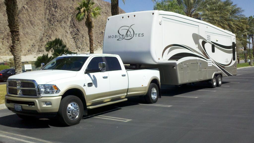

If the head lights are looking for UFOs in the sky, me thinks the rear axle is overloaded. Pictures??? SnoKing
I get flashed ALL the time with my truck in ALT ride mode with factory rear air ride.
If truck looks like this with load leave it alone. If rear is significantly lower in the rear add bags.
