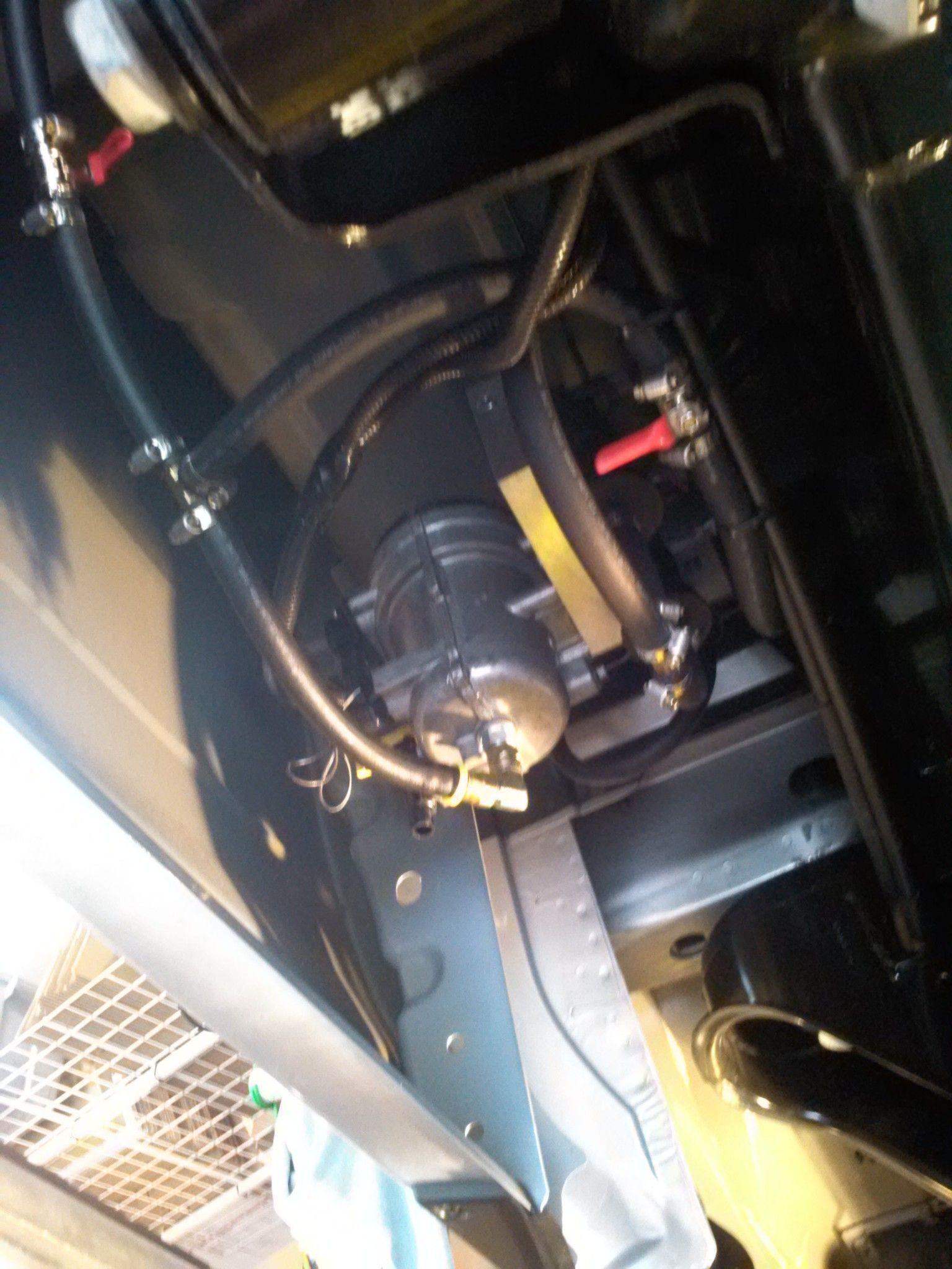

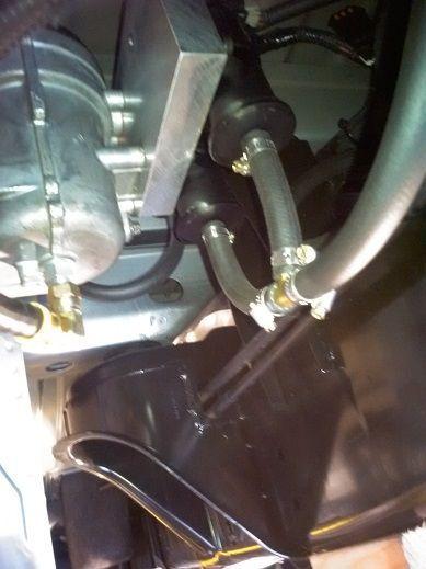

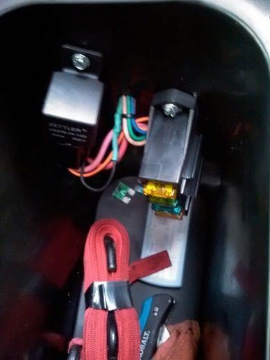

My in tank failed at 213 Miles ( Yep the 1 in a million) Those aftermarket setups work but their not even close to the best... I make My own and if you have the skills your much better off with custom built system. The system in the picture can be used for Bypass Filtration with fuel heating intact, It will act for back system if in tank fails. The Truck Now has 3 Pumps for use if anyone fails. It has in cab On/Off and is ignition activated VIA hot wire to in tank pump.
