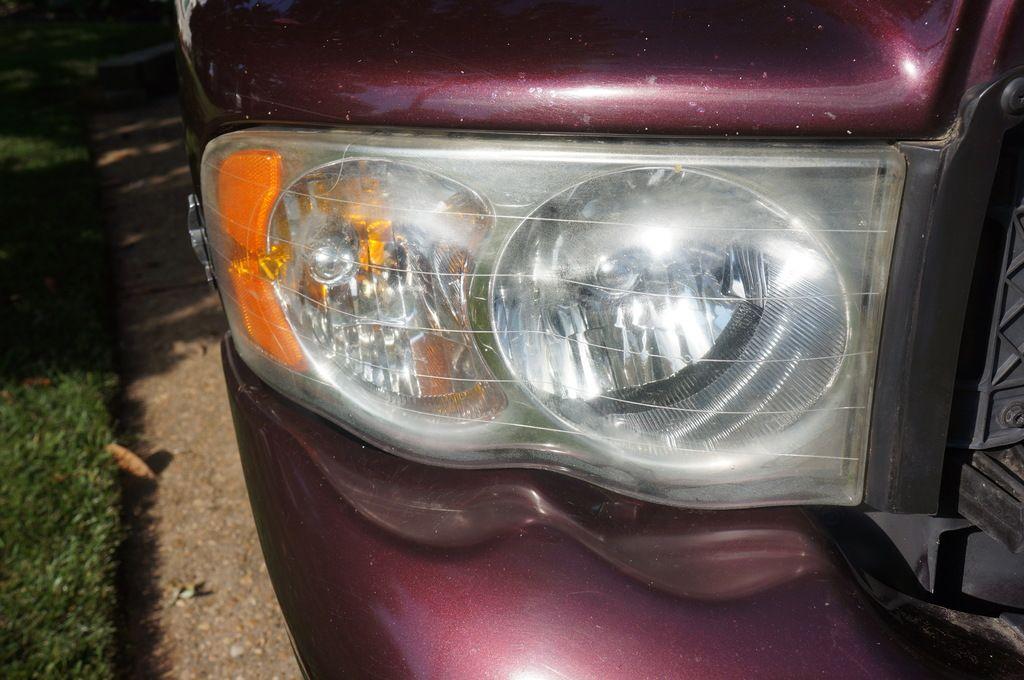

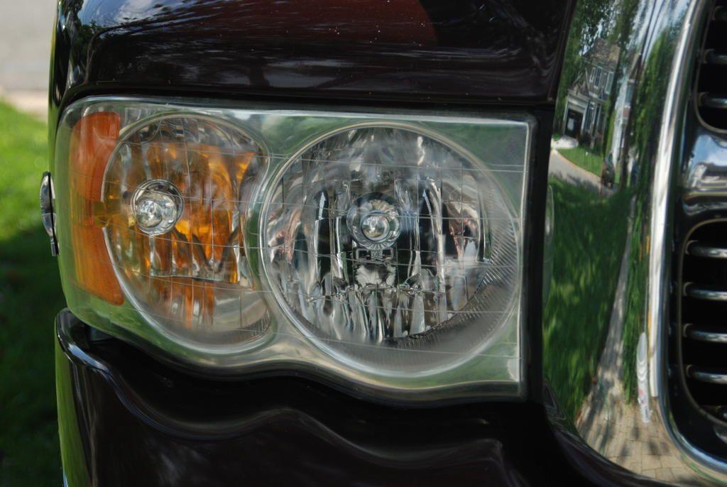

So, I finally decided to replace my factory headlights. It's been a couple of years since I buffed them out, but they seem to have degraded again. Here is what they looked like after buffing and polishing them in June, 2015:
Here's what they looked like in June 2017:

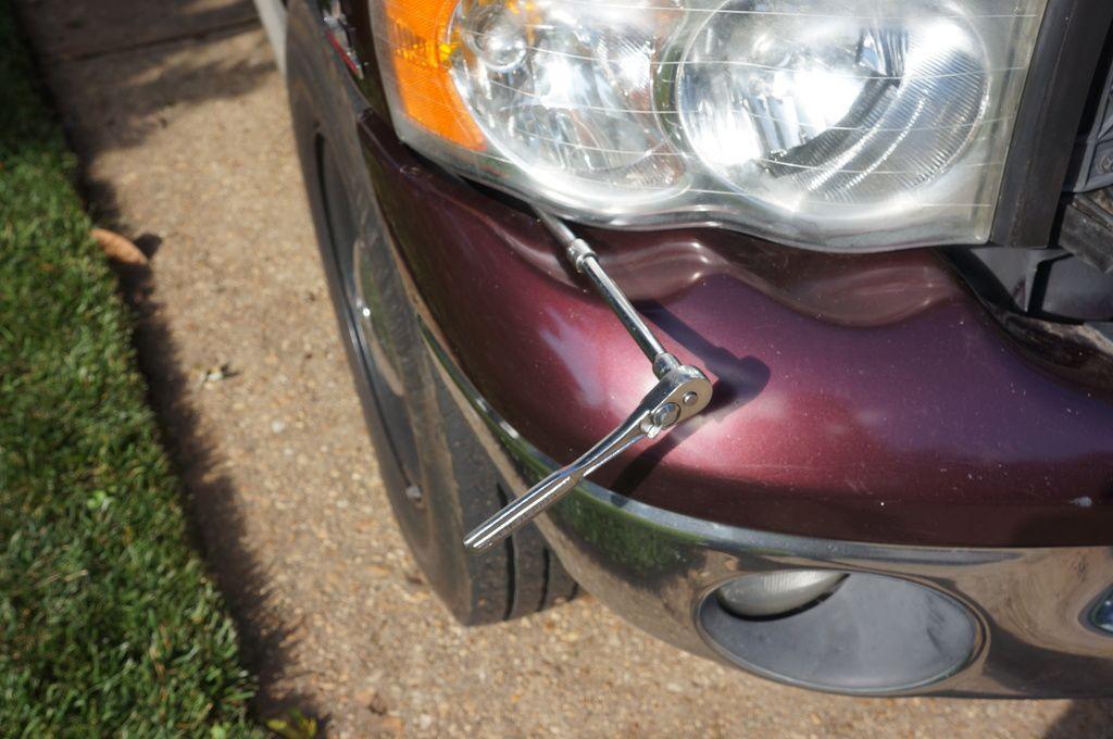

It was rather easy to get the old ones out. I chose to undo the bottom outside bolt from the front with a socket and extensions (in need to get myself a nice long ¼ inch extension for things like this):

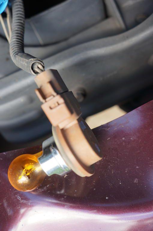

The next issue was getting the wiring transferred to the new light. The original light had the electrical plug directly on the light socket; the DEPO light has a pigtail socket, giving you an extra six inches of flexibility. However, on the first light, I broke off both of the locking tabs on factory plug (sorry the right part is not what the camera focused on):
The plastic was very brittle (it is at least 14 years old now) and I wasn't quite as careful as I should have been. But I just wrapped a zip tie around the two connectors, so it won't come apart.

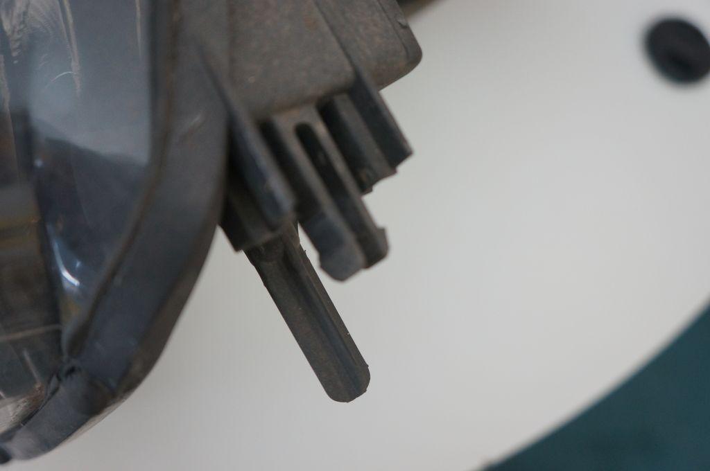

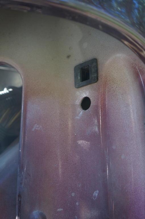

It turns out, the original lamp has an alignment pin and a retaining clip on the top outboard edge.
I had verified that the alignment pin was lining up with the round hole, so I figured the retaining prongs MUST be aligning with their hole as well.

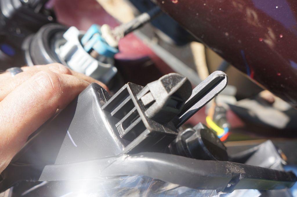

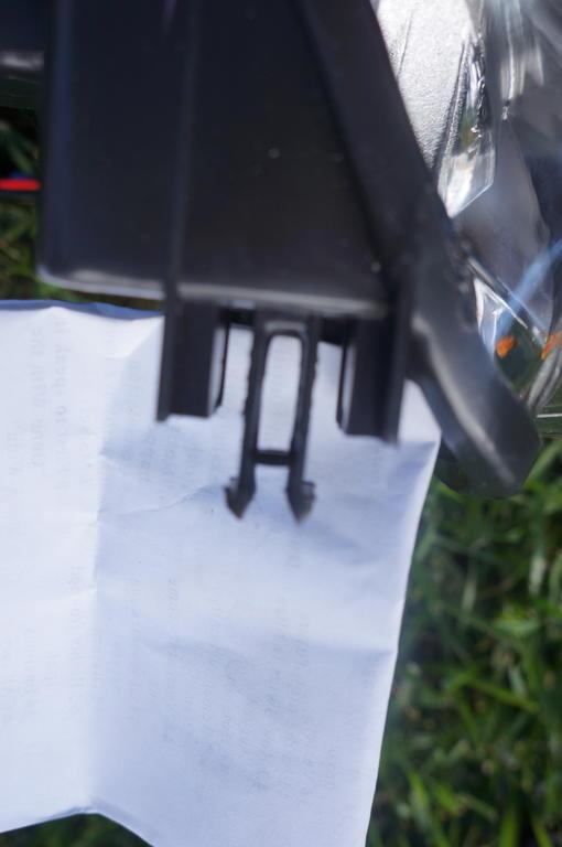

Well, they were aligning, alright, and that was where the problem was. I really couldn't see what was going on very well, as once the lamp is in far enough to jam, you can't see these pins. But then I realized, that the retaining prongs were way too big to fit into the tiny plastic plug.

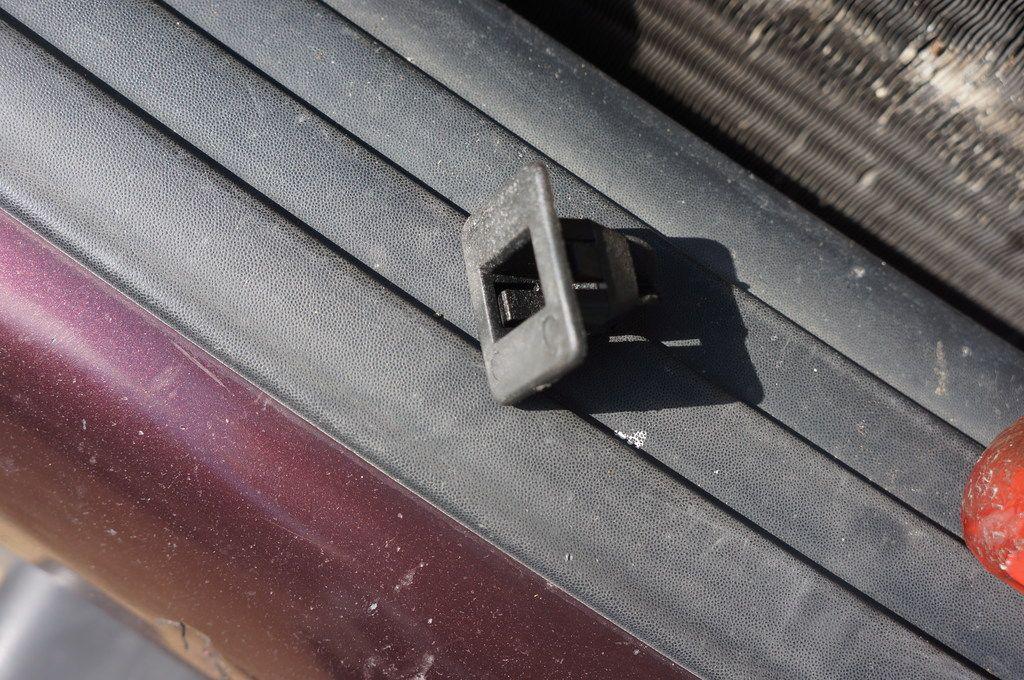

Upon further inspection, the new lamps also included a new plug for the retention hole, and they had attached it on the retaining prongs.
Once I took that off you could see that the DEPO lamp has a slightly different retaining prong design, but I just left the old plug in the fender anyway, and it fits just fine.

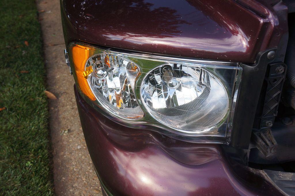

Now the lamps fit perfectly. This is what they look like now, hopefully they will stay that way for a long time:
Overall, I am very pleased with the new lamps.

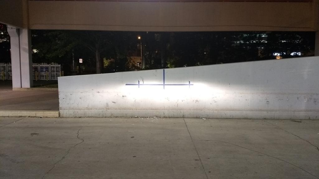

So I finally got around to aligning the lights and driving at night. I don't have a good place to do alignments, so I drove over to the Home Depot and used one of the walls in their parking structure. Just like the stock lights, there is only one dimension of adjustment, up and down. The adjusters worked smooth as silk. The left/right alignment is OK, I still need to lower the left one by about 4 inches or so.
Driving around, they seem to be at least as good as the stock lamps, but for some reason they do seem to be a bit brighter.
Thank you for the follow up. The lights do appear to have a good pattern on the test wall. It seems that they would light the roadway evenly without dark places.
- John
