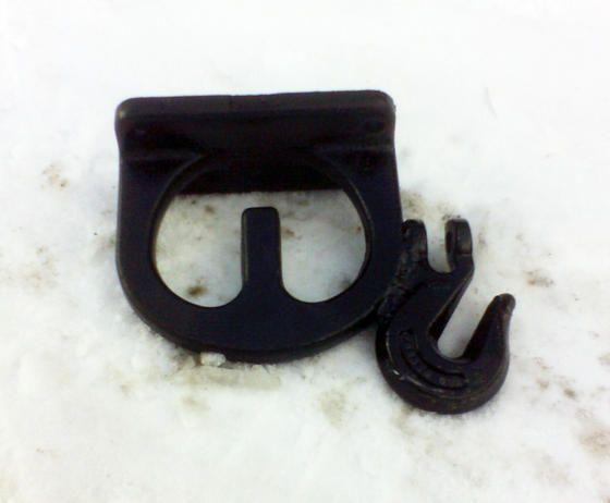

Yeah... have to see how tight it is up there. Might be easier to just weld a chain hook on each side of those Dodge rings. That way a chain could be hooked on the hooks, or a strap could be put through the center.

I had ordered the OEM hooks several years ago, but never installed them. With the clearance issues of these hooks, plus the fact that they most certainly will be used on a regular basis, I decided to weld chain hooks on the side of each hook. I used American-made forged 3/8" hooks.
Installation went pretty good. I did not need to take the bumper off, but I needed to take the bolts out of the intercooler and pry it forward a fraction of an inch to clear the two bolts that go through the front of the frame.
At first look, it appears that the tow hooks could just be bolted in place, but for strength, you must use the provided brackets and install them next the existing bumper brackets. I did one side at a time and used Vise Grips to keep the bumper from moving while I did the other work. It was kinda tedious, and I needed to use about a half dozen different end wrenches and sockets to work in the tight places, but it all worked out.
