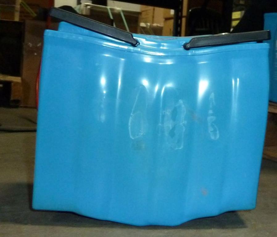

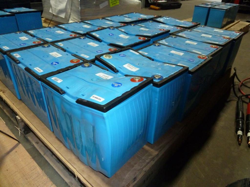

we see these type of issues, these were minor and caught in time...

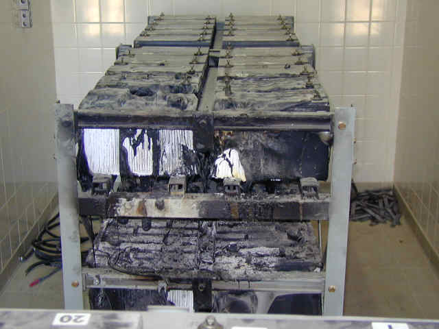

when not caught in time, we see things like this.. (not my pix, found on the web, but looks like sites we've walked into)..
