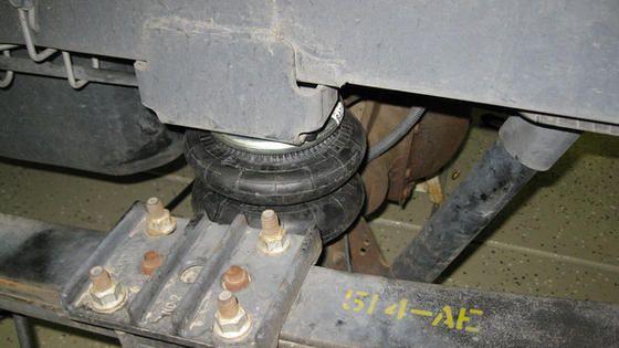

First set was the Firestone Bags. Ride Rite 2299 no drill bags with the Standard Duty Dual Command.
This went on my 2006 2500 4X4 short box Quad Cab. The install was pretty easy and it was truly a bolt on install. Careful routing of the air lines is necessary to keep away from pinch points and the exhaust. I used the clutch blank off plate to get everything into the cab.
The Firestones would lift the back of the truck ~ 2 1/2" inches when inflated to 80 lbs empty and had no problem leveling my 27 1/2 foot toyhauler at 60 lbs.

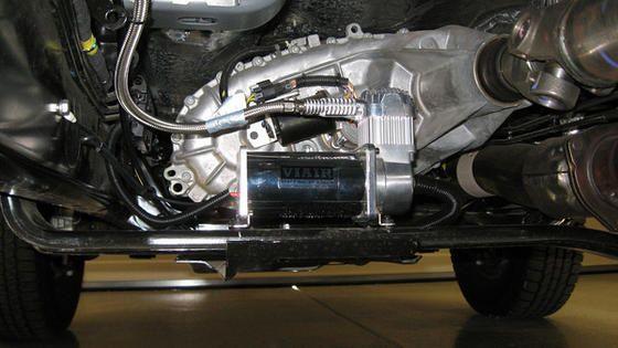

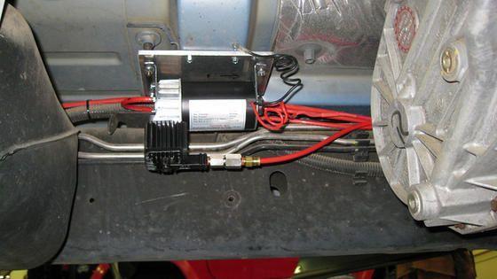

I moved this to the frame due to the noise but you get the idea.

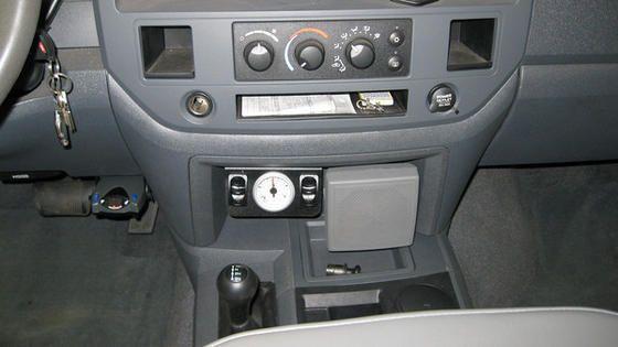

and the control (speaker was for my ham radio)

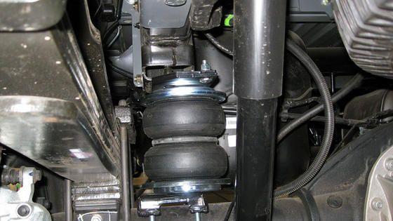

The bags. The grey bracket is the B&W Goose Neck.

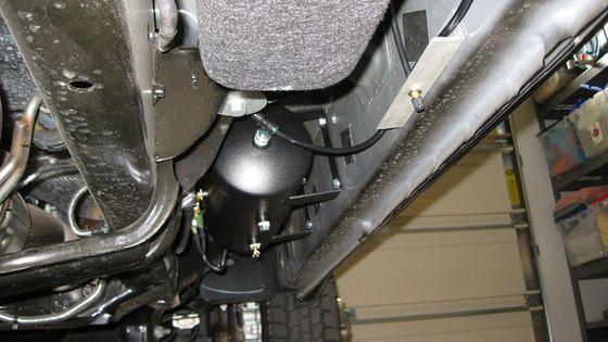

The Air Tank and air access point

Nice write up. From the looks of the load Lifter (Air Lift) kit I think that is the same as the Pac Brake kit.
Bob, I had a Pac Brake that I installed on the '06. The tank that came with the Pac Brake was less than 1 gallon and the compressor was less than a 100% duty cycle. This was about a 2 gallon tank and I upgraded to a 100% duty cycle compressor.
I'd sure like to mount the compressor under the hood but the 6. 7 has no room for this size.
I noticed your Air Lift air bag sits off set on the bottom mounting bracket on the axle. The Air Lift air bags on my '03 dually fit in the same manner. After about 30k miles of hauling a heavy slide in truck camper over rough highways, the base plate on the driver side air bag bent throwing the air bag out of line. If I had continues using it, the air bag would have failed. Hopefully, you won't have the same problem.
Did your previously owned PacBrake air bags mount offset on the mounting bracket in the same manner? I had thought about trying PacBrake air bags. I still have have the Air Lift on board air compressor and in cab controls/gauges.
Bill
Bill, the previous bags were Firestone and no, the lower bracket fit the entire base of the bag.
