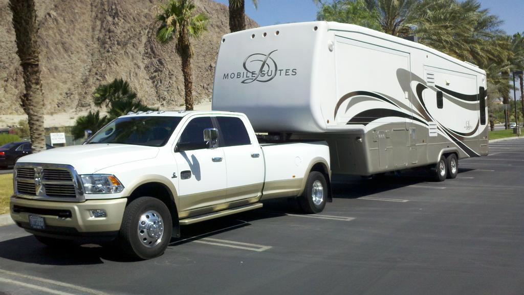

Unless you are adding well over 4,500# I would not even consider bags unless ride is an issue and you say it is not. 4,500# pin in pic and no bags. i did add bags and bilsteins for ride improvement. If your truck sits level as in pic I would do NOTHING!

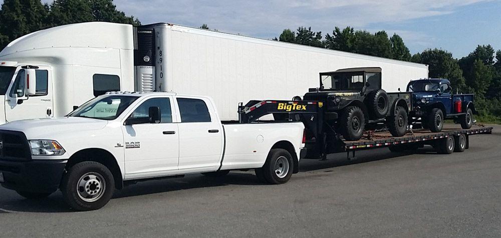

In the mean time, move your load back and or switch the blue truck to the front, it looks lighter than the grey one. You have some serious pin weight loaded as is, maybe as much as 7k, if that grey Power Wagon weighs 8k.

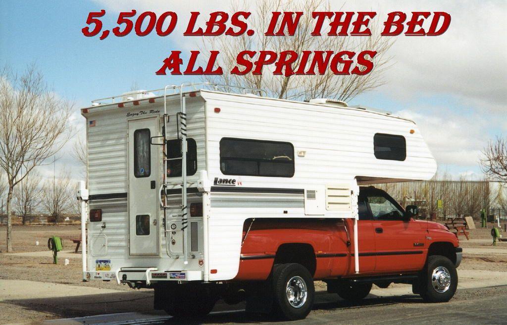

See this post regarding Aux. Overload Springs. Photos of spring pack shown in that link. I've done them all trying to fix weak spring packs, swaying in high winds, and droop in the rear putting the bumper on the ground, and these OL spring packs work the best. Any competent Spring shop can do the work. No hastles with rough ride empty, air line leaks, ETC.

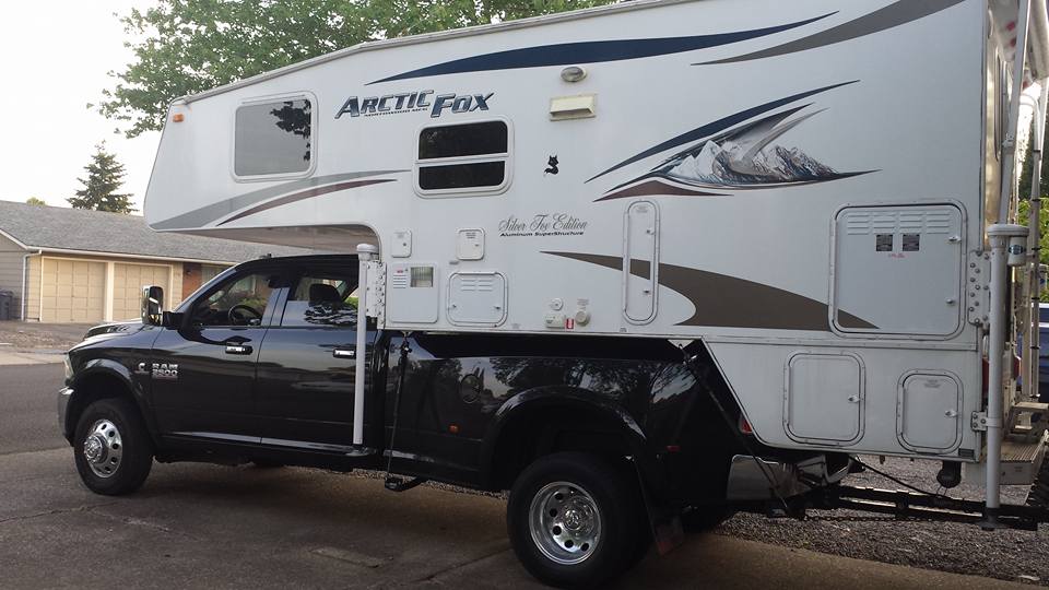

If you tow almost all the time. SuperSprings or spring shop add-a-leafs are great. My truck with Supersprings with a fully loaded Arctic Fox 1150 Camper. I love this setup. Works great for towing my toyhauler too.

I owned a trailer like your using... just a different brand... I know our axle location was more forward on the frame than what is on your BigTex... it was more like 60/40..... yours looks more like 70/30.... when we towed... we almost always sat level... we had (2) 12K lb disc brake axles... and were often over 20K of trailer weight...
jelag -- Sort of ... :) I've been doing mainly local hauls instate (MD), for about 18 years as well as driving a big truck part time for a buddy. Now and then, I run interstate (why yes, I have an unrestricted Class A, current medical and a DOT number, thank you for checking ;) ) I plan to expand my operation in a couple of years when I retire from my day job. I have an annual run I make to NOLA -- I get paid to go to Mardi Gras, which isn't as much fun as you may think as it involves running this rig in 3 or 4 parades. If you know NOLA then you know what I face. I've gotten really good with this trailer ;)
