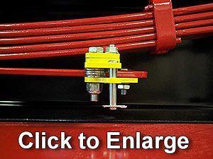

Have you checked out the Torklift Stable Loads? Once added to my 06' I use less air in my Pacbrake airbags. Before the Stableloads I ran 80 psi. Now 45psi.
