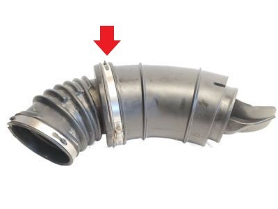

My brother owns a 2012 2500 truck and needs the large clamp on the air cleaner duct work. The smaller clamp is available from the dealer. In order to get the large clamp you have to order the entire ductwork according to the dealer parts counter. $$$
I cannot find a part number related to this clamp.
Any ideas on where to find this clamp? It has some special slots cut into it.

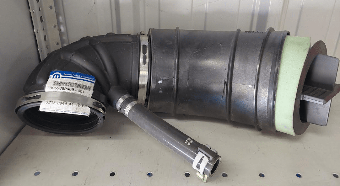

Well, I thought I might have one. We had to get that assembly for one of our '17 C&C 4500's just to get the soft boot. It's not the same as your pic. It has two clamps, but they're the same size. This is what I have left of it.
If it were me, I'd trim the rubber locating "knobs" off and find me a constant torque clamp to go around it.

Why does he need that clamp anyway, was it corroded? On my 2014 it corroded and broke (cheap Chinesium metal) and I could not source one so I had the whole assembly replaced under warranty. I am thinking a lot of junkyard clamps will also be corroded to some degree or another.
Same here, cut the knobs off, they are just for alignment at the factory.
Buy a 5$ stainless endless hose clamp that comes with separate locks and cut it to length. Perfect.
