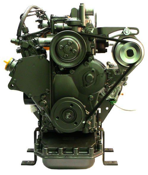

Don't know about fast recovery but dont want to wait around all day to change a tire on one of the 3 tractors FIL,BIL,and mine or the FIL bus and various other big tire removal and air jack to lift the above equipment tire repair. 1 inch impact going and others working in the shop with air needed is not uncommon around here. The BIL just bought one of the motors below its a 13HP but there are less HP models available he has it on a gen set that is one nice motor. The other is the compressor and the specs That motor would be way over kill but there are some others to look at that are single cyl that are 10 hp. just trying to get all the angles thanks

Ya Greg propane tank for the place is pretty far away to be running to the shop so if I did it that way it would require an additional tank at the shop. That could be ok for heat but I have my diesel fired heater that Gary calls a Salamander for that. That's why I thought I would throw out the question about HP. The motor that is pictured is to much for this just because of the cost factor alone. They do have an upright model of the same compressor so that is another option.
