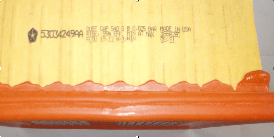

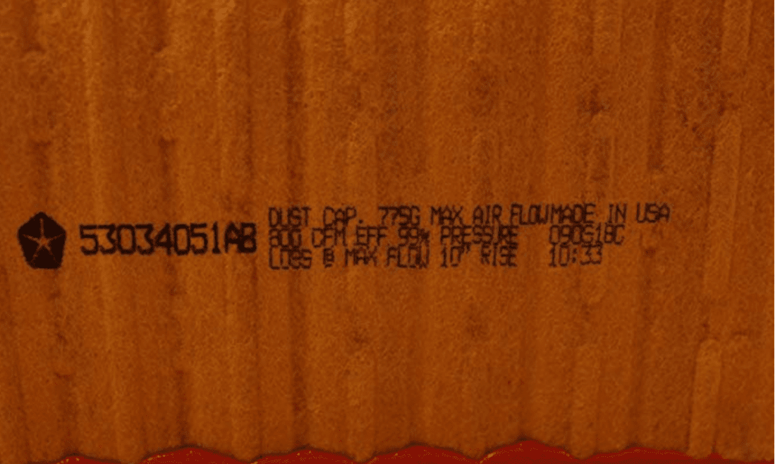

FYI--these upgraded 4" thick air filters hold OVER ONE POUND (546 grams by the Fleetguard specs) of dirt and dust and continue to filter the air ever more efficiently until they load up completely and it is time to change them.
Amazingly, the only slightly larger 6.7 CTD air filter holds a whopping n 775 grams of dust/dirt before it starts losing efficient flow and needs to be changed.
  • Like
Reactions: JR
For all of you non believers (JK/LOL) heres the proof...
or you can simply look at the side of your Fleetguard air filter next time you change it--
Seafish, I noticed the one say "at .25 bar" and the other doesn't specify. That may be the diff.
That well might be true, though IIRC the 6.7 filter is al title larger and has MORE pleats.
I would also tend to think that the .25 bar, if it is referring to max pressure loss, would be fairly accurate for both engines, though I am not at all sure about that.

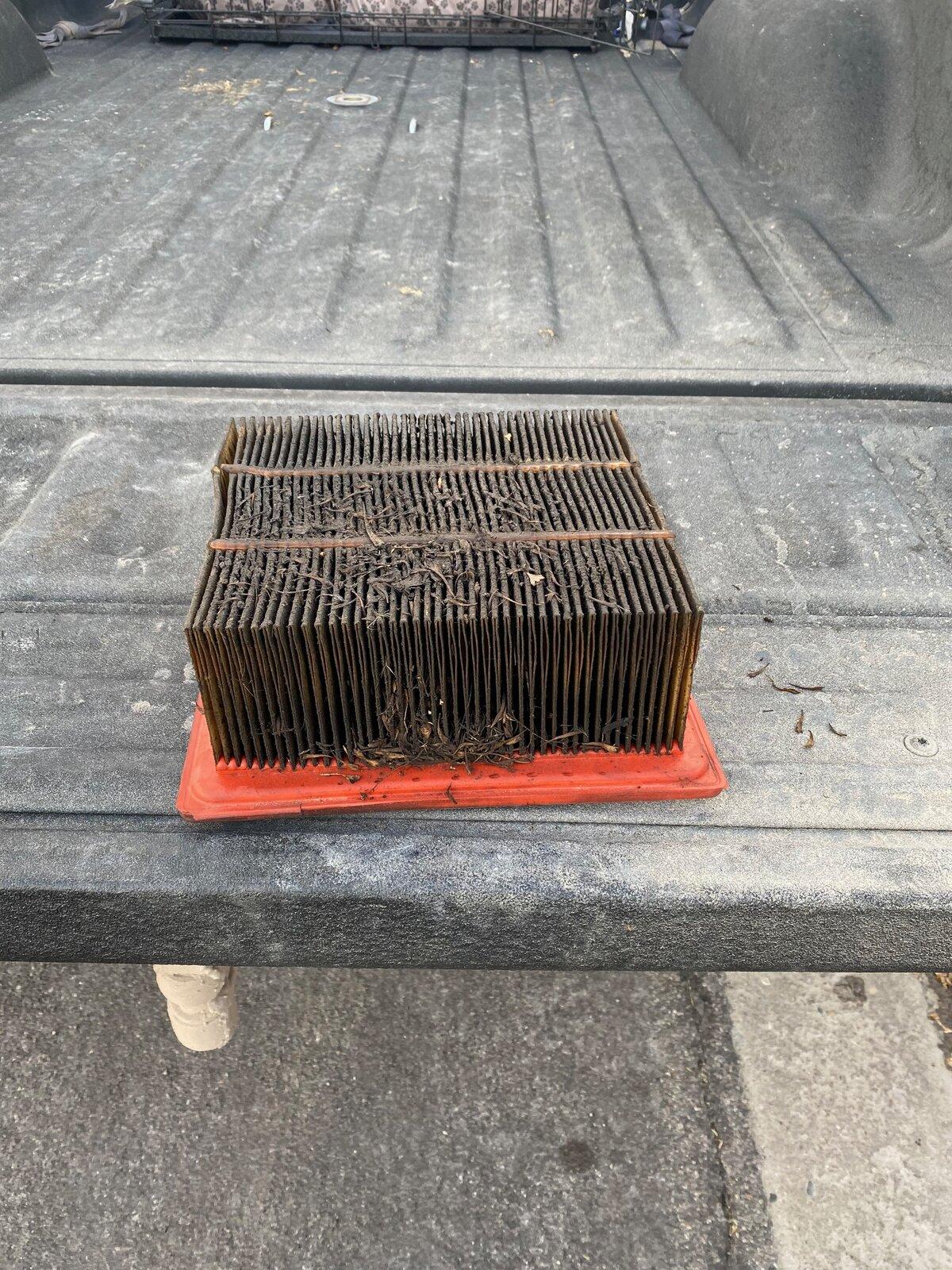

Here's a photo of my air filter that I just changed. I don't recall one this bad but still did not trip the filter minder. While I lost my turbo which affected performance the truck never smoked which I would expect if I had an air restriction. I have only had one air restriction on all the Dodge diesels I have owned (1993, 1997, 1998.5, 2006). I have to go back to my 1993 W350 12 valve. Coming back from a hunting trip truck started performing poorly and when I tried to push it there would be substantial smoke. Limped home and when I finally got to the air box was shocked to find that I had ingested a bird through the air filter intake and the feathers had coated the air filter! Crazy! We had no rain from June until November this year so the roads were very dusty. I too have the HD mod but from now on I'm capping it while on dusty roads. I'll open it back up on the highway.
Here's a photo of my air filter that I just changed. I don't recall one this bad but still did not trip the filter minder. I too have the HD mod but from now on I'm capping it while on dusty roads. I'll open it back up on the highway.
Thats a great pic of how well these air filters function!!!
If you still have it, you might do us all a favor by WEIGHING it and then also weighing the replacement which should still be in relatively new condition. Obviously you would ned access to a relatively accurate scale...like maybe take it down to your local post office in aplastic bag and then ask them to weigh each of them ?? LOL
The comparative weight would obviously tell us all how much DIRT the filter has protected your engine from while still functioning and we could compare to to the specs printed on the filter.
Whaddya think??
What is an am accurate scale? I have a Taylor 32 oz scale and just measured a new unused Mopar filter at just under 29.5 oz. I don't have the dirty filter here at the house but can get it tomorrow and report back. You are probably looking for a finer measurement I would guess.
Taylor is a reputable scale manufacturer and that the scale you have oughta be accurate enough ... the problem is that the the filter can hold up to 19 ounces of dirt and you are already pushing its limits with an unused filter at 29 ounces...which is already good to know because that means you only need to take the used one in a plastic bag down to your post office or local shipping office. LOL
The old filter weighs just under 34 ozs so around 4 1/2 ozs of material in the filter. If it holds 19 it doesn't sound like it was anywhere close to capacity and why my filter minder did not trip.
