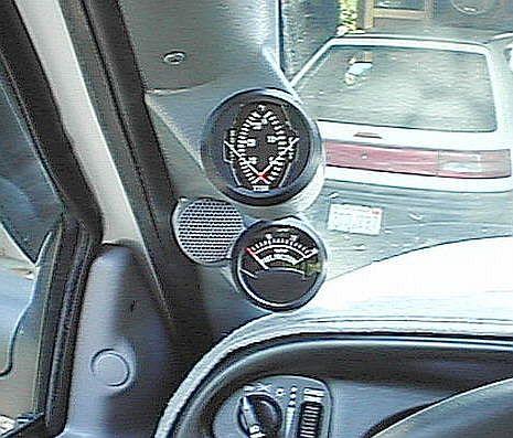

Lift pumps commonly fail, and while the engine CAN still operate, usually lack of lift pump operation can starve the VP44 for fuel - but usually creates an issue under load, not at startup... A good reason for gauges - I have gauges for exhaust temp/turbo boost, and fuel PSI at the VP44 - really helps to monitor key engine operating conditions, especially if the truck is worked hard... I use a Walbro lift pump with fuel PSI set at the VP44 of 15 PSI - never varies from engine idle clear up to full throttle towing 5th wheel up steep grades...
