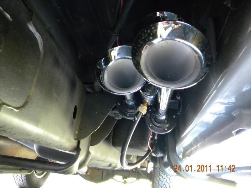

This picture you can see the small compressor on the right side behind the horns (which have a different air system and tank).

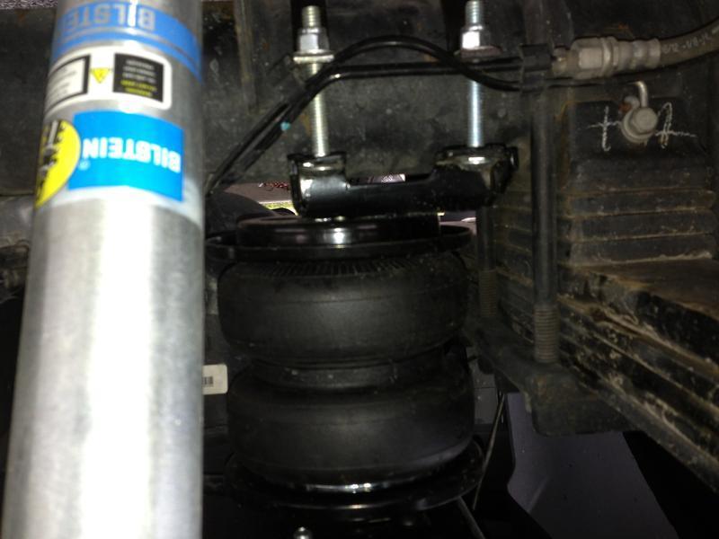

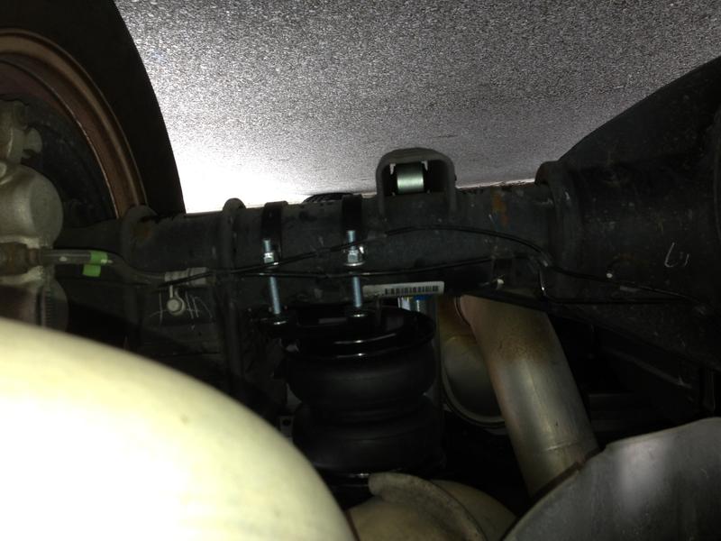

Thank you for all the input and handtools you are correct no drilling was required. Bags, compressor and wireless remote were installed last Friday. I have attached photos of the mount position of the bags which concerned me until I called Airlift and reviewed the install instructions. This offset is reported as proper and as designed for Ram 2500's and will not impact bag life or performance loaded or unloaded. Good to know and glad there is a lifetime warranty on the bag should the design prove problematic. Overall I am very pleased with the setup and really like the wireless remote.
