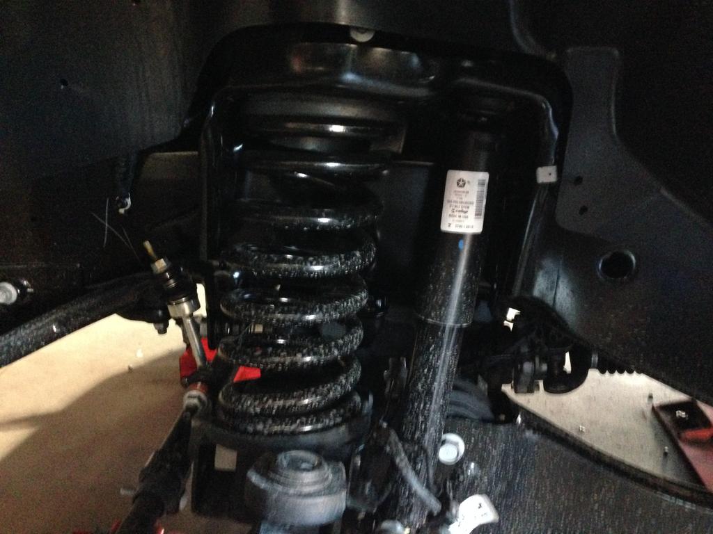

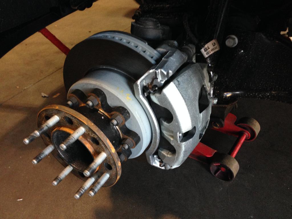

Why 80 in the fronts? I know that 6.7 weighs more than my 5.9.
Engine is not that much heavier but EVERYTHING else is heavier on the newer trucks. Just look at the front suspension. AISIN and BW T case are also heavier.
