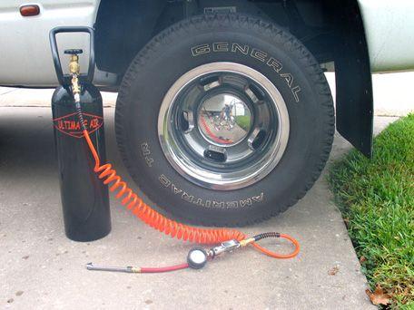

I use a C02 tank. The regulator is set for 150 PSI.
Newt

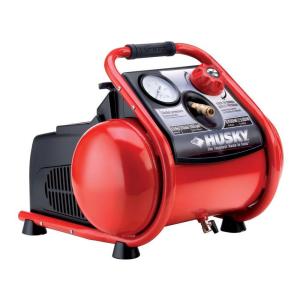

Here's what I use on my 125 PSIG 17.5" trailer tires. It fits in the truck's WeatherGuard toolbox and is good to 160 PSIG, IIRC.
Rusty
