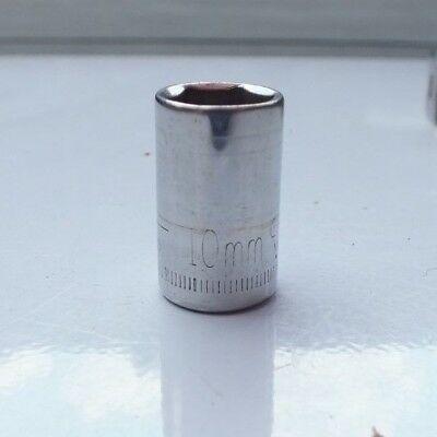

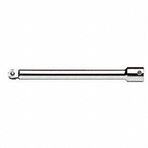

Ron and I dropped the Aisin pan on my 2015 and installed a new filter and 9 quarts of fluid. I had a 1/4" extension with wobble end and a Craftsman 10mm socket with a very thin sidewall. We were able to get to the 4 rear bolts on the pan that are sorta blocked by the cross member. Got a P0868 code on start up. Reset that and everything was fine after idling(and up idling) for a while in park and neutral before putting it gear.

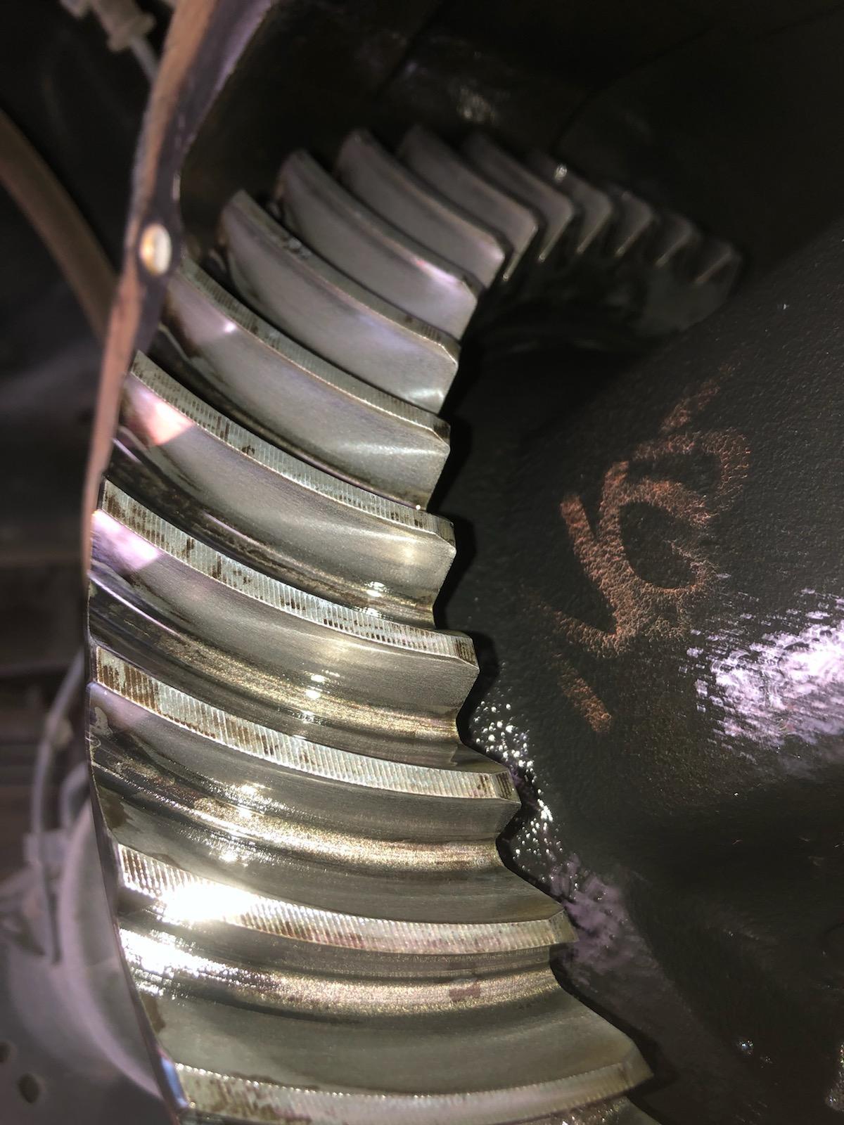

Picture of rear diff.
