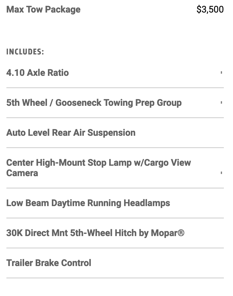

Not referring to the prep package, but the Max Tow Pkg. I don't need the hitch and don't want the DRLs.
MAX tow is MAX tow whether you get a 5er hitch or not.
Perhaps I missed it, but while the reverse is true, where does it say you get Max Tow by selecting 4.10s, and/or gooseneck prep? Not to speak for Wiredawg, but that seems to be the root of the question, "is there a programming/operational difference with Max Tow?".
