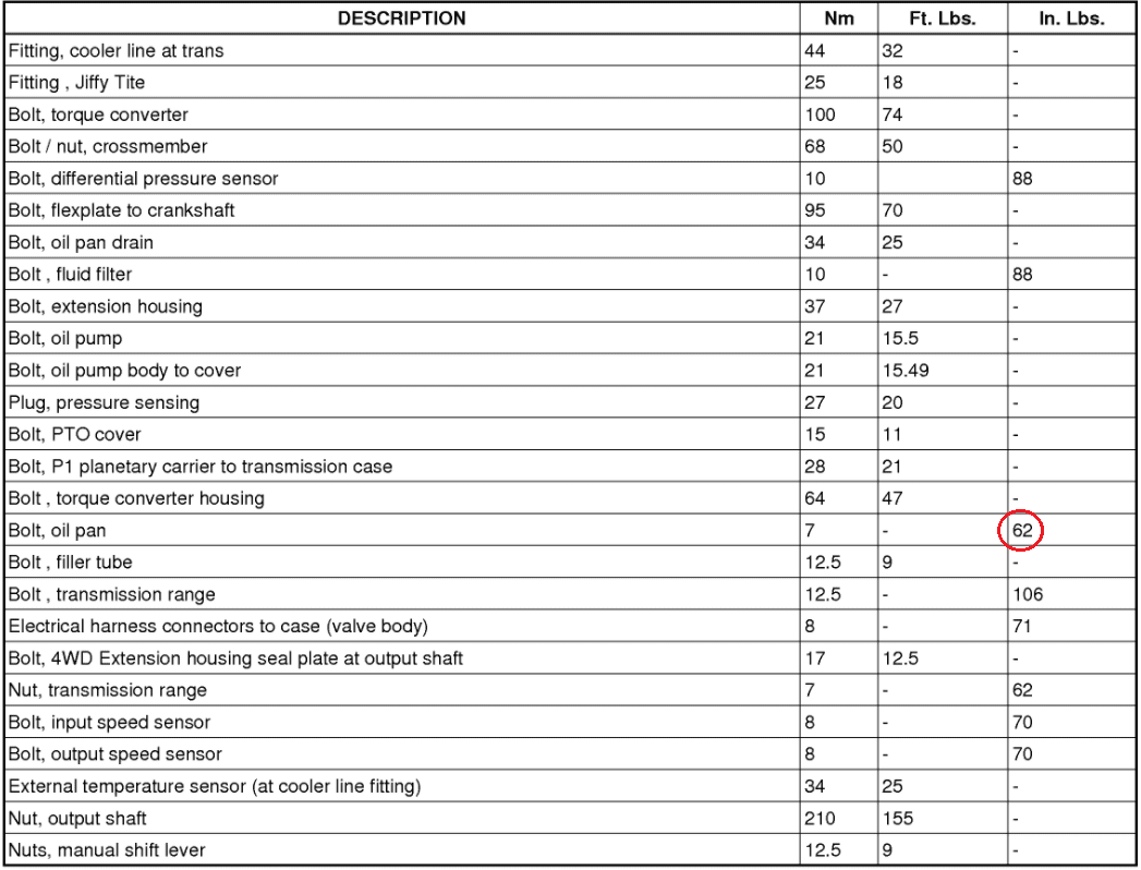

Here is the max. Torque for the M6 bolts.

Does anyone know the torque specs for the 10mm bolts on the transmission fluid pan.
This is a common mistake that I've never understood and it can get you in trouble. As Ozy mentioned, they are 6mm bolts, not 10mm. This doesn't happen with SAE bolts. Nobody calls a 1/4-20 bolt a 7/16" bolt or a 3/8-16 a 9/16" bolt. Standard torque for an M6 is less than 9ft/lb while an M10 is north of 40ft/lb.
