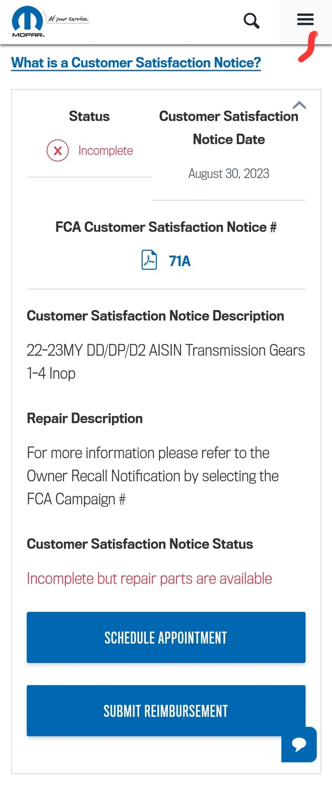

As a “new to me owner” I’m trying to understand if the TSB is for all 2022 3500’s with the AISIN? It doesn’t really say nor does it state specific serial numbers. Is this something they check proactively or am I supposed to use it till there’s a problem? Thanks.

It’s actually a CSN which makes you eligible to bring it in for repair, as long as it falls between the Mfg info provided in the CSN.
Are you referring to CSN 71A for the K1 snap ring failures?
If so, you can see if your truck is affected by inputting your VIN on this site.
https://www.mopar.com/en-us/my-vehicle/recalls/search.html
Got a winner on the 71A.
I would schedule it ASAP, the CSN fix is much better than a failed snap ring repair.
