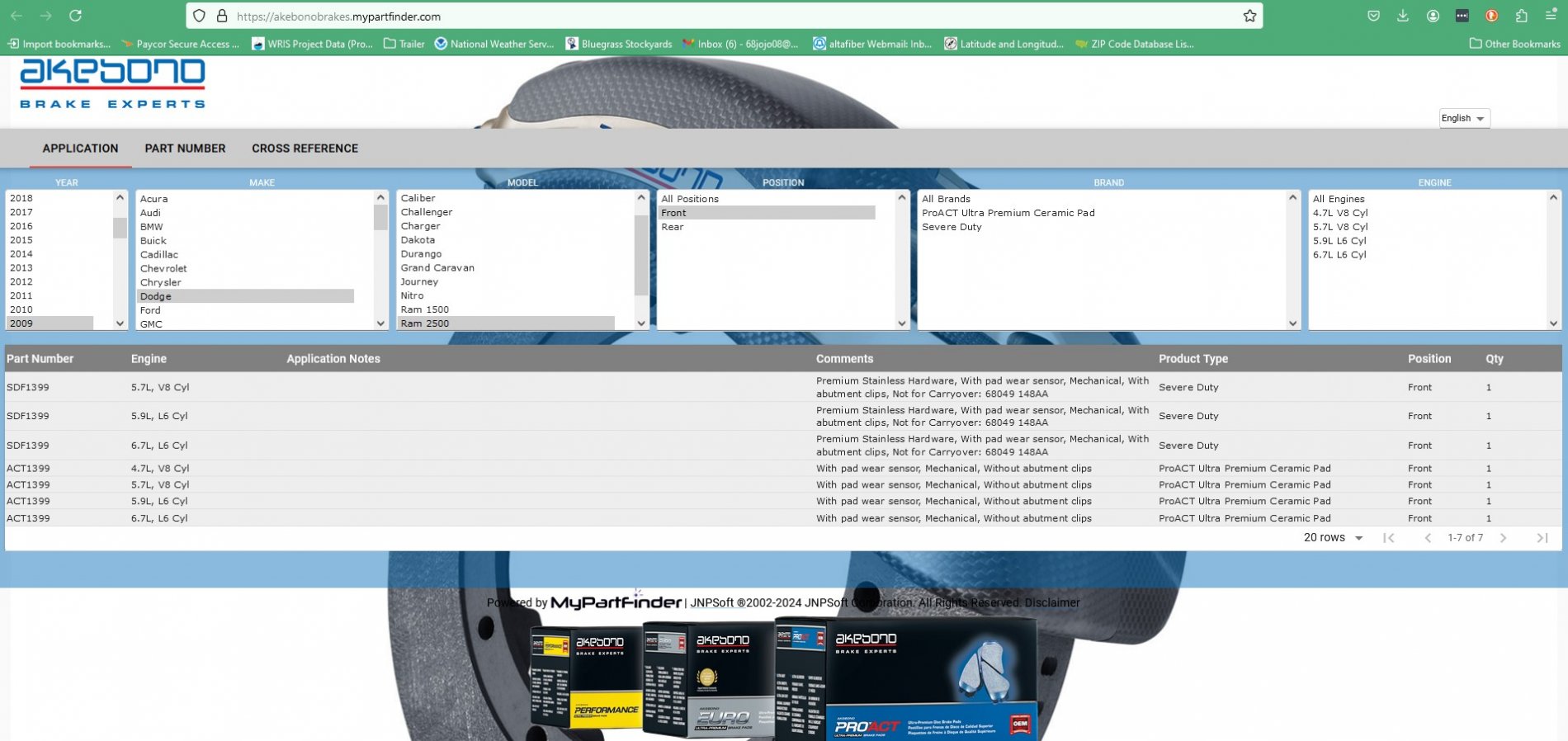

Does this sound reasonable? I've had good service from the originals and the rotors are in great shape. I will get them resurfaced anyway.
