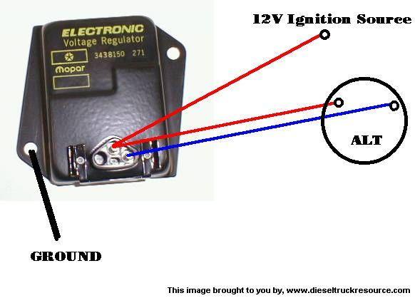

Tach's working OK. I ordered the Denso rebuild kit from Geno's. If it turns out to be the regulator, has anyone any experience with the internal regulator kit LarryB's offers or is the add-on external regulator the best way to go?
External is easy to do. I did this to get by when my PCM when out and was waiting for a new one.
Get a generic version of this from any auto parts place.
