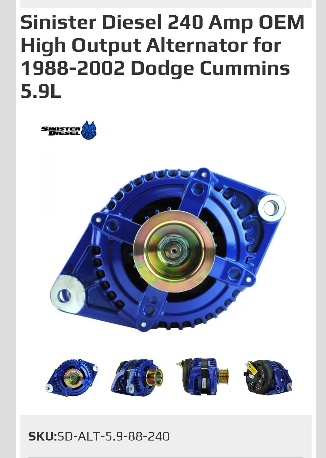

Anyone ever run one of these? I'm having electrical issues and I'm wanting to replace my alternator with one with higher output. I'm hoping that this will help with the ac noise and give me better output in the colder climates. I can only get reman ac delco out here with factory output.

When you compare apples to apples, the Sinister 240 amp alternator and cable kit are actually cheaper when you consider all that you get, at least in my opinion. When my alternator needs to be repaired/replaced, I will probably go that way or something very similar. Those intake grid heaters can be hard on batteries and alternators over time. I use my engine block heater judiciously when making cold starts to avoid those kind of loads.

I don't have an option to plug in most of the time, but I also just installed the BD Diesel high idle kit. With my VHF and other electronics installed I am always running a high load.... I'm debating on installing another 2 batteries after I upgrade the alternator. Thoughts?
"Another 2"? As in, you'll have 4 batteries? Or do you mean 2 new?
Can't imagine where "another 2" could be placed, or what doing that would be of benefit? Once fired up the alternator provides charge so I'd think high amp alternator would be the route to go. My buddy's work just got him a 450 stupid duty diesel and it has 2 alternators...
Are you using your "VHF and other electronics" while your engine is shut off? If not, I don't see any value in having additional batteries. Once the engine is running, the alternator carries the load (as @Joe Mc mentions).

I'm going to be installing an espar cabin heating... And yes, the vhf and such are used while engine is off sometimes.
