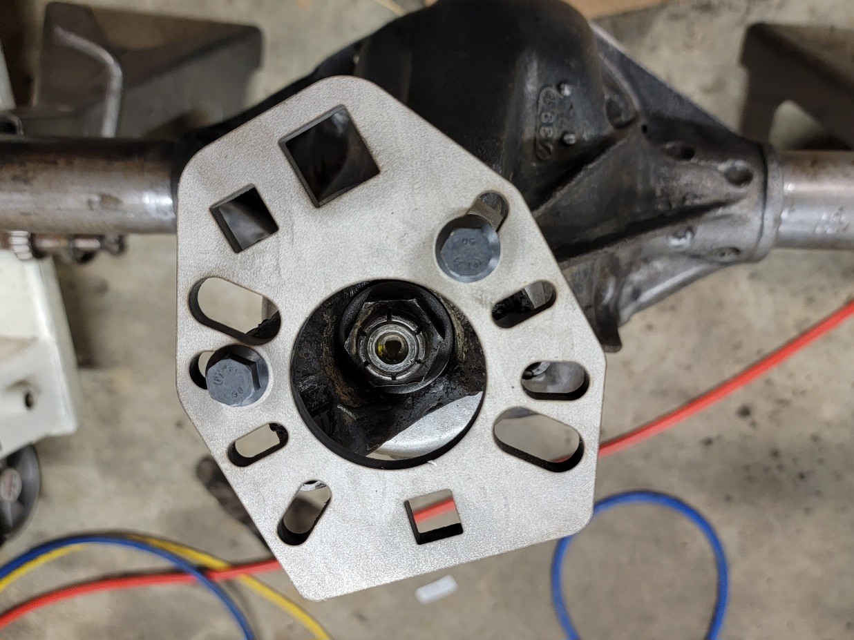

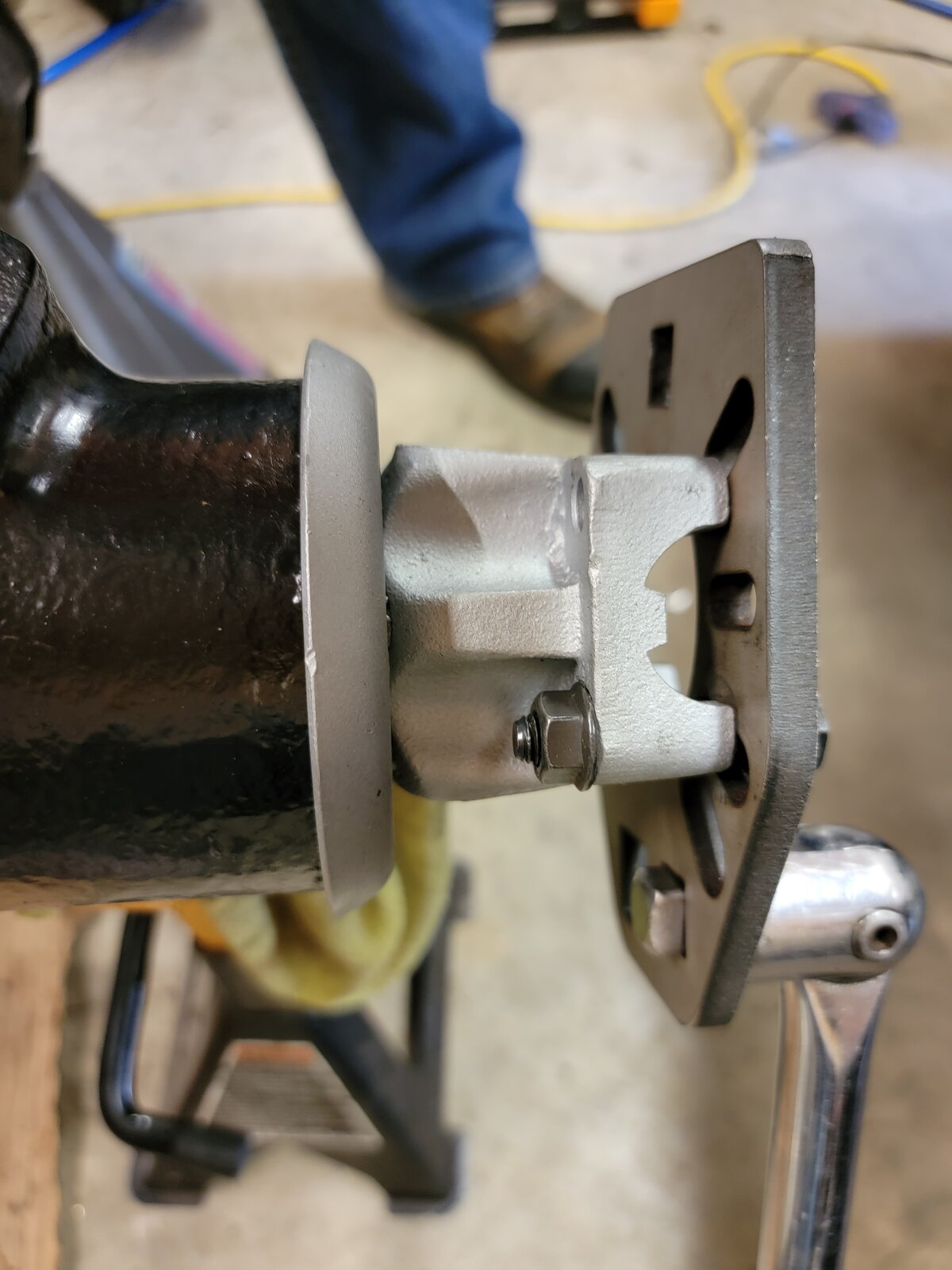

This little deal off Amazon worked great for holding the yoke of my Dana 44 recently. It's got all sorts of slots for different yokes, was like $16.
