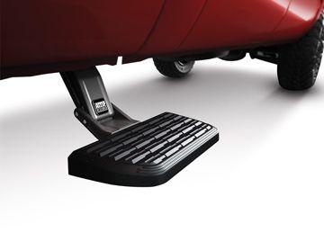

By chance has anyone installed an Amp BedStep2 (part number 75406-01A) on the side(s) of a 2014 3500 crew cab dually?
I've seen several websites indicating this kit will indeed fit the 2014 when used along with adapter 75611-01A, but Amp's website is less than clear about it.

Unless this is a model they just released, no it will not fit. I purchased one a while back along with the adapter and absolutely could not figure out how to install per the instructions. I called Amp research and they told me it WILL NOT fit a 2013 Ram Dually. They said some of their resellers have them listed improperly because they weren't aware of the frame change which also changed the mounting points of the bed. The step is supposed to mount to a rail on the bed that isn't even there.

It's the DRW fender that prevents the side bed step from working. The step doesn't extend far enough out to be usable.
My Dad installed one on his 20121 Dually. He sent it back. it's right near the front of the bed so it is useless for hitching and net easy to get into the toolbox.

I had gotten Dutch the AMP rear & side step for our 2014 Ram Dually 3500 for Christmas. It is amazing how much highter the 2014 is than our beloved 1996! The rear was OK but the side step didn't work. We spoke to AMP on several occasions and they told us the reason they couldn't get the side step finished was because they had no 2014 truck to use. We offered our truck and they said to bring it to them. We spent a day and a half there. That was April 1st 2014. They made a prototype on our truck and installed it on the driver side. That step sure helps lock the hitch bar in place and easily reach items down in the bed. They were not going to make the one for the passenger side at that time but were working on it. We received a phone call last week that they had our passenger side step ready to ship so I gave them our current address. It should be here Thursday evening and I'll post again once Dutch has installed it.

We still like our DeBoe rear slide step much better than the AMP but there again, DeBoe hasn't finalized the model that will fit the higher sitting 2014 Ram Dually. They tell us in the next few months. The rear AMP step for Dutch just isn't as steady as the DeBoe and he likes being able to step up and down from the rear of the tailgate instead of off to the hard to see side where AMP is mounted. Hugs, Di
The one they made for our drivers side is just in front of the dually so we can both reach the hitch bar. Don't have a tool box so not sure about that issue. Hugs, Di
