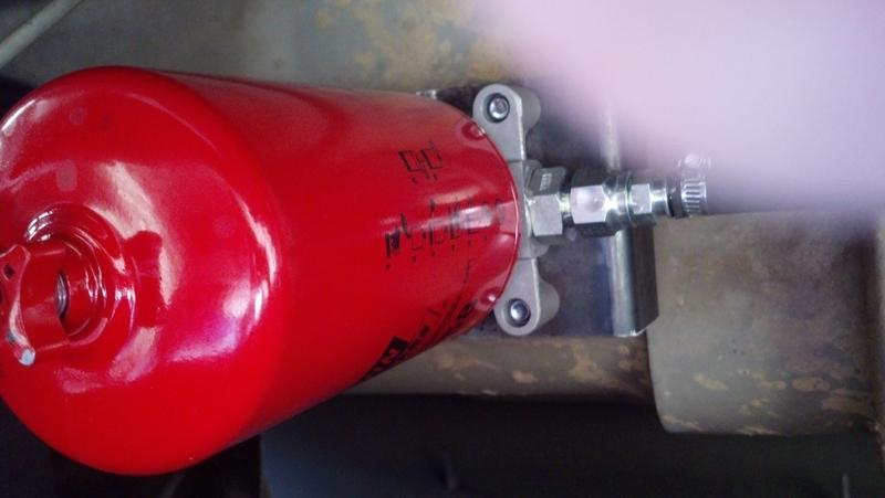

Dan, CBlack did his homework on how to put two 4-port remote bases in tandem, although having to offset them, and thereby utilizing both a fuel filter and a water separator. However, due to space limitations where I wanted to mount all of this just forward of the wheel well, I needed a smaller footprint with horizontal mounting. I elected to mount the base on a 4" long piece of 2"X6" rectangular tubing and then mount that to the bottom of the truck bed.

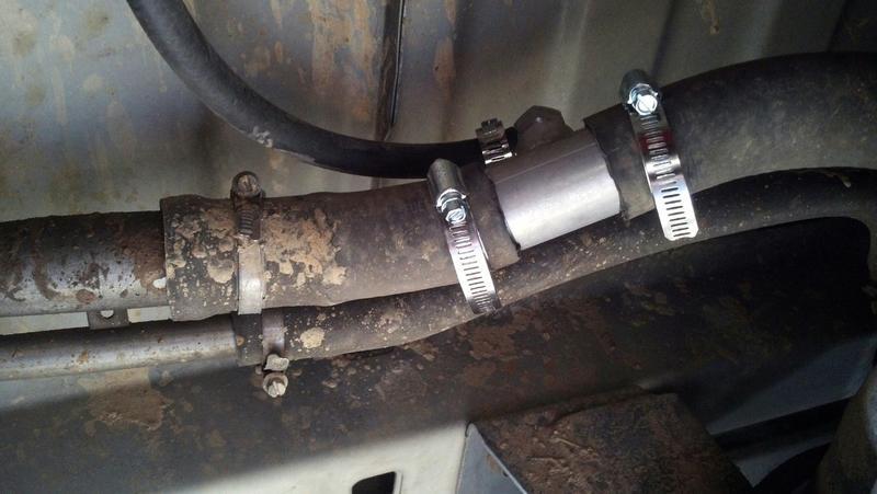

The Shotz System is very similar to the system offered by Northern Tool.

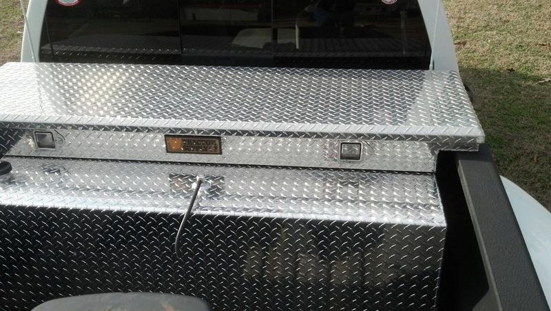

The ATI AUX46 tank fit in the truck bed behind the tool box like a glove. The tool box had a 2" lip about 17" from the truck bed. The tank measured 57"X12"X16.5" (LXWXH) and fit just under the lip.

I should also hasten to add that I contacted Baldwin Filter's 'hotline' and took the recommendations of their representative on the correct filter/water-separator to use with the FB-1311 base. I did find out that the base requires 3/8-16 bracket bolts and the inlet and outlet are 7/8"-14UNF threads. These necessitated the use of hydralic fittings at these locations rather than just standard hardware store brass reducers, etc. The FB-1311 is a standard Cummins engine fuel filter mount and everything went together pretty well once I got my wife to help me. LOL

No, if I remember correctly I took my trusty little hacksaw from Harbor Freight and a utility knife to it without removing it.
I have since learned the hard way since installing the transfer system that it is difficult to get a good seal on the OEM fill cap if I ever fill my OEM tank and break the seal. Consequently I only fill the auxiliary tank.
